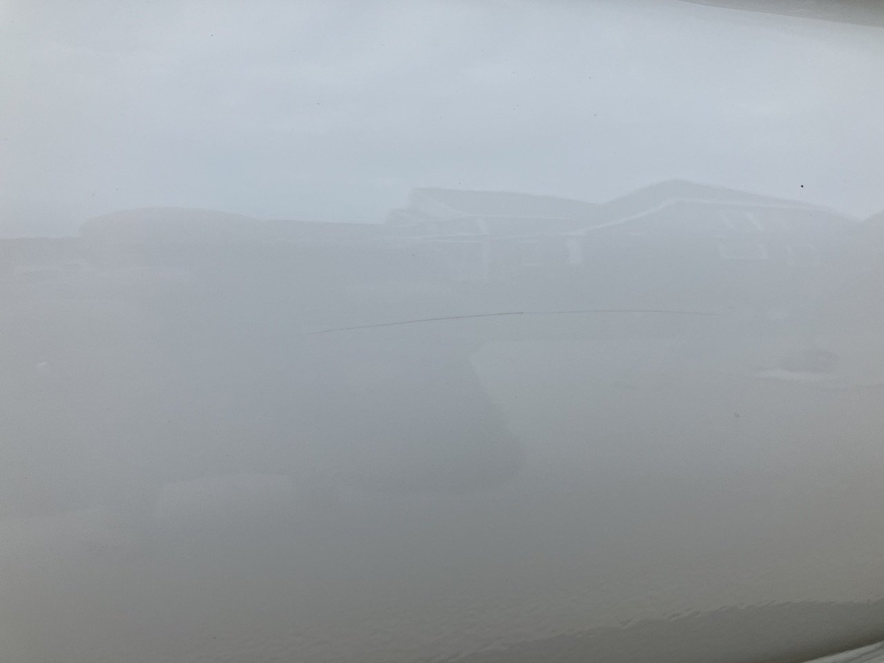

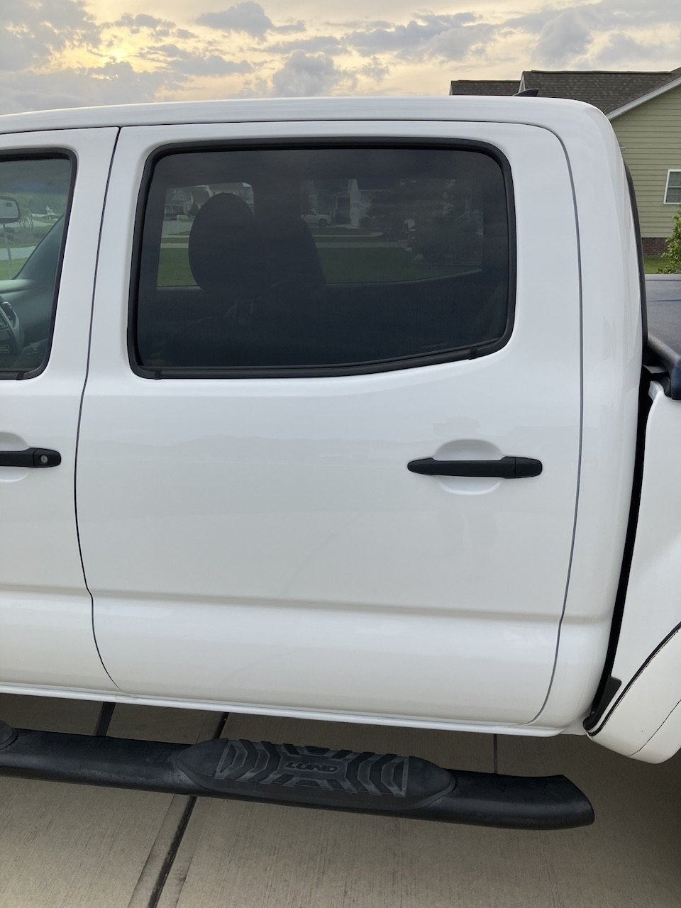

    Door repaint complete, looks great.
    However…they elected to only repaint down to the body line just above the rock guard, because the rock guard can sometimes be difficult. They then clear coated the entire door. Unfortunately there was a light scratch just below where they stopped the repaint, and now there’s clear coat over it. The shop offered to fix it, which would probably require a repaint. It’s completely aesthetic and difficult to notice unless you’re looking for it. Thoughts?
