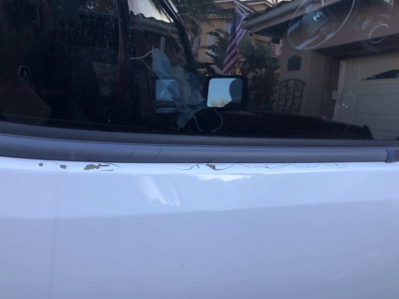

  12. Mar 5, 2021 at 4:51 PM
    #52
    Simpleton
    Simpleton Well-Known Member
    Jan 16, 2017
    #207801
    743
    Orange County
    2017 DCSBOR
    None as of yet
    Adding myself to the list.
    Found this morning. It was not there two weeks ago.071A897D-1605-4173-AEB7-5A70AA123434.jpg
    tacobbq and shakerhood like this.
  13. Mar 5, 2021 at 5:17 PM
    #53
    Sugar Silva
    Sugar Silva Well-Known Member
    Mar 21, 2014
    #125848
    1,446
    Dave
    San Diego, CA
    16 Toyota Land Cruiser
    Kings Sliders TRD Rock Warrior Wheels Tint
    Weak sauce

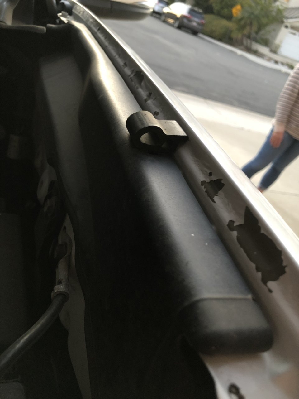

  16. Mar 9, 2021 at 10:12 AM
    #56
    Simpleton
    Jan 16, 2017
    #207801
    743
    Orange County
    2017 DCSBOR
    None as of yet
    It's a 2017.
    Found it on the other rear door and under the hood too
  17. Mar 9, 2021 at 10:22 AM
    #57
    6MTPro
    6MTPro [OP] Well-Known Member
    Apr 22, 2019
    #290940
    1,473
    HI -> CA
    2018 TRD Pro 6MT | 2004 4Runner 4.7 V8
    Tune, 285/75/16, Diode Dynamics, PPF, Bakflip Mx4, Meso, Cali Raised, TJM
    Yup that sounds about right from what we've seen on here. Does your VIN start with a 3 or 5?
  18. Mar 9, 2021 at 11:58 AM
    #58
    Simpleton
    Jan 16, 2017
    #207801
    743
    Orange County
    2017 DCSBOR
    None as of yet
    It's a 3 and I know that means its from baja. It's not a plant issue though. They have a customer support program that started a year and a half ago for a host of models painted from 2007-2018 with super white that are having the same paint failure. The tacoma is not on the list. But It includes camry, corolla, 4runners, avaolns and rav4's.
