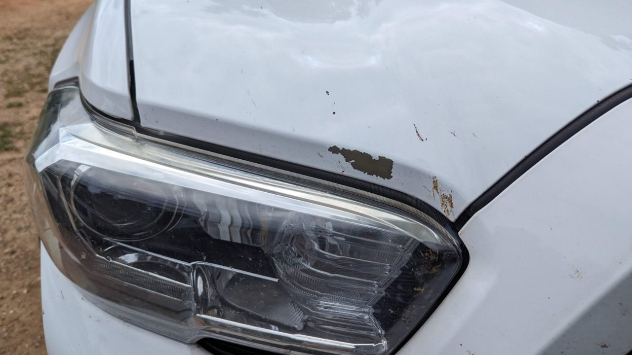

    I have a question regarding my 06 Tacoma white paint flaking (sorry if I am not posting this in the correct manner) I've got several areas on my hood, some as large as a dime, most smaller areas of flaking. The gray undercoat is what shows. Question: How can I backfill these areas of missing paint to then try spraying with paint so hopefully it will look better?
    Bondo? If not, what other kind of filler? Something on Amazon?

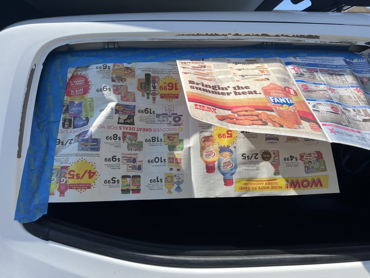

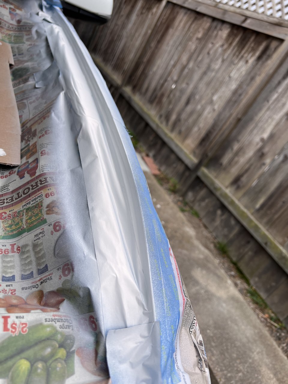

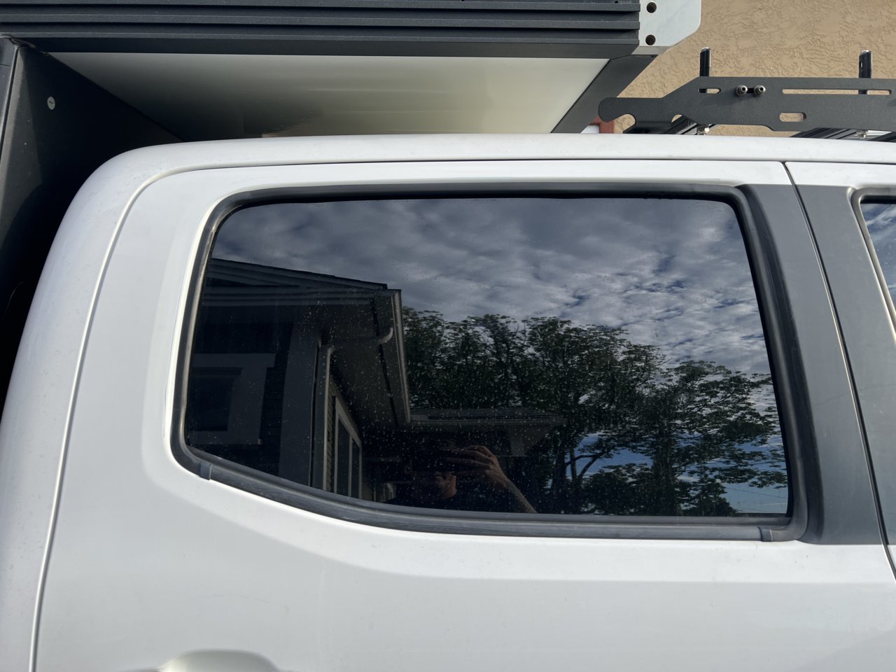

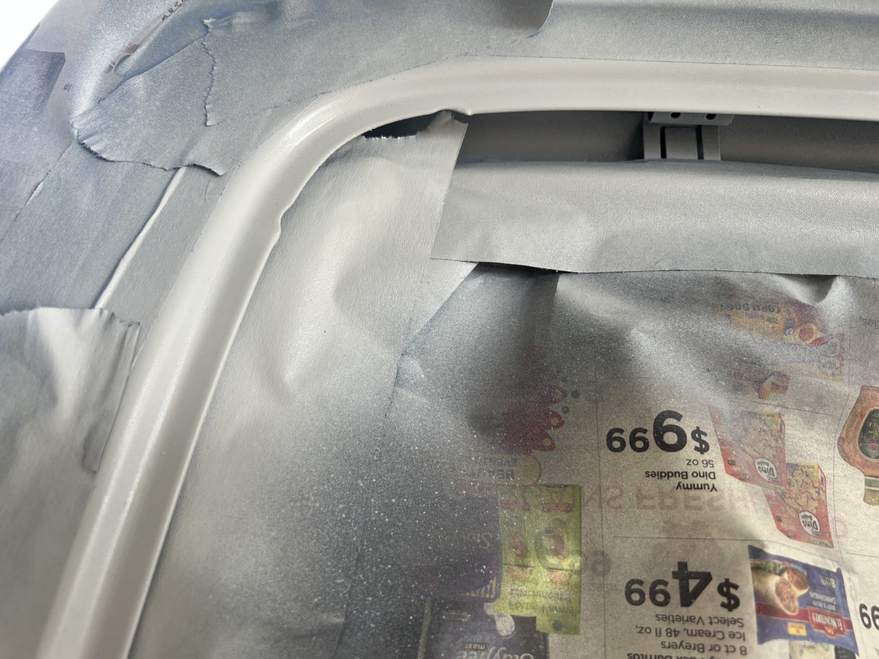

    My wife's 2017 has had the paint falling off in the usual spots and like many of you I was pretty fed up with it. Her truck is def not a show truck so take all this with that in mind. We park her truck in a spot that ends up being right out our side porch door so I see the paint falling off daily and recently decided to just take matters in my own (not very capable) hands. First I purchased paint from "American Touch Up" (because buy American made -hey I'm originally from New Zealand and I know buying local is the best way to spark the economy) https://americantouchup.com/product/automotive-spray-paint-primer-basecoat-clearcoat/
    https://www.amazon.com/American-Tou...+touch+up+paint+040+super+whit,aps,176&sr=8-6
    I decided to start on the Drivers side fender as it's the most hidden and would allow me some time to figure it out a bit. Sanded - taped and then followed-ish the directions on the can's. What I wasn't prepared for with this is when I removed the painters tape it tore off more paint...on the fender, a part that would be seen. Also during this time our weather turned to 'cr@p' (San Diego in May) and got chilly and drizzled.. the end result was a hasty finish that left the clear coat a slight off tint. Barley noticeable unless you knew to look thou.
    Yesterday I decided to tackle Passenger side rear door, I'm doing one at a time to try to learn as much as I can - this went well enough although the skies also 'spat some water from the gods' and I need to alter my tape lines as its left a faint 'primer line' on the edge (ill fix it later) but again the end result is a million times better than the peeling paint.
    For $60 odd dollars and a bit of time this will make me feel a whole lot better about the looks of her truck -
