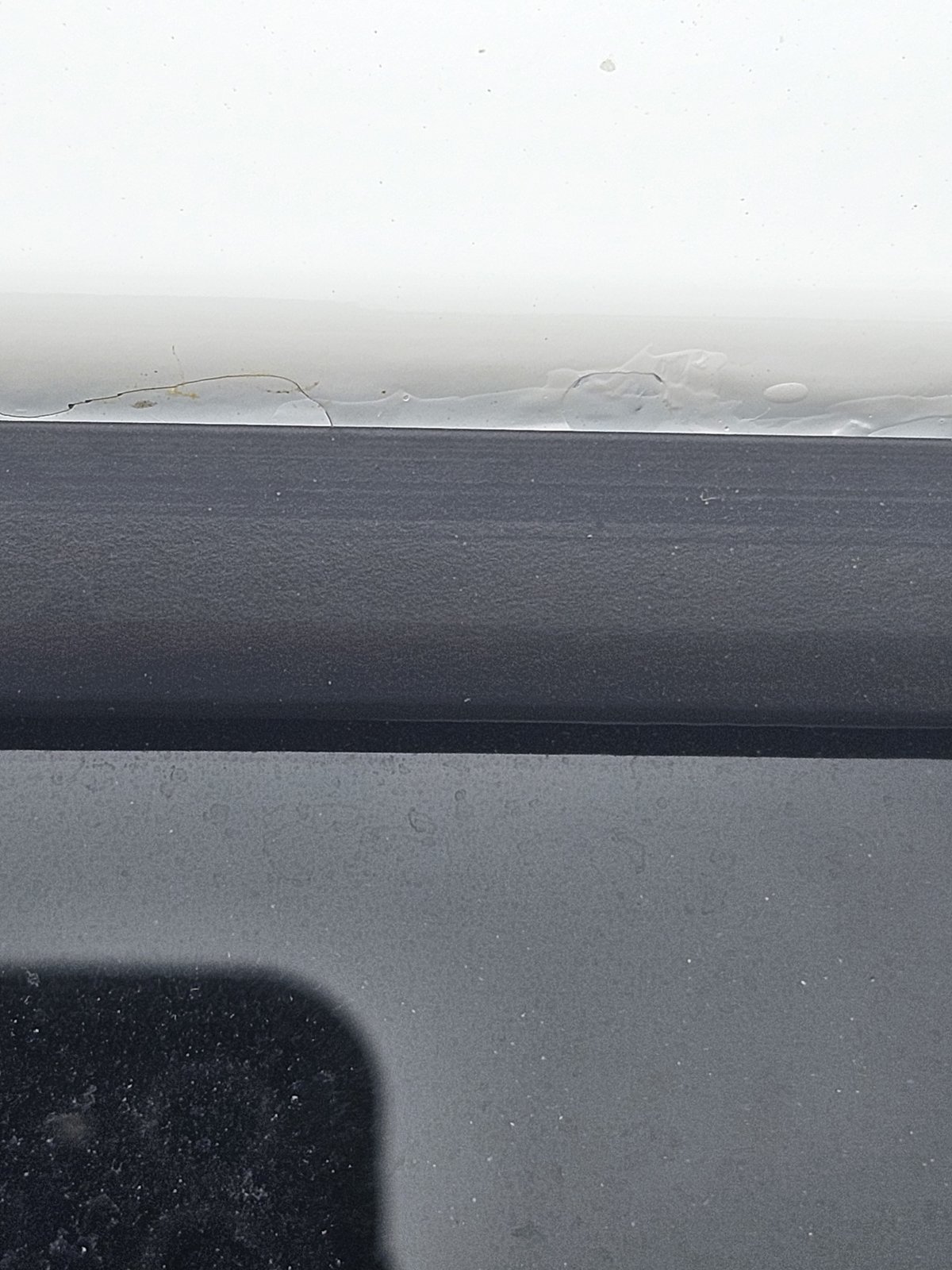

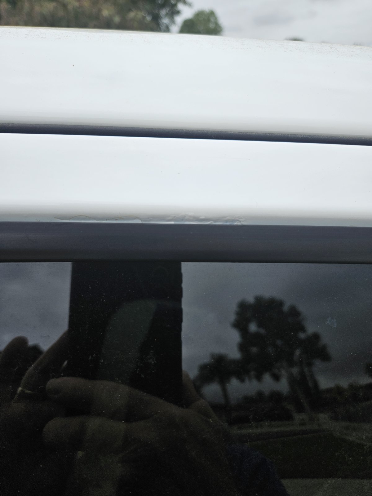

    I recently washed my white 2021 Tacoma and sadly I saw a pea sized spot above the driver side rear door missing paint and some bubbles next to it. 3 years old with 14k miles. Called Toyota Care # and told the no help/recalls available. Now I am unhappy with my truck that I was going to keep. It was my retirement gift to myself. I figure the spot is going to spread. I put some touch up paint to hide. My first white vehicle and this happens.20231025_102019.jpg 20231025_102027.jpg

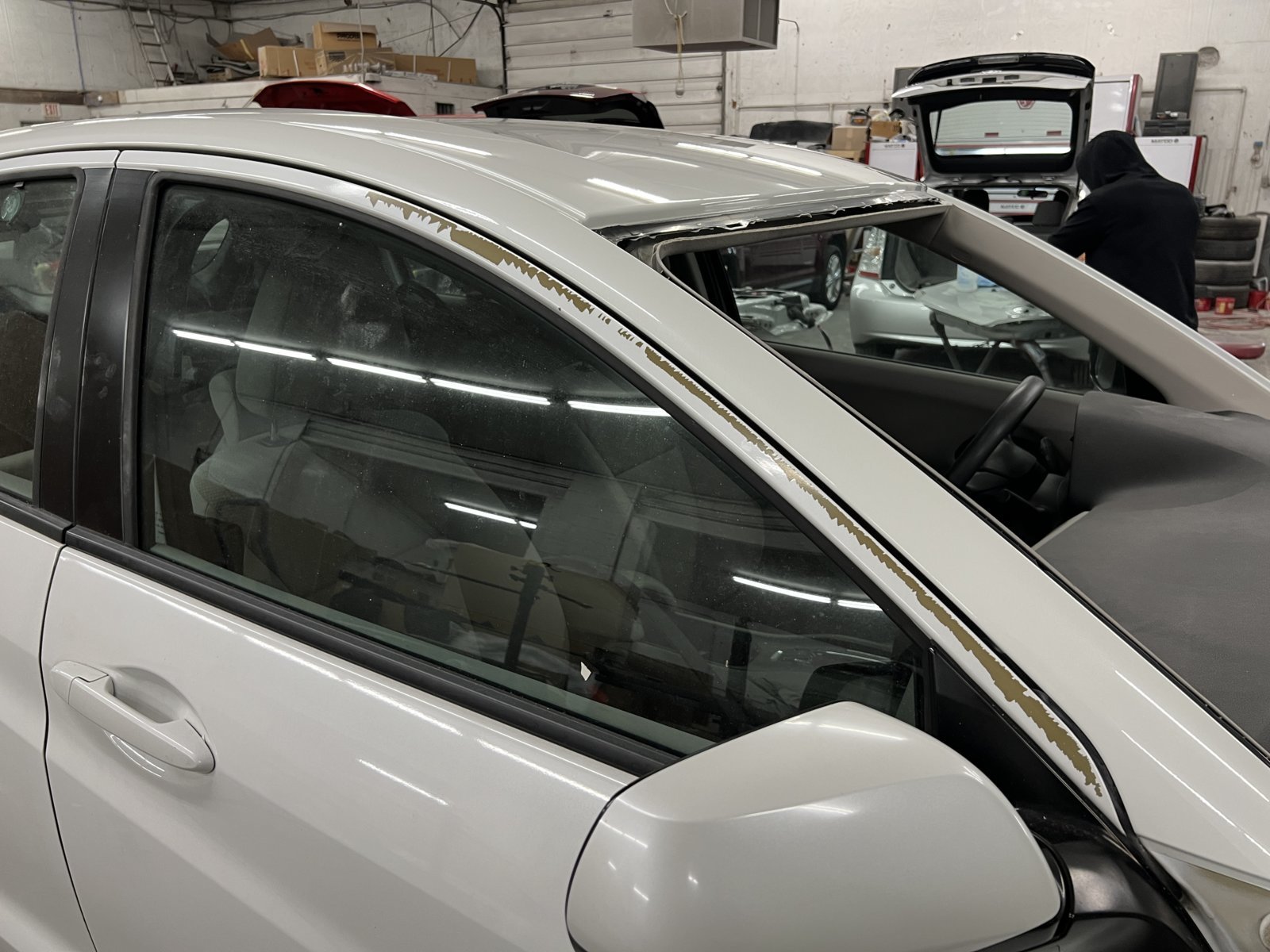

    Even if Ice Cap was different than Super White, it wouldn’t fix the issue. The issue is the e-coat (primer). And it’s not just Toyotas. I’ve painted probably 50 peeling pearl white Hyundais, and multiple Hondas. It’s the same issue GM had in the 90s with Olympic White. The paint isn’t adhering to the e-coat.
    Also, the only CORRECT way to fix them is to strip the entire truck to bare metal and start over completely, which I would say almost no shops are actually doing.

    I wonder what causes that bond to break. What's different when you re-paint the Hyundai's and the Honda's so they don't fail again?

    Could be numerous things. Time between primer and paint being applied, white being more prone to UV damage, or a pigment in the color itself not being compatible with the primer. Hopefully the manufacturers get it figured out though, because I’m tired of working on them lol.
    We strip the effected areas to bare metal, epoxy primer, then paint.
    This is a Honda I did the roof and pillars on last week, which then peeled one of the doors while untaping.

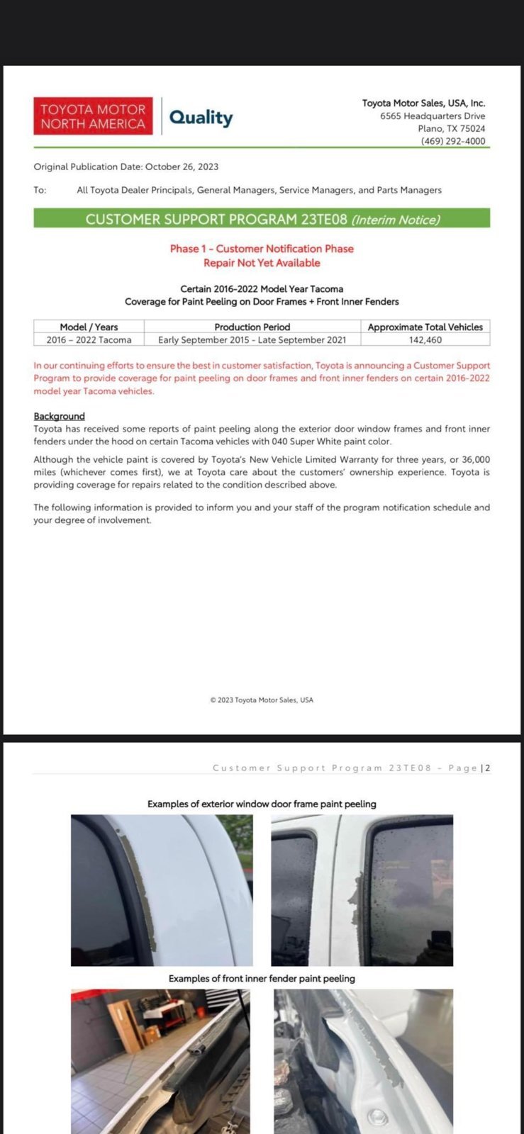

    Updates!!!

    Looks like this issue has finally hit the threshold for action. Great News!

    “ Toyota has received some reports” who f’ed around and JUST Told Toyota about issues with white paint on Tacomas. :rofl:

    I wonder why the production date cutoff was September 2021. Did Toyota change something afterward? My truck was produced October 2021 and I don't know if that's good or bad.
