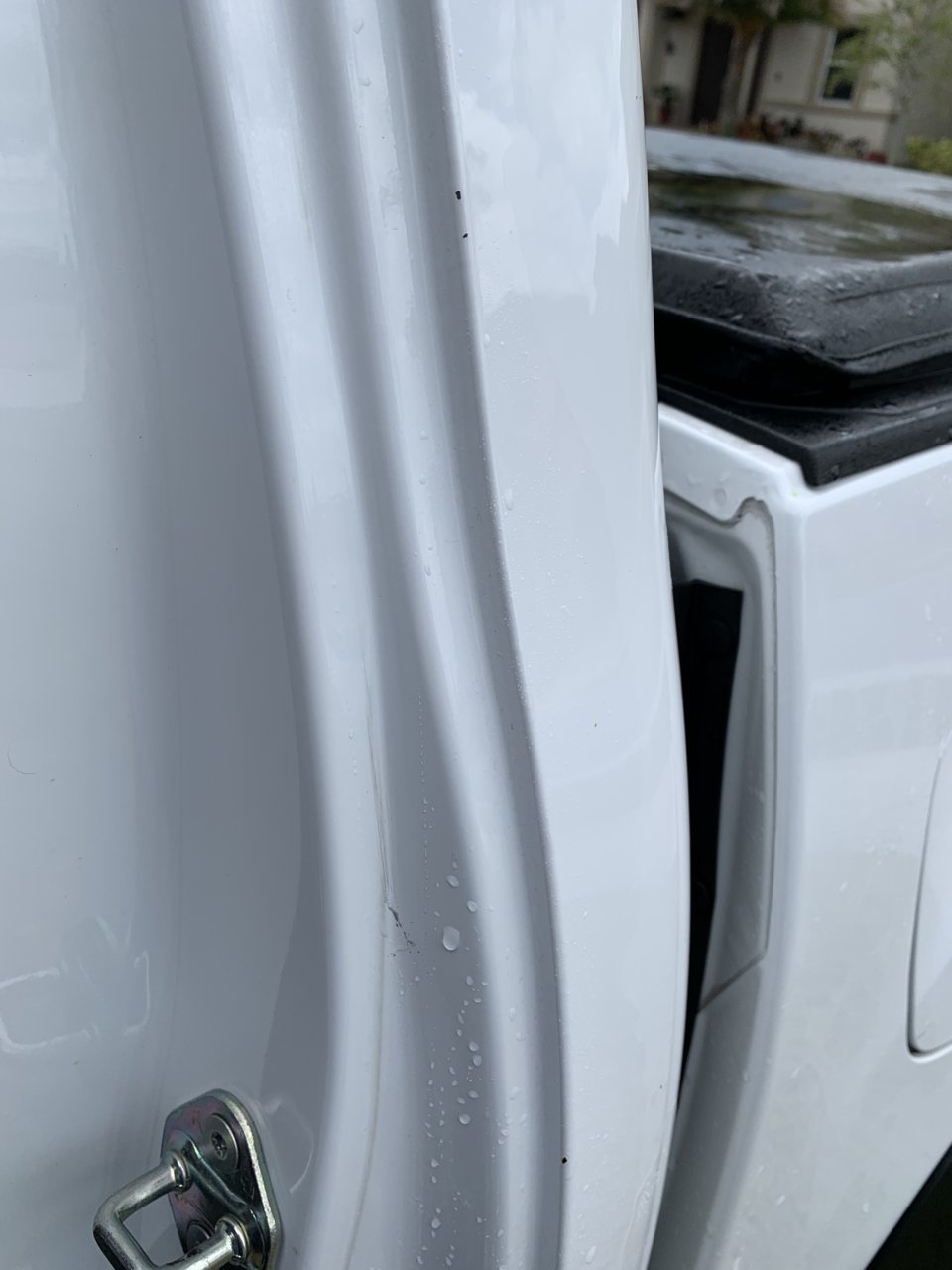

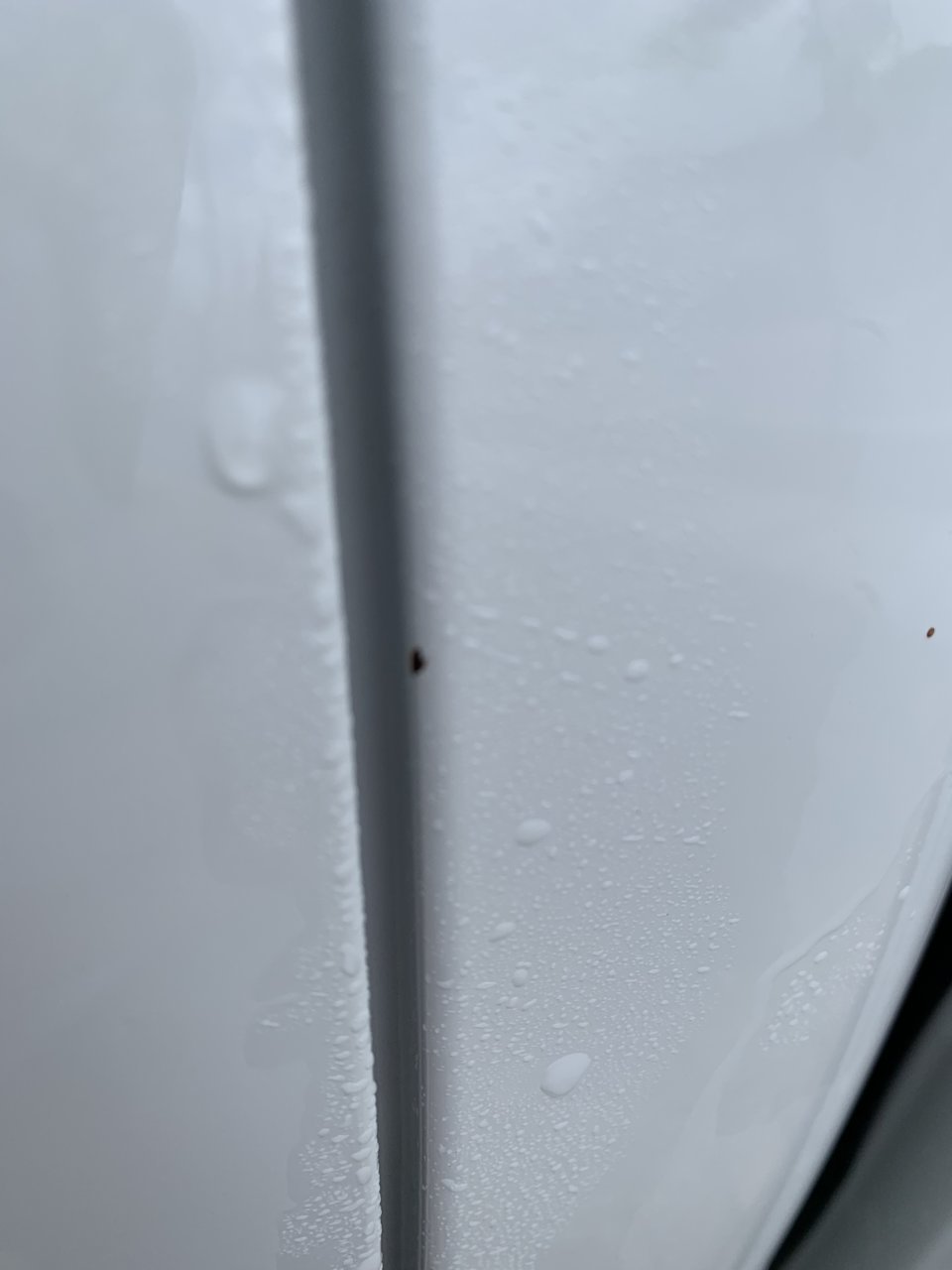

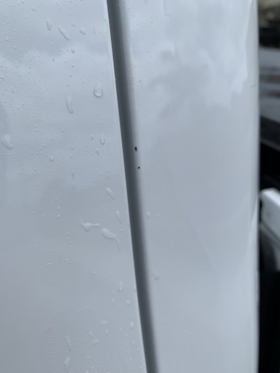

    2019 taco. Normal wear and tear or start of something bad?
  13. May 1, 2021 at 11:04 AM
    #73
    Hooper89
    Hooper89 Well-Known Member
    Sep 13, 2019
    #305186
    1,577
    2016 White TRD Sport
    Keep a close eye on it.
  14. May 3, 2021 at 6:52 AM
    #74
    Roll_Terps
    Roll_Terps Well-Known Member
    Dec 4, 2016
    #204017
    544
    Maryland
    2017 SR DCSB White
    I have one spot like that on my 2017 super white on rear driver door, but its stayed the same for roughly 2 years. I think its normal wear, but definitely keep an eye on and have the service center note it the next time you have it at the dealer.
    FL_TRDOR[QUOTED] likes this.

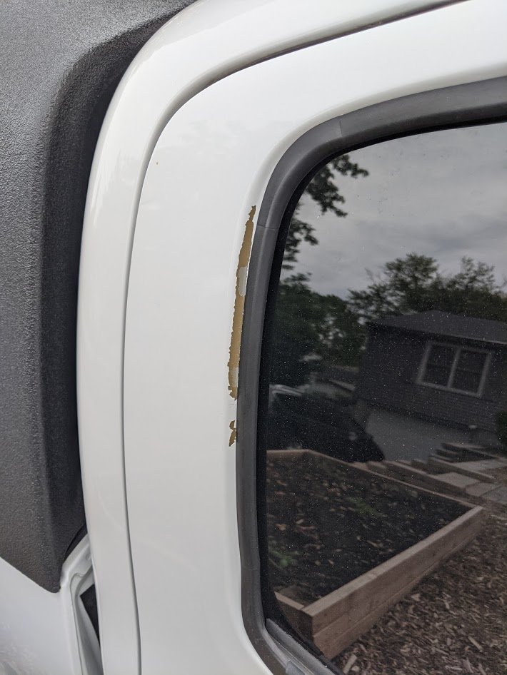

    Just noticed this on my 2017 on the weekend. Called East Madison Toyota on Monday 5/17, service desk said they would talk to the service manager and get back to me. They didn't.
    I called Smart Toyota (also in Madison, just further away from me) on Wed 5/19. They said bring it by their body shop, which is Ball Body Shop I did. Cim the manager there checked it out and wrote me a quote for $644 and said he would reach out to Toyota to see if they would cover it. He was aware of two service issues related to this, one being Toyota white paint peeling, the other being 3rd gen Tacomas peeling around the windows like this.
    Ball Body shop just called and said Toyota was covering it and to bring it in on Monday to get painted.
