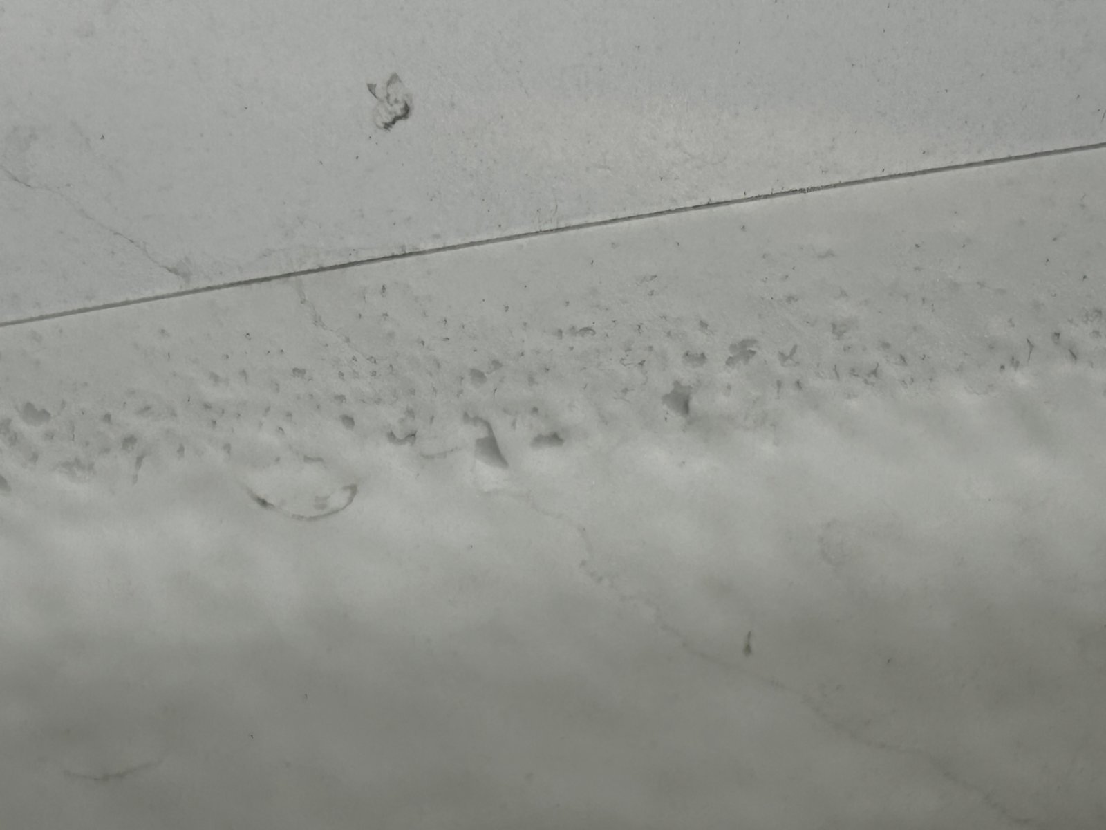

    SH10151
    SH10151 Farang
    Apr 10, 2018
    #250059
    3,187
    SF Bay Area
    2022 SR AC UP 4x4
    2022 SR model. This is the driver’s side behind the rear wheel well where the plastic rock chip shield is glued over the paint.
    Dealership didn’t think this was too concerning.
    For those of you wondering what’s going on, that’s the gray primer underneath the paint that they just slapped the sticker over.

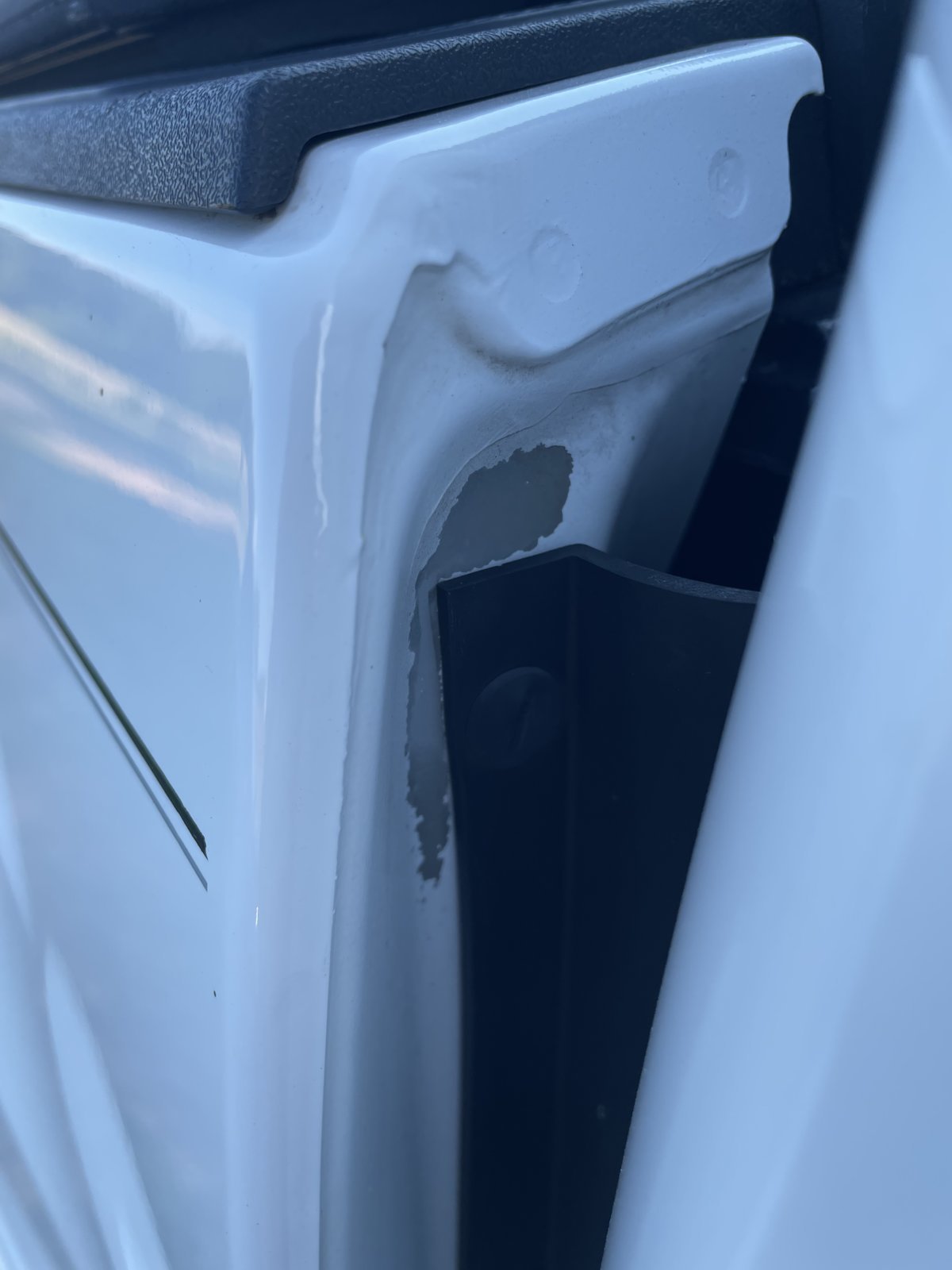

    Exfordman
    Exfordman Well-Known Member
    Sep 25, 2020
    #341875
    70
    Norman
    2021 Tacoma TRD OR 4X4 LB White
    None
    20240418_110901[1].jpg Now I have a third door that's started to have paint fall off. I can't wait for the last door to start. I talked to the paint shop that my Toyota Dealer uses for other model paint repair programs. They said they take the panels down to bare metal and repaint. They also said they wish Toyota paid them more for the repair process. I worry about the paint on the rest of these trucks. Why is the issue only on certain areas?

    Sandman614
    Oct 26, 2010
    #45273
    35,899
    Tim
    Garner, NC/Boone, NC
    '06 SR5 Off Road
    Possibly the leading and trailing edges of panels where more turbulent air and abrasive particles are present? Combined with the lack of adhesion.

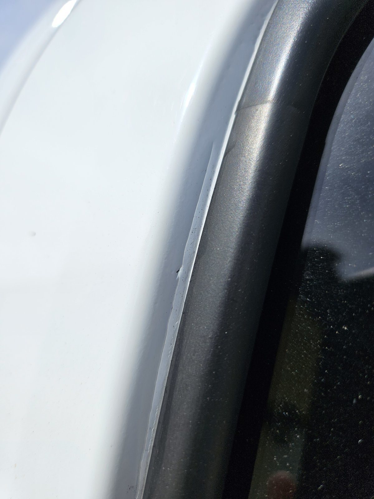

    tpgillikin3
    tpgillikin3 Well-Known Member
    Feb 8, 2021
    #355463
    64
    Timothy
    Beaufort, NC
    2017 Super White TRD Off-Road DCSB 4x4
    Camper Shell, Decked System
    Anybody heard anything recently? The upper window border on both of my rear doors has started peeling and I can’t imagine it will stop there. I’ve actually seen a couple other peeling trucks in town and the owners had no idea it was a common issue. I made sure to encourage them to bug Toyota about it
