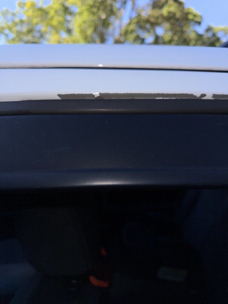

    I’d be interested to know if Toyota will cover areas of the bed that are peeling as well. Fortunately it’s a small area on mine, but has started spreading. It’s peeling just like the other areas they acknowledged, so I would expect them to cover this as well.

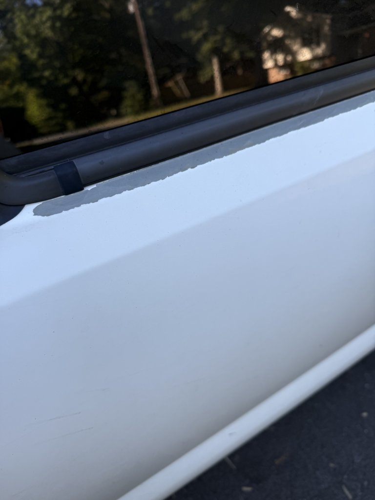

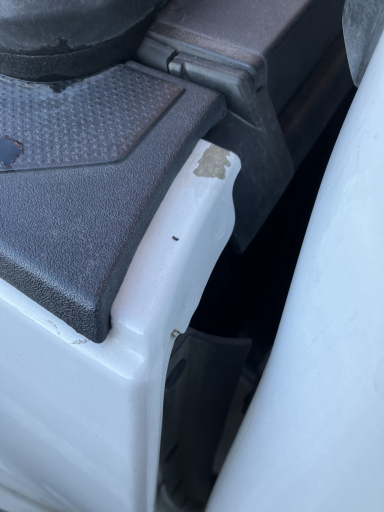

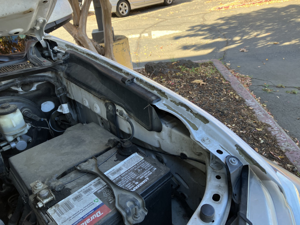

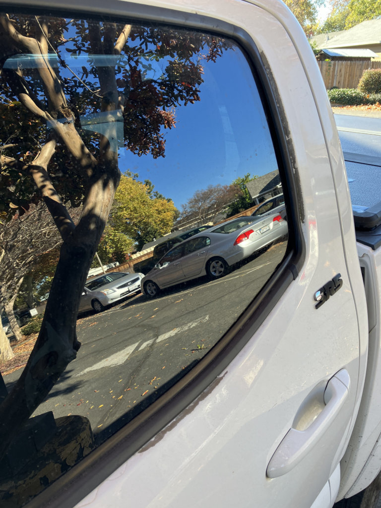

    Received the letter for one of our two 2017 work trucks last week. I noticed I got the letter directly instead of only it being sent to the official registered address for our company that owns it; my guess being because I took it in last year and had it photo inspected and documented previously at a Toyota Collision Center for this exact issue. Have another appointment for this week to bring it in again, hopefully the previous documentation visit helps show how much worse it's gotten since then.
    I think I had photos of the truck already in this thread before back in late 2023, but the issue has definitely gotten worse since then
    Door window sills and back edges are the most obvious places, which already showed wear but the peeling continues to spread, albeit slowed down somewhat with me adding some clear coat touch up over affected areas. All four doors show one of both of these areas of peeling. Definitely per the areas of issue the letter describes.

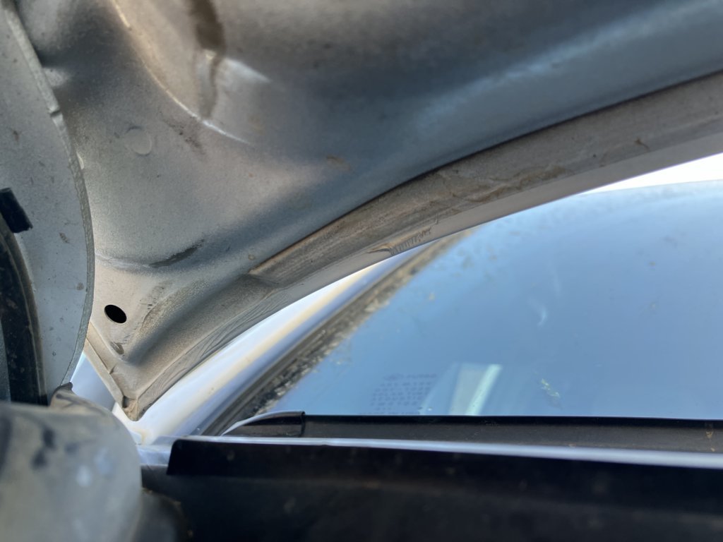

    Peeling also happening under the hood on the side pieces both sides. Definitely per the areas of issue the letter describes.

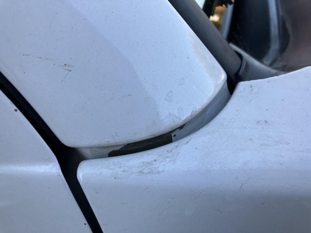

    New area of peeling has shown up on the cab behind the edges of the front fender panels near corners of the windscreen. Not sure if this is described by letter or not though since it's not in example photos it provides.

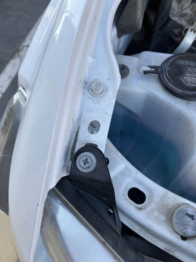

    Also peeling starting to show on front of the bedside panels. Pretty minor still but it's also showing here on our second work truck too.
    It's very minor and hard to see, but I'm pretty sure the two thinning spots like this underneath the windshield side of the hood are on the way to peeling soon, as this is what I initially saw in other areas as well before the visible peeling and flaking started in full.
