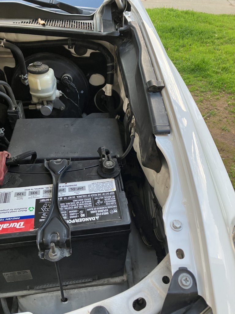

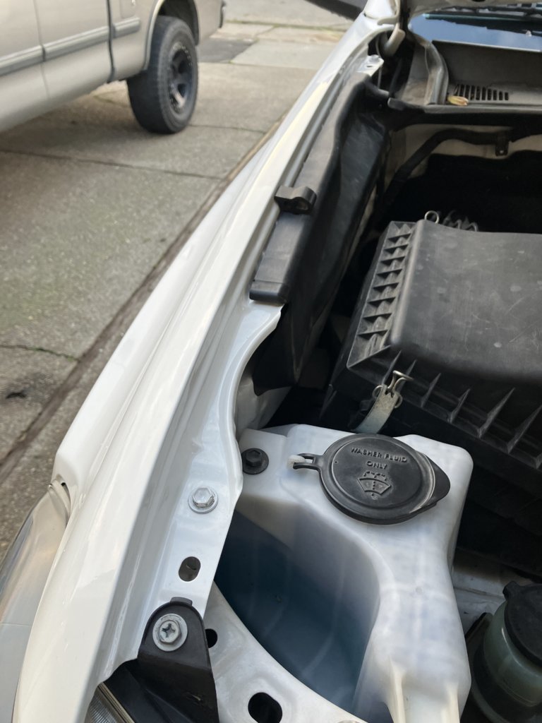

  19. Feb 19, 2025 at 5:57 PM
    #1159
    BTL Y-Wing
    BTL Y-Wing Well-Known Member
    Aug 14, 2021
    #374213
    275
    2020 Army Green TRD Pro
    Late January I finally got the work truck in for the repaint work. Came out pretty good and it's a noticeable improvement not having peeling on the sills anymore, but the collision center still did a good job blending the paint to match the existing paint panels (props to Folsom Lake Toyota Collision). Toyota Corporate didn't cover the peeling we documented on part of the bed front, cab lower a-pillars, or hood backside though, so the collision center told me to get them photos if it progresses and gets worse. They've seen several trucks like this but only a small number compared to cases with paint damage on the doors / front fenders only, so they are trying to get as many collected as they can to try to build a case with Toyota to expand the warranty coverage.
    A random bonus was that the shop also gave the truck a free set of emblem blackout overlays. I assume the black plastidip test I did on the badging was mistaken for a blackout package on the truck, and with the doors off only the really clean job I did on the tailgate badging that wasn't being repainted / wasn't peeling badly was left for them to reference.
    Downside is not that the paint is cleaned up I'm remembering all the small dents the truck has accumulated over time that the poor state of the paint was hiding (I remember where/how most of them happened).
    On the bigger downside, I completely forgot that repainting obviously involves removing all stickers and decals, and now will need to explain to my boss why the truck needs to go back to the decal/tint shop for new front door logos / lettering ahead of schedule.
