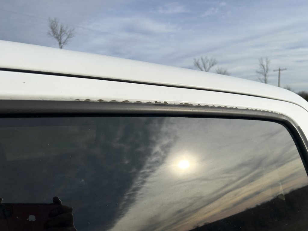

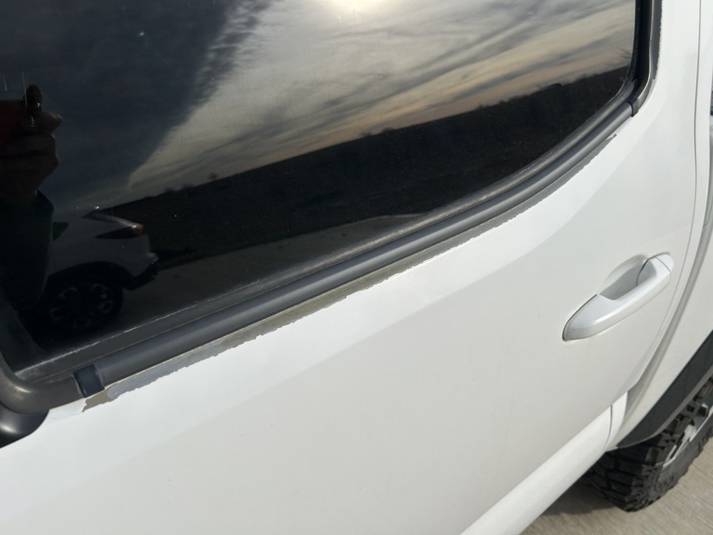

    Update #2: Less than three months after getting my truck back, paint is starting to peel around the top part of the driver side window. I set up an inspection at the dealer, and after seeing it they are taking it back in to get repainted. I also spoke with the service department at another dealership, and she said that they have had a few trucks with the same issue. Figured I would give everyone who has had the fix done a heads up to keep an eye on things.

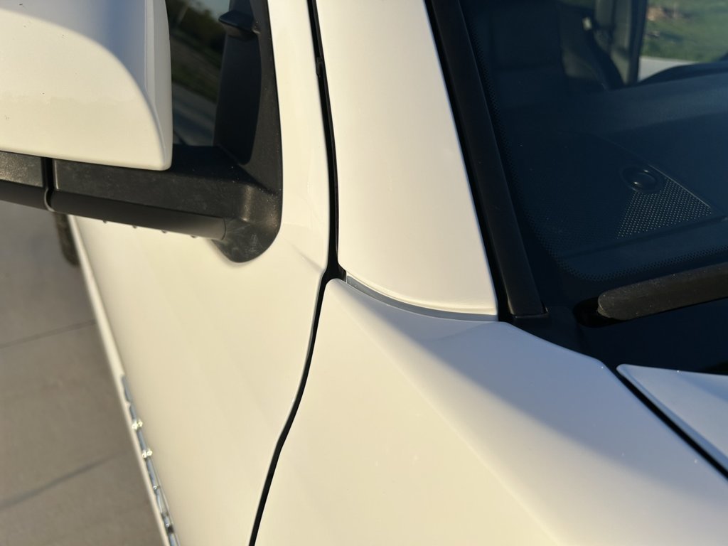

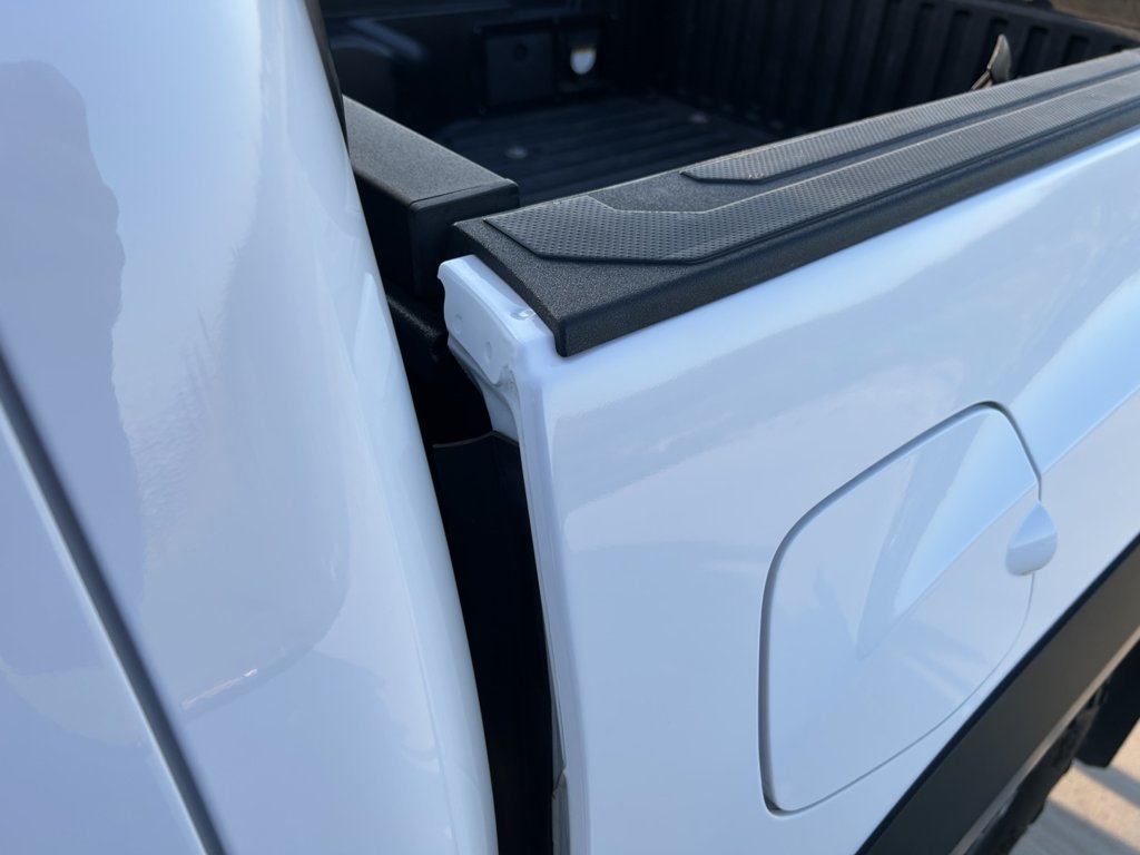

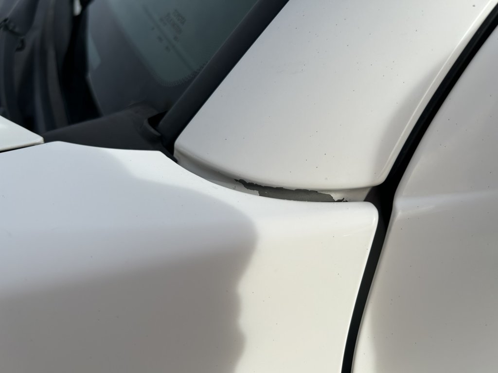

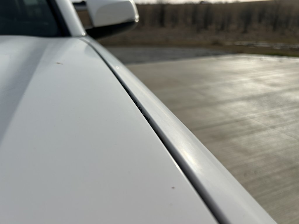

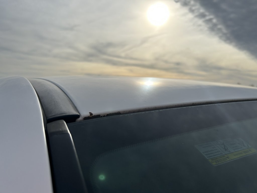

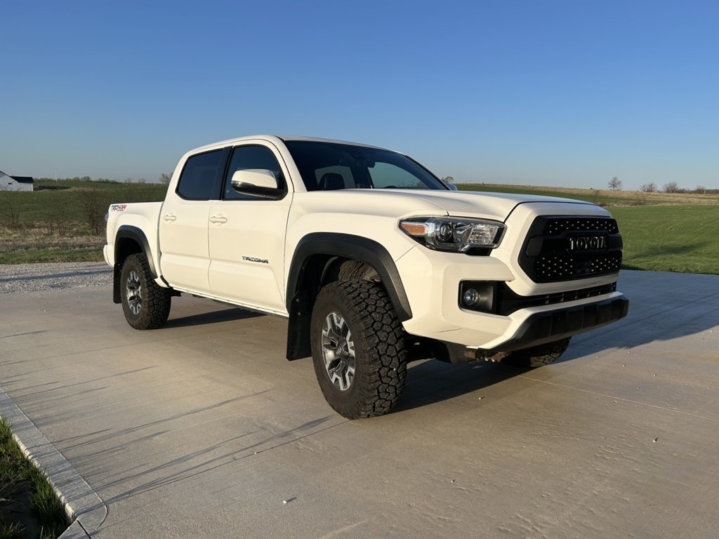

  6. Apr 11, 2025 at 9:36 AM
    #1186
    Genypig
    Genypig Well-Known Member
    Aug 29, 2018
    #264477
    279
    Yev
    2018 Tacoma TRD OR

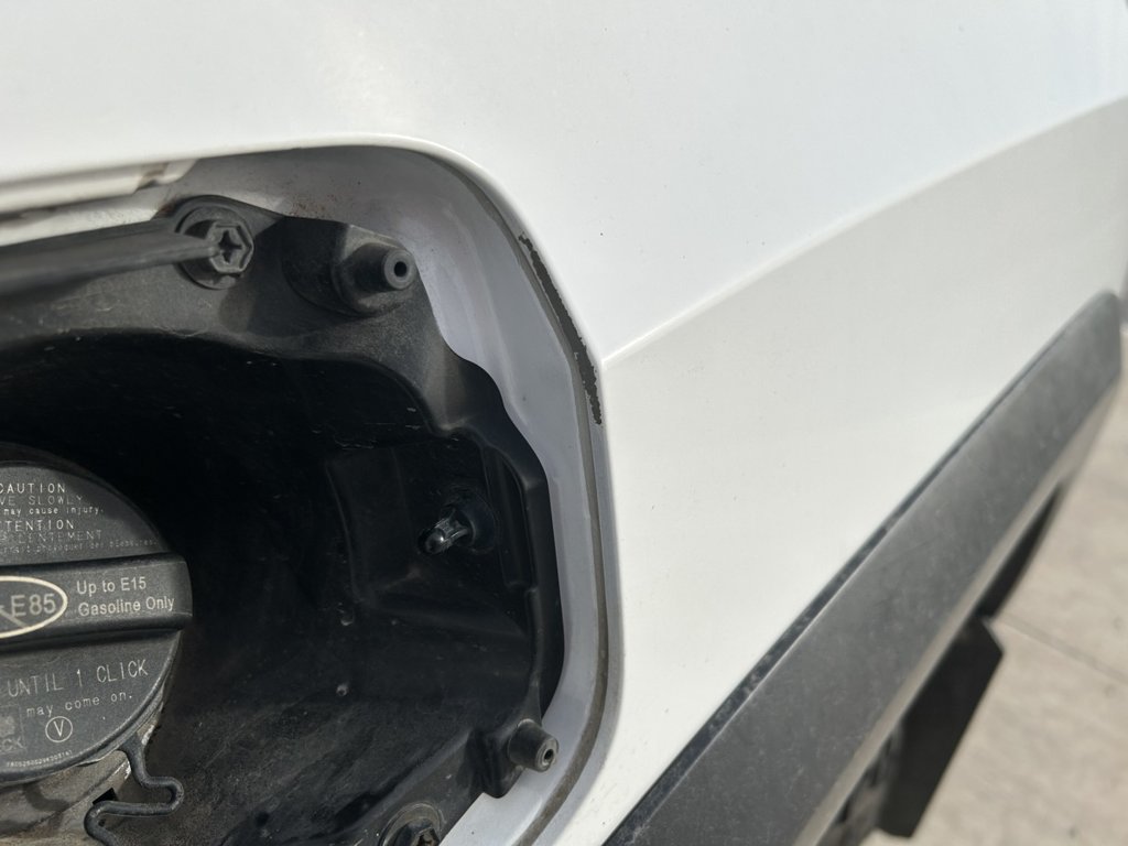

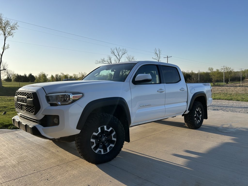

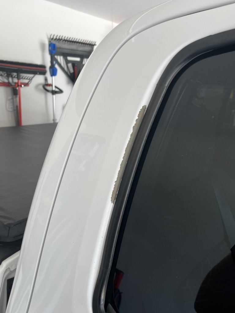

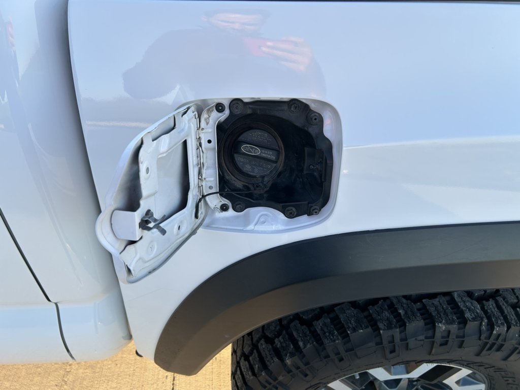

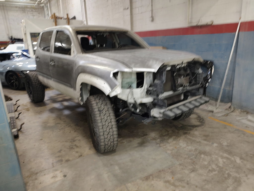

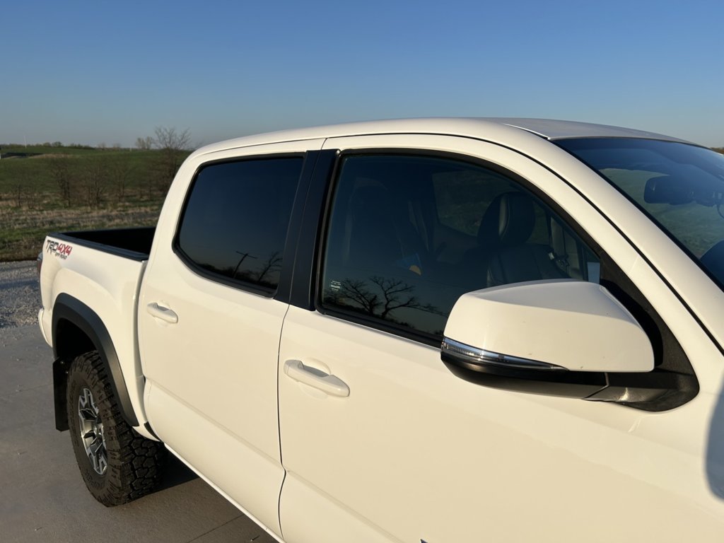

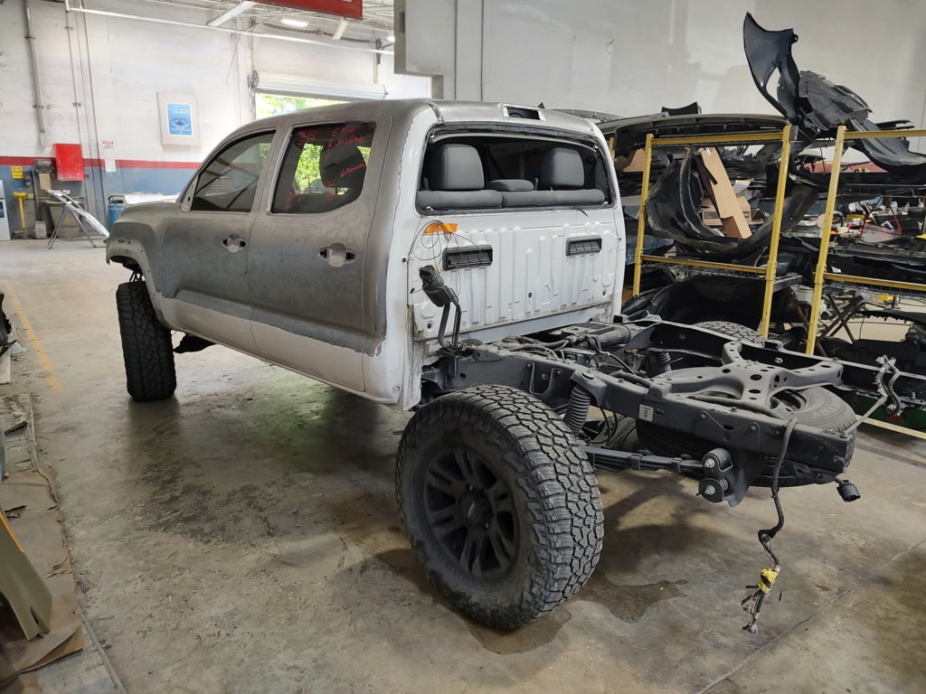

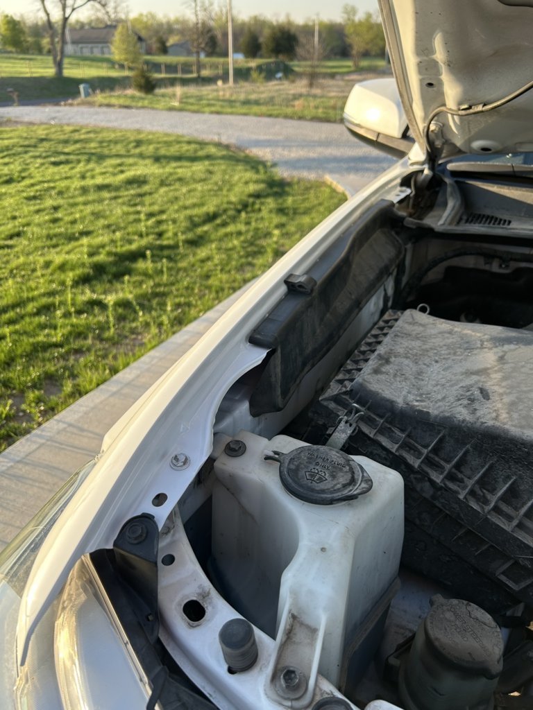

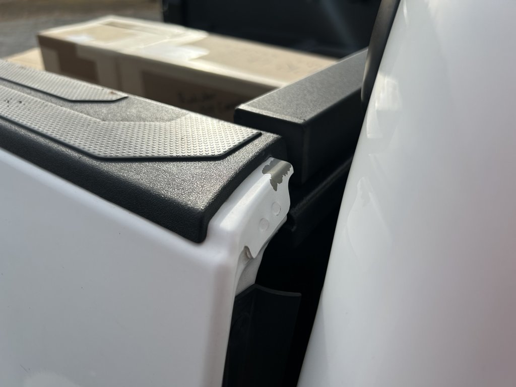

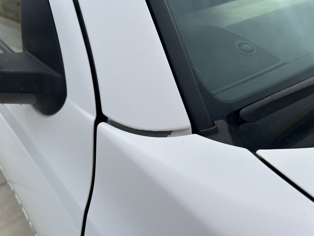

    Got my truck back yesterday. First of, let me start by saying my service manager said Toyota is probably going to roll out another bulliten this Summer or Fall to cover the other peeling areas. For more info, keep reading.
    I dropped my Tacoma off originally on 3/12/25. Which means Toyota had it for about 1 month. The entire time, I got a loaner Tundra SR5, which was nice. But not as nice as the Capstone I had the previous time for a different service thing. Entire loaner vehicle was covered, no questions asked.
    Originally, the service manager warned me that Toyota is unlikely to honor the repair of paint outside of what the recall mentions. And as you can see in my photos, I had A LOT of peeling paint all over the place. But they said they would submit a request, nonetheless.
    Then I got a call from the manager stating that Toyota is going to honor the entire paint repair. Some Toyota inspection guy came out and looked at the truck. Apparently there was some back on forth on whether they would paint the doors and fenders now, and LATER have me come back to get the remainder of the paint issues fixed, or if they would just do it all now. Manager said he advocated on my behalf, explaining that it's a hassle to bring customers back in and do the whole loaner vehicle thing again.
    The tricky thing about repainting the entire truck is that they likekly have to remove the windshield if the roof is peeling. Usually, when the body shop removes windshield, it breaks. So Toyota has to pay for a new one. My truck got a new windshield... Guessing the original didn't come off very easily. I also noticed new weather stripping on the itemized list. New decals...etc.
    I hope this post helps those who are uncertain about what Toyota will or will not do. I also realize my VERY positive experience with Toyota might cause some pain to those who got the short end of the stick with Toyota. But again, it seems pretty clear that Toyota is going to follow up on all of the paint issues, not just the doors and fenders. That's what my service manager said, anyway.
    Dealership: Legends Toyota, of Kansas City, KS
    Paint Shop: B Street Collision
    ps. When I got my truck back, somehow, there were two fishing bobbers and a small package of masquera in the door compartment... I have NO IDEA where that stuff came from.
    Loaner Truck:
    Original paint peeling:
    New Paint:
    Canadian Caber and TVphotog97 like this.

  8. Apr 11, 2025 at 9:45 AM
    #1188
    Genypig
    Aug 29, 2018
    #264477
    279
    Yev
    2018 Tacoma TRD OR
    Sorry guys, I promise I attached all the photos as "Thumbnails", and not "Full Image". I even checked the code during a post-edit.

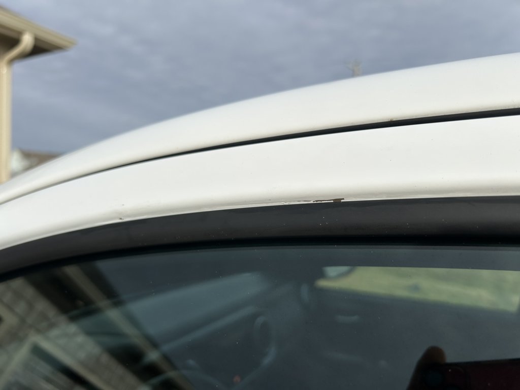

    My son has a 2020, picked up few years ago as a CPO, nice clean truck. Always inspected when washed at home and thought we were good. Today, there it was, peeling on the rear door. Waiting to hear back from Toyota dealer as just reported today. Just one spot so not sure if wait till worse, or will they usually paint all anticipated problems areas. Any thoughts appreciated. Thanks

    Report it, I’m pretty sure that’s how it started for all of us. Check the edges of the fenders under the hood, might have started there already and you haven’t noticed
