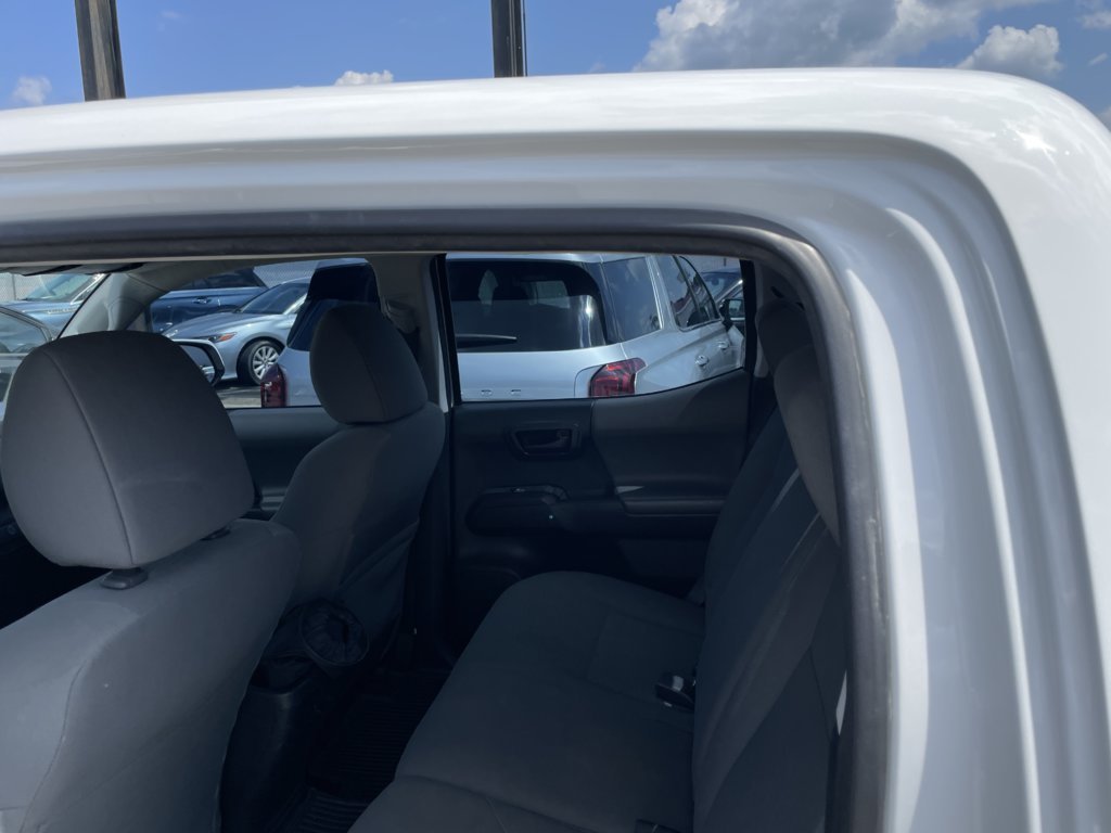

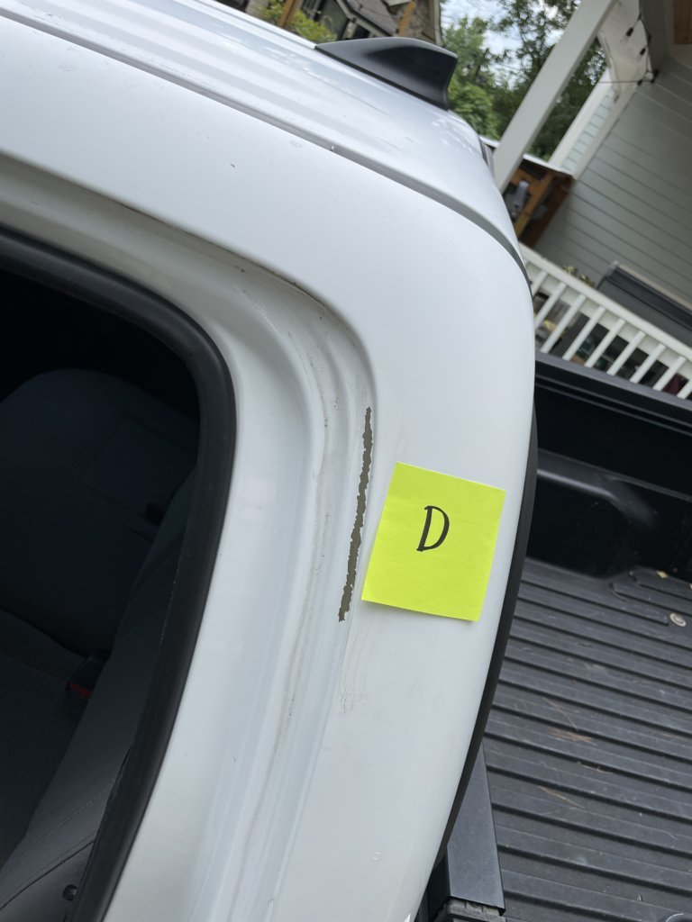

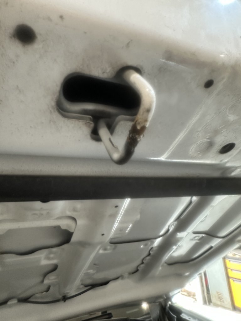

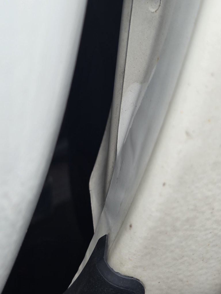

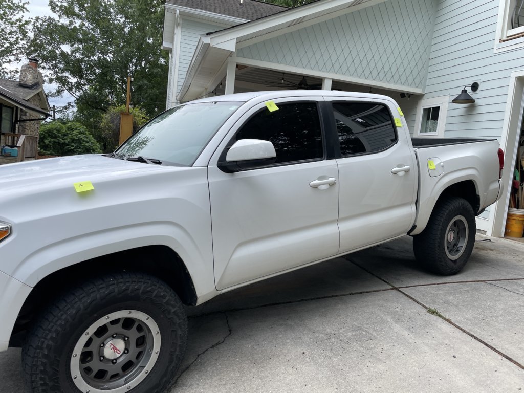

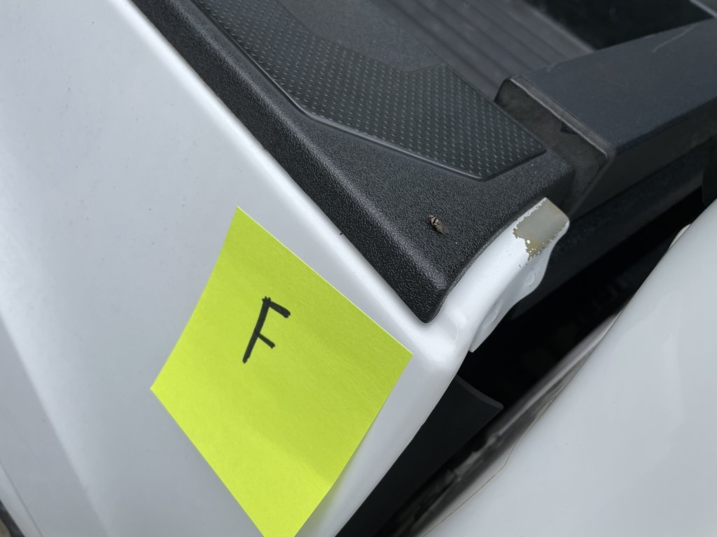

    BEFORE:
    I drive a 2017 White Tacoma with all the ordinary peeling issues like you guys. My truck has been at the Toyota dealership collision repair center for 20 days and is scheduled for completion today. We will see how it turns out. I have peeling on 8 panels (some panels not covered in the original and most recent "Remedy Notification" as of today). Our dealership has quoted me for painting the additional panels to have a complete job: roof, 2 back fenders, and tailgate. Bumpers are not being done and not expected to ever get covered by the Notification per dealership. I've decided to get these additional panels done for an additional charge (about $500 per panel) and then charge these back to Toyota as the Notification continues to expand. Our dealer expects the Roof will be next on the official Notifications. This may be a bad strategy... but I didn't want to risk having multiple rounds of paint and partially removed panels and paint work. Hopefully I'll get most of my out-of-pocket covered over the next year.
    Before I dropped it off at the dealer, I coded and marked all of the peeling areas and photographed everything. Here's a few examples of the way I documented the project. Let me know any other advice or warnings you guys might have from your experience. Good luck with your trucks! Cheers!
    Canadian Caber likes this.
  7. Jul 23, 2025 at 3:52 PM
    #1267
    MyNameIsEarl
    MyNameIsEarl New Member
    Jul 18, 2025
    #474397
    3
    2017 Tacoma 4x4
    AFTER:

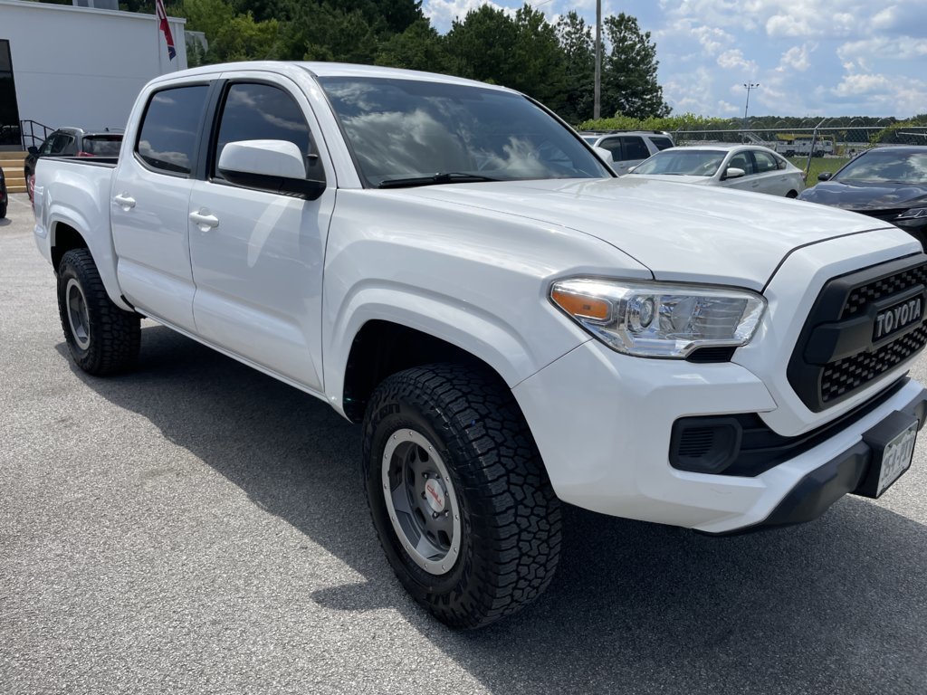

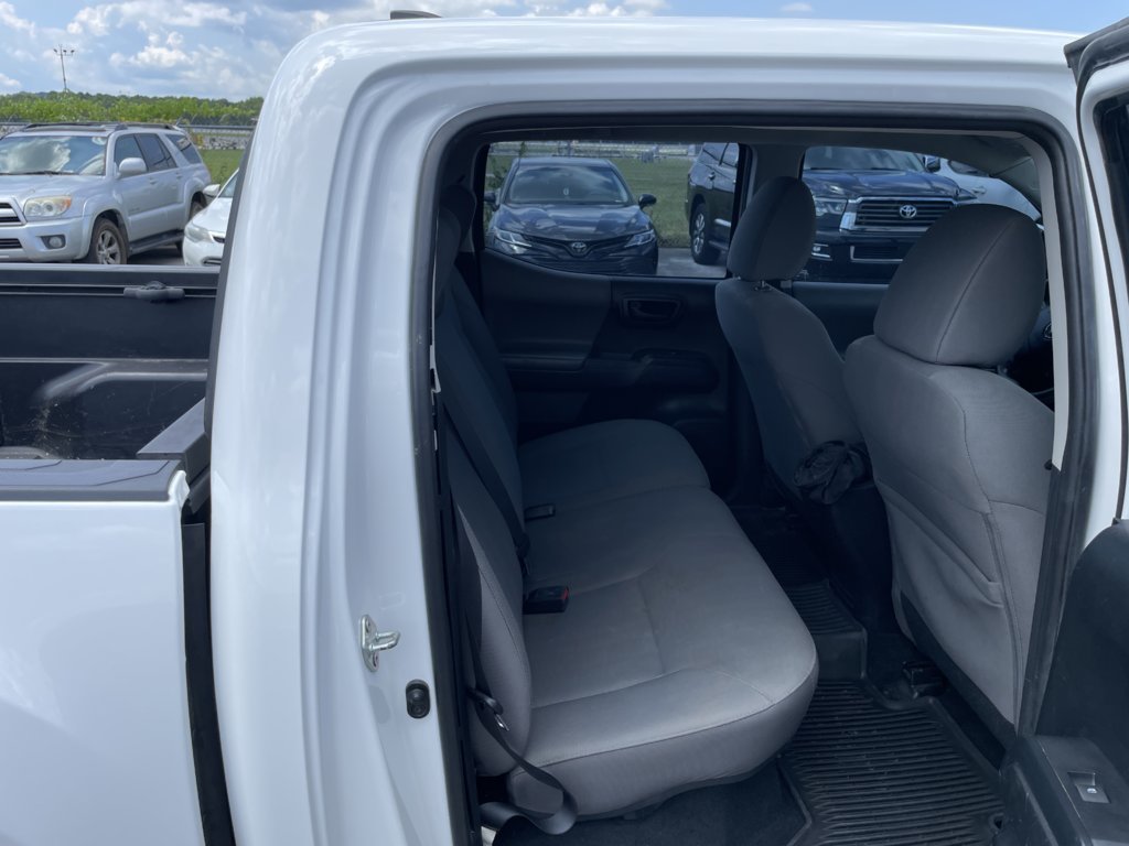

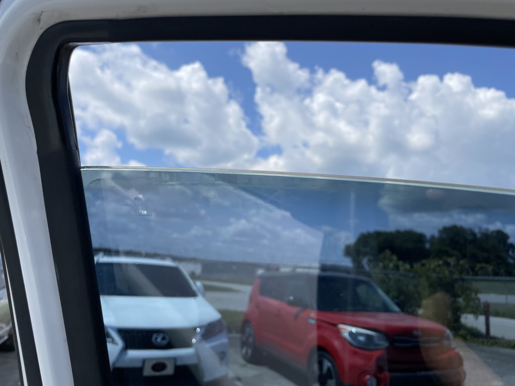

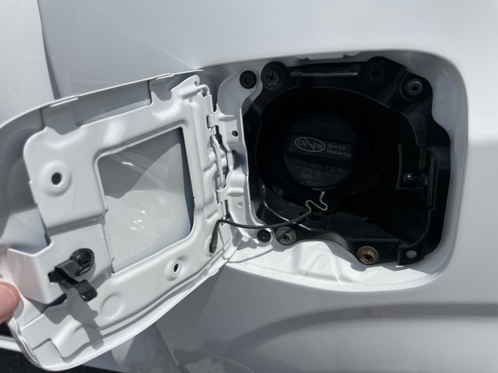

    Got the Tacoma back today from the dealership collision department. The paint is gorgeous. Everything was painted except the front and rear bumpers (with about $2,300 out of pocket for the additional panels that were peeling). Dealership said there are 4 additional Tacomas in the shop right now going through the same process. My truck took 23 days from drop off to completion. Dealer provided a rental through Enterprise. A few things I noticed for those of you getting yours done next:
    1) Check your window tint. Mine is damaged on all 4 doors at the top where they removed trim. (this is also mentioned in some previous thread entries, so it's a pattern) I'm asking the dealer to replace this.
    2) Look over all of your interior door trim to be sure it's attached securely. I found a section on the rear pillar that was not fully attached.
    3) I had the crummy (and broken) fuel door fixed/replaced and painted while I was at it (paint was peeling from the door). There was a parts fee of about $80. It may be a good opportunity to get that done when you take yours in.
    Otherwise, so far so good! I'll keep this post updated as I ask Toyota Corporate to reimburse for those additional panels if they get included in the next round of Notifications. Cheers!IMG_5974.jpg IMG_5982.jpg IMG_5975.jpg IMG_5988.jpg IMG_5993.jpg

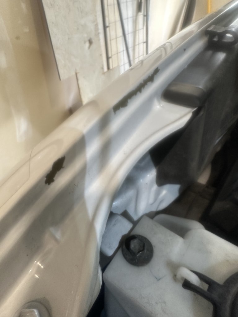

    Just now falling victim to this on my 2018 TRD Off-Road.
    The front edge of the gas cap and the edges of both front fenders at the base of the A pillars are peeling up. My phone camera couldn't pick it up well enough for a photo, but the clear coat has totally failed on both front fenders between the top of the wheel wells and the hood. I assume since none of this is what's mentioned in the letter I'm out of luck...

    The front fenders are covered in the 040 Paint Notifications. They usually peel under the hood on the inside of the fender... but that looks like you're having the similar issue just in a different section. Gas door is not covered at this point. My truck had the same issue on the gas door.
