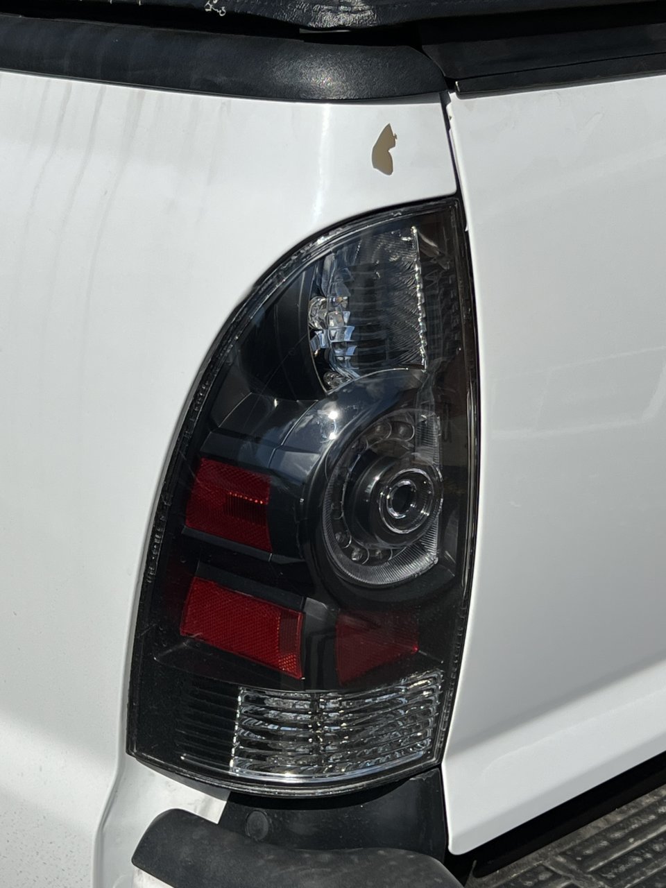

    Victim of it here! I’m very meticulous about my paint too!
