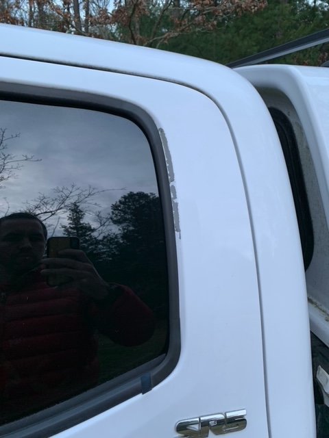

    Add me to the list. 2017 Tacoma, VIN starts with 3. Noticed paint peeling around rear driver side window. Brought to dealer who said I needed to see a Toyota Body Shop. Emailed pics and VIN to body shop who told me to contact Toyota. Called Toyota and they said not a big enough of a problem among Tacomas to warrant support. Frustrating.

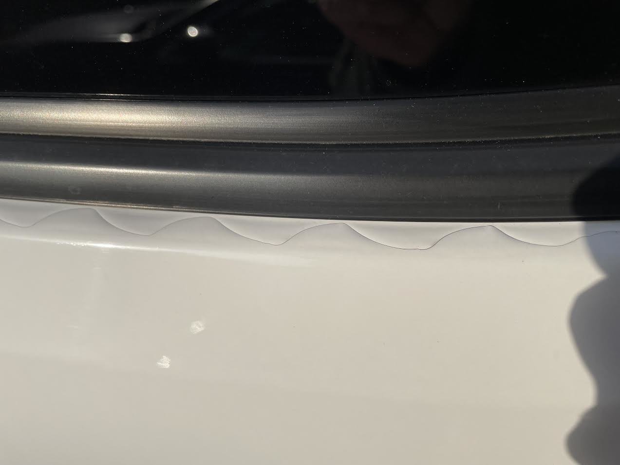

    Please add me to the list, my 2017 super white started flaking this year and the other day I walk out to my truck to find this crap on the lower seal of my rear passenger window. truck only has 28k miles on it and im the only owner. very frustrating since i paid it off this year. My VIN starts with a 3 like others have stated so mine might have been painted in Baja Mexico. hoping my local dealer will help me out(not holding my breath).

    The drivers side rear door on my '18 TRD Off Road looks just like tacomaWULF's photo above. I took it to the dealer this morning, he photographed it and is sending it ti Toyota, requesting a "good will" repair. We will see, I am not holding my breath, but wanted the paint issue reported to Toyota Corp. to help them understand that the Super White paint thay are covering on their other models is also on Tacomas...

    Mine too, around those door edges. Lived through this with my white 1st Gen also, that one had the hood chips.

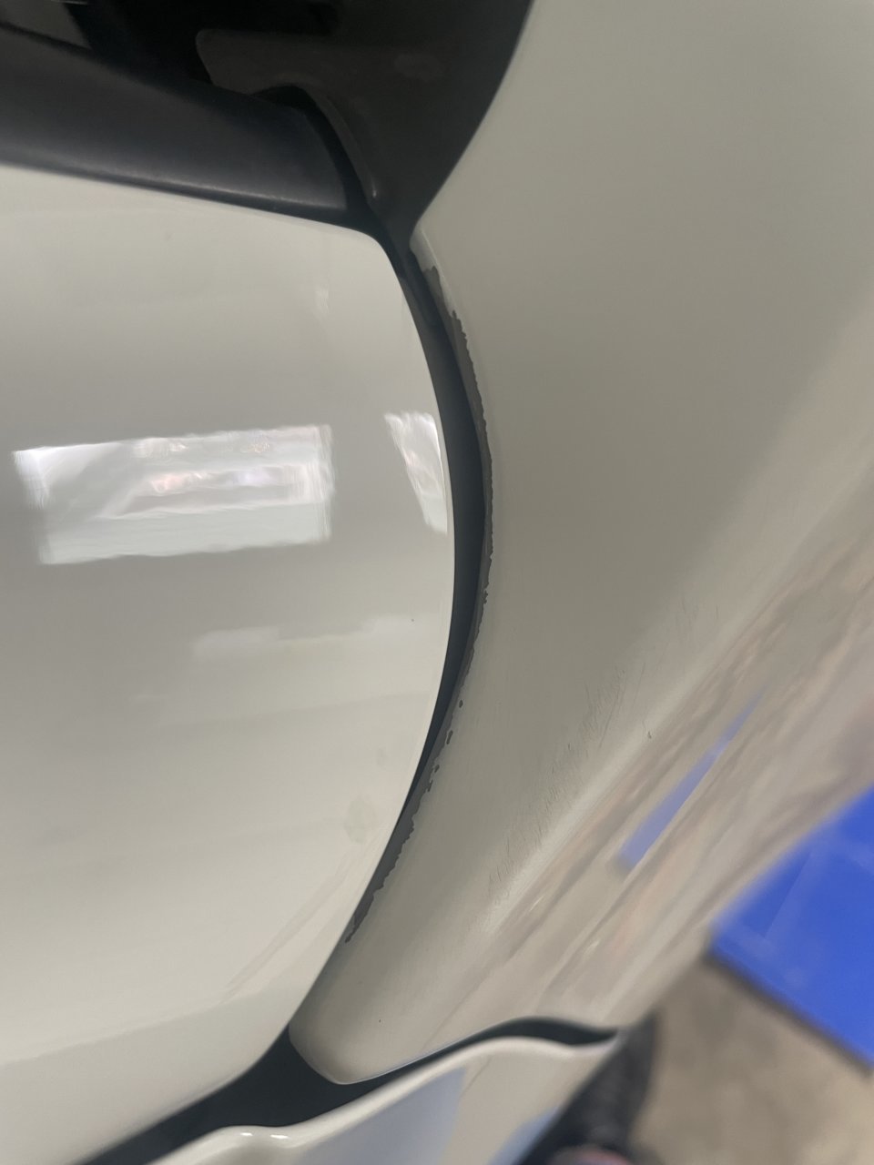

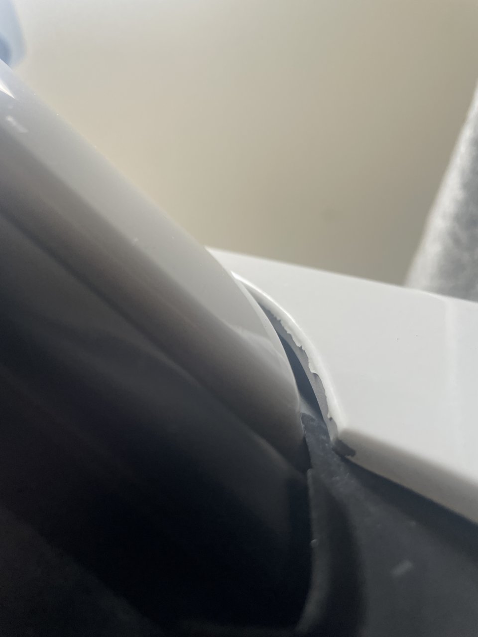

    Just noticed my front fenders are starting to flake where they meet the A
    pillar
    Just noticed my front fenders have started to flake in the exact same spots.

    Oof. A 2019. That's not a good sign for the rest of us.
