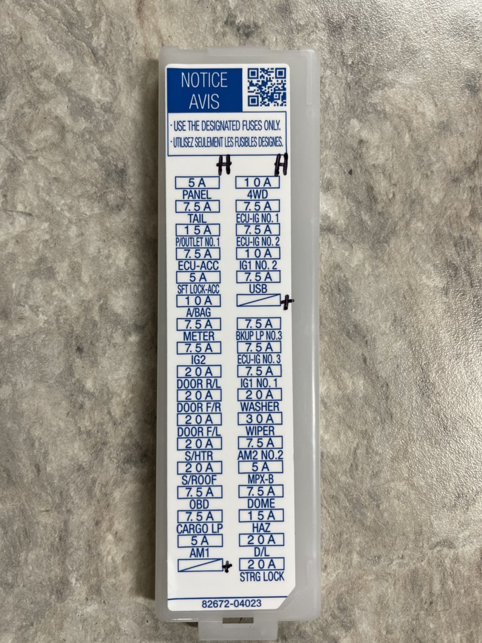

    The fuse panel under the driver side dash is all hot, generally uses negative side switching. So switched positive I had to grab the cigarette lighter plug wire, but something like sunroof fuse is a simple always hot fuse tap.

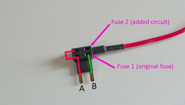

    Note there is an orientation to a fuse tap. The pin away from the wire must be the hot source. Otherwise you skip the fuse and directly power the addon wire.
