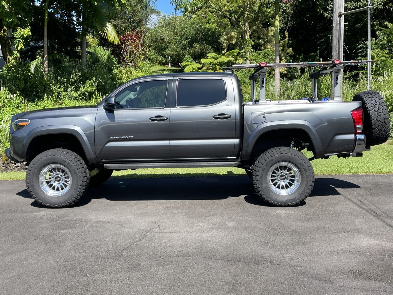

    Pro Comp 6", full length 5100's with OME 888 w/ taco lean spacer, 5160s w/ Alcan custom pack, HS extended brake lines, Summit offroad Dakar 17x9, 315/70/17 Falken Wildpeak MT, Nitro 4.88 regear
    Accutune said it right. You know what you should do but talking yourself out of it.
    If financially you’re not ready, just be patient - I try to follow a few simple sayings
    “buy once, cry once” and “buy nice, or buy twice”
    Personal experience - I once ran OME HD Dakars. Lasted me 3 ish years till they tired and sagged. I had to buy twice - now I’ve got a custom Alcan pack that can hold 600 lbs over stock and maintain height.
    Over 300 qts of ice in Aussie coolers, 30 gallons of water, spare carrier and spare 35, other camping nonsense.
  9. Oct 5, 2022 at 2:23 PM

    what's that look like without 8-900lbs on the bed?

    lol…ughh..let me say that when Alcan recommends 5” spring, you should listen and not tell them “but I want a 1” rake when loaded”
    btw, this isn’t my daily so I’m okay with it
    DarkWoods04 and YF_Ryan[QUOTED] like this.

    I thought I had a lot of rake... hahaha. My Deavers are supposed to give 3 inches of lift at 700-1000lbs of constant load. I'm often running with none... even without a tailgate.
    alwaysHI[QUOTED] likes this.
