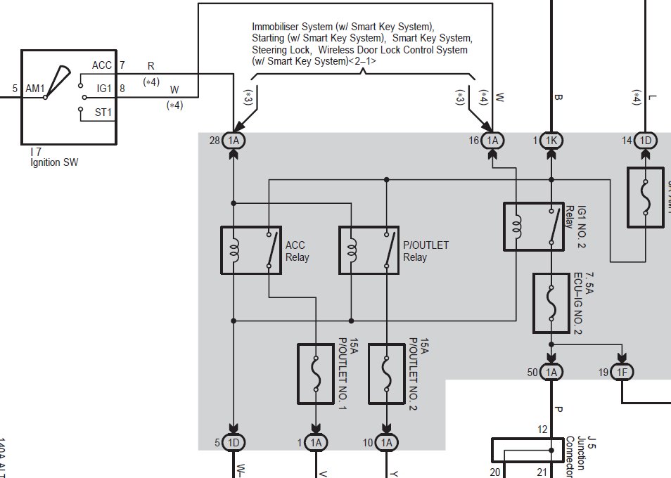

    Any suggestions as to what I need to do to make sure my outlets stay on once the truck is turned off?

    Jumper the ACC relay and P/OUTLET relay contacts.

    I took it somewhere and they did something and now it's constant power..thnx
