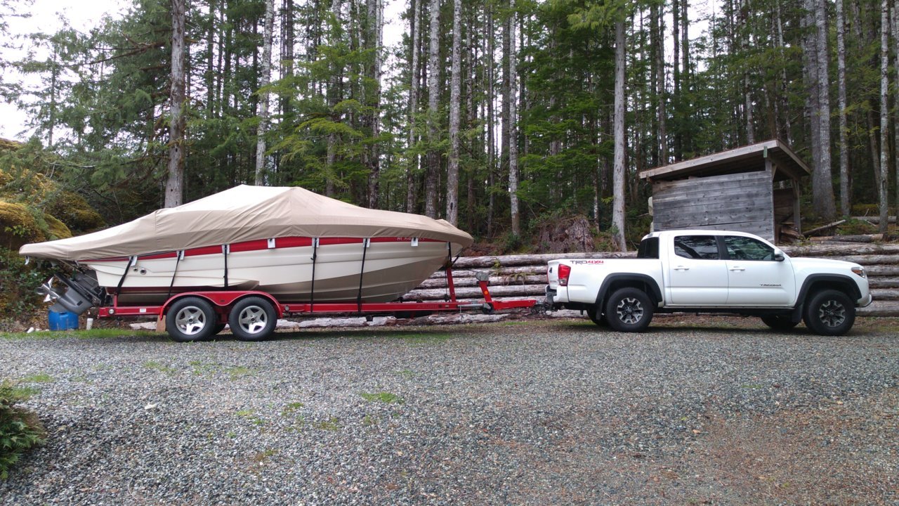

    I tow in S4 with ECT on and shift up and down as needed. Doesn't hold that kind of rpm unless I'm going uphill. These engines like higher rpm for power.IMG_20190414_1435424.jpg
