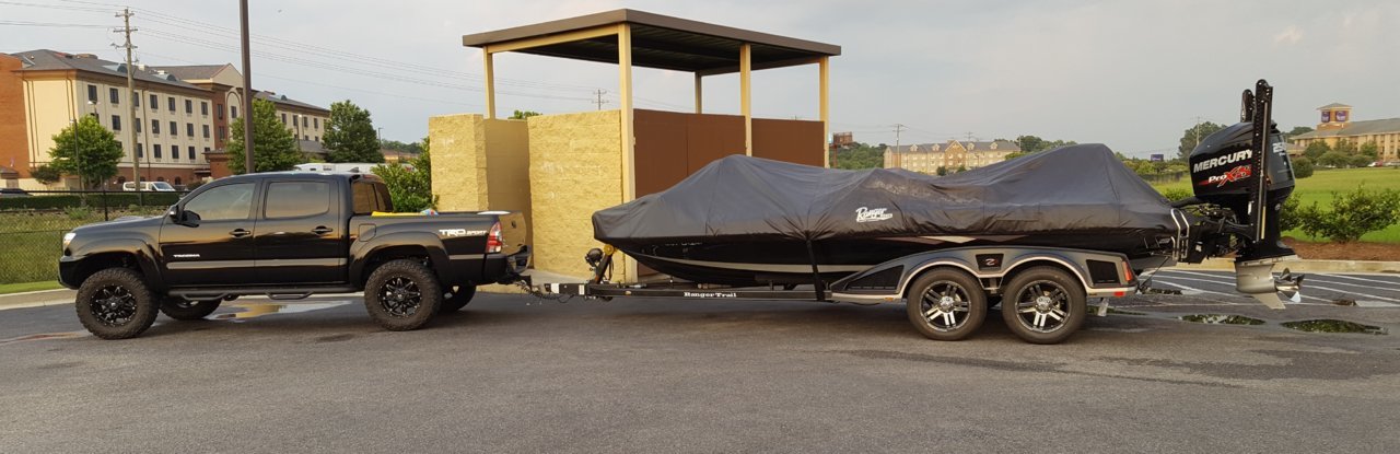

  16. Aug 15, 2019 at 5:14 AM
    #36
    15TACOSPORT4X4
    15TACOSPORT4X4 Well-Known Member
    Feb 14, 2019
    #283019
    296
    Stan
    2015 Black Tacoma TRD Sport 4x4
    3" lift on 33 inch Nitto's with 18" Fuel wheels. N-Fab step bars. Husky floor liners.
    Well because I pull this three or four days a week with no problem at all. Run 75 to 80 at 3K or less in 4th. Just seems to be a 3G thing to me.
    search450 and Superdave1.0 like this.
  17. Aug 15, 2019 at 5:29 AM
    #37
    RX1cobra
    RX1cobra Well-Known Member
    May 20, 2019
    #293789
    2,175
    19 OR
    Big difference between towing a pretty aerodynamic boat and a TT even if the same weight.
