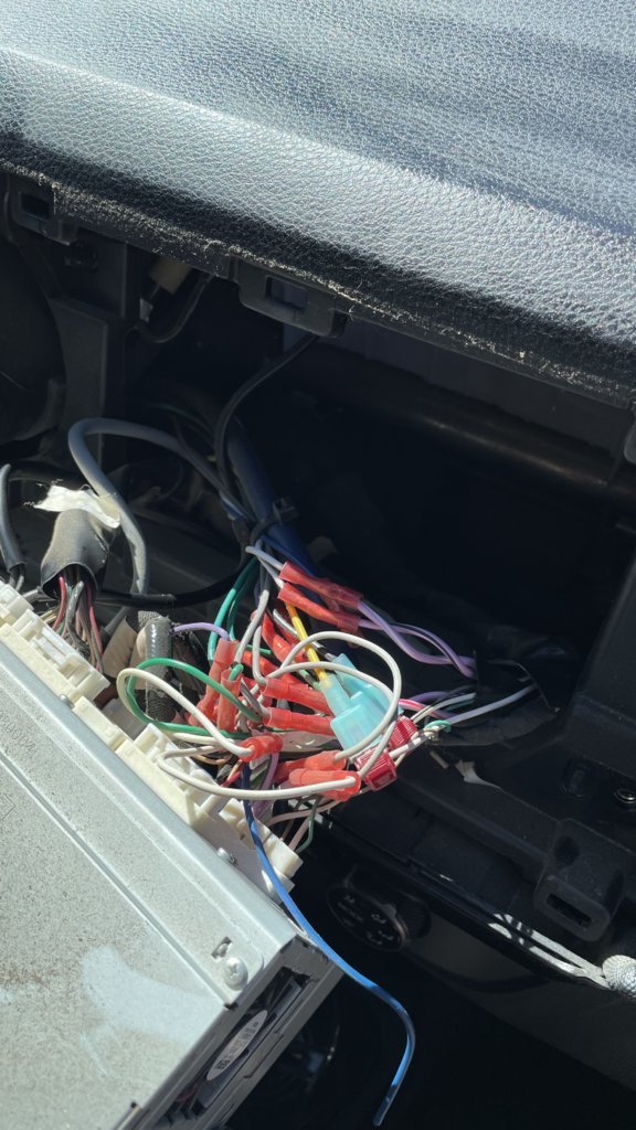

    Just pulled the head unit out and found this glorious mess. Definitely doesn’t look stock and I have no clue what any of these wires are tapped in to. Lovely

    Appears the previous owner had an aftermarket radio and tapped/butt spliced the wires for install. A plug n play harness would have been much easier.
    You could start by tracing the wires to see if anything is loose.

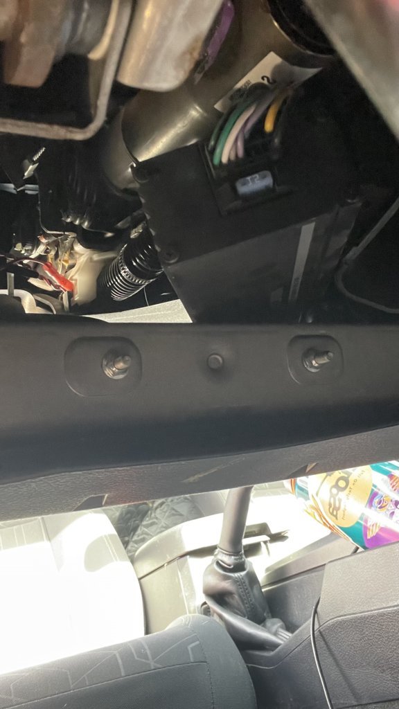

    Well, well, well, look at what we have here… traced the wires underneath the steering wheel and found the Kicker Key Amp. Turned down the gain all the way and was able to minimize the white noise but it’s still there. Really contemplating taking it back to the dealership where I bought it from and making them remove it. I’ll have to sleep on it.

    That looks more like the alpine power pack. Not my favorite of the smaller amps
  12. Sep 22, 2024 at 2:36 PM

    Yep! You are correct. Just looked it up and that is exactly what it is. Great eye!
