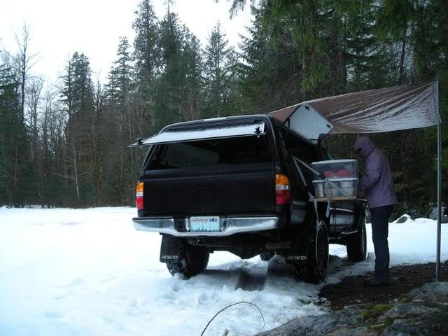

    Here are two of the bins to give an idea of size:

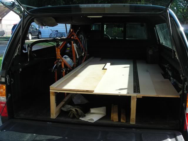

    Here's the platform during construction:
    The plastic bins go under the middle section of the platform. They fit snugly side by side and are tall enough that they don't move up and down much. The other camping stuff, not in bins, goes outboard of the middle section, around the bikes if I've brought bikes. If I don't have bikes with me then I fold the platform sides down to make things less visible.

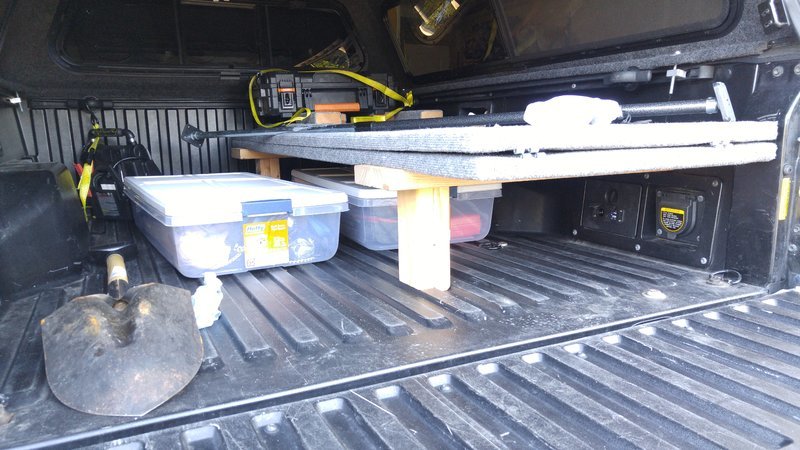

    When deciding on containers I spent an hour at Lowe's in the same aisle. I ended up with the husky ones posted above. I have a long bed and four can fit the entire bed, but I run two underneath the platform. I store recovery and typical supplies in them. They stay locked and in shape. No complaints from me. I use the telescoping bed bar to retrieve and push back the one at the front of the bed.

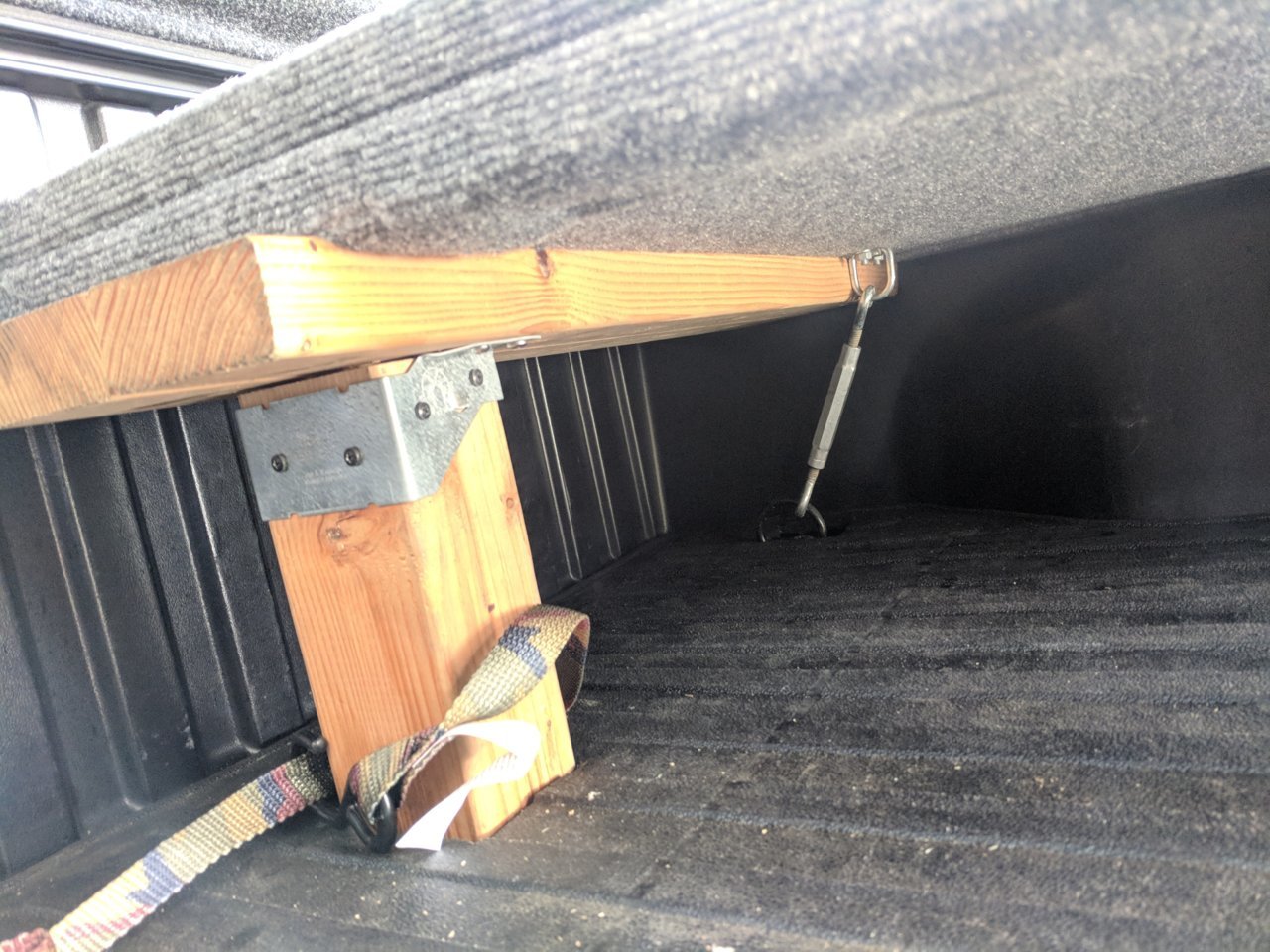

    Sorry to bump an old thread..
    yeos,
    I am looking to build a platform similar to yours. How did you secure yours to the side of the bed? Thanks!

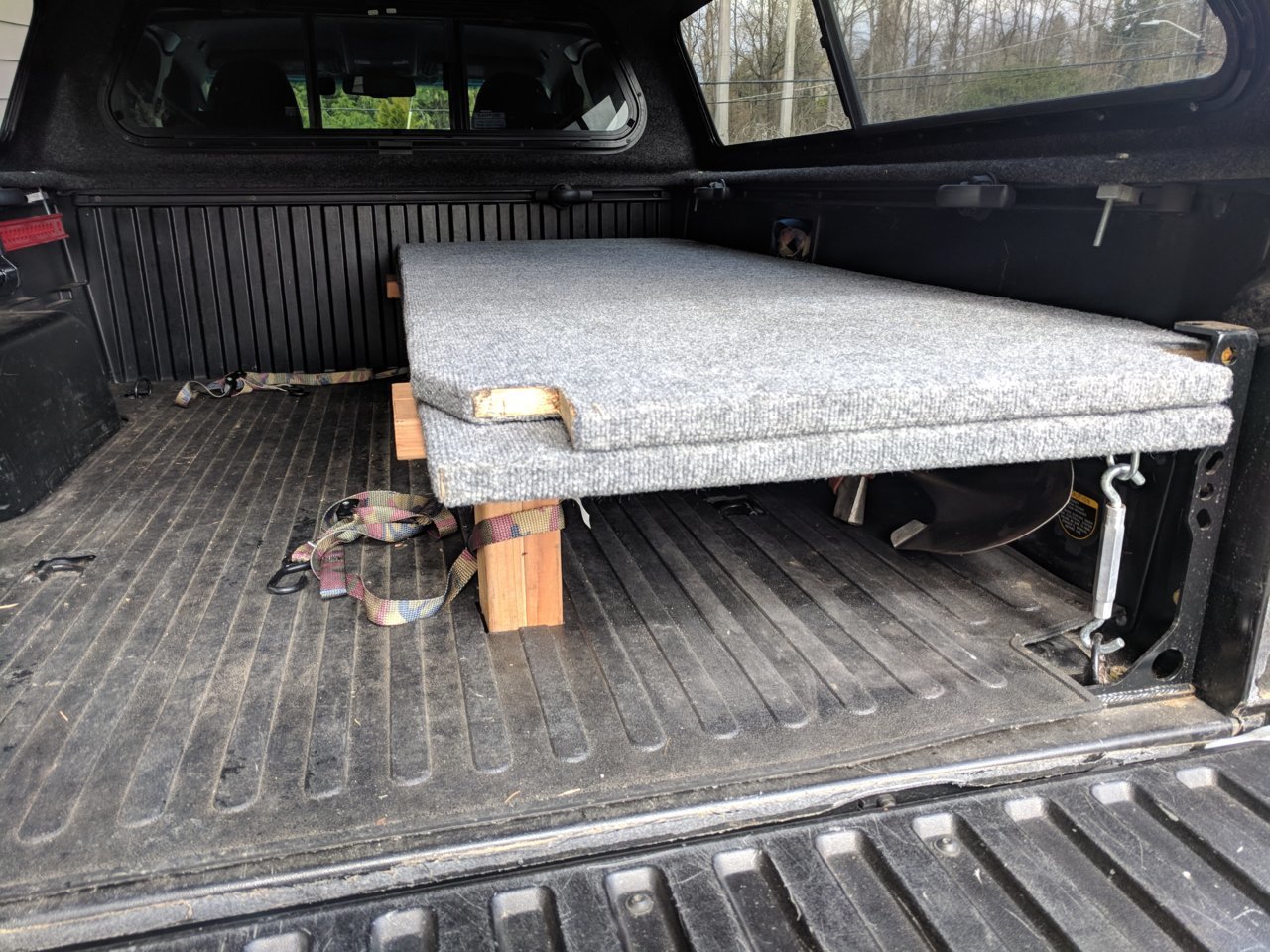

    It's not pictured above, but I used turnbuckles to tie down to the bed rings. I added two d rings to the underside of the platform. With the other half stacked on top I just used a cinch strap from the legs to the bed rail. I'm sure there are better ways to do it as well.

    I like it, simple. I like the idea of being able to flip over half of the sleeping platform and still be able to use the full height of the topper for bikes, coolers, etc. Thanks for the pictures!
