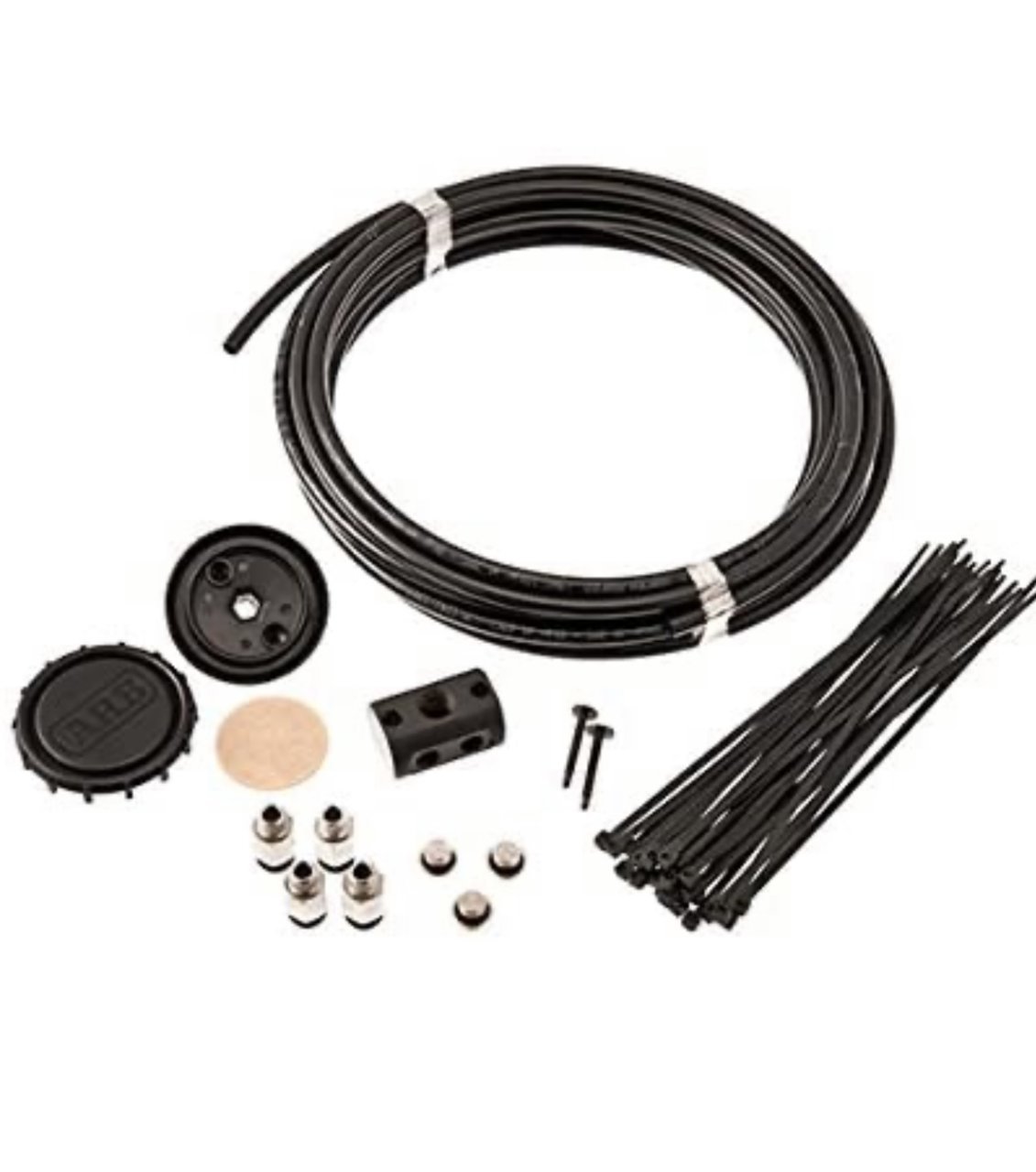

    ARB diff breather…if mounted inside the driver side rear taillight….the only holes you need to drill (comes with self drilling screws..is inside the top section taillight housing ….two screws to hole the filter only…hose is routed in opening with wiring…SIMPLE…

    My third member cost me $4,100 to replaced…. Consider the ARB diff air breather? Watch a few videos of the ARB air breather videos..and look who is installing them…! R4T…is one ..many more well known off roaders too..

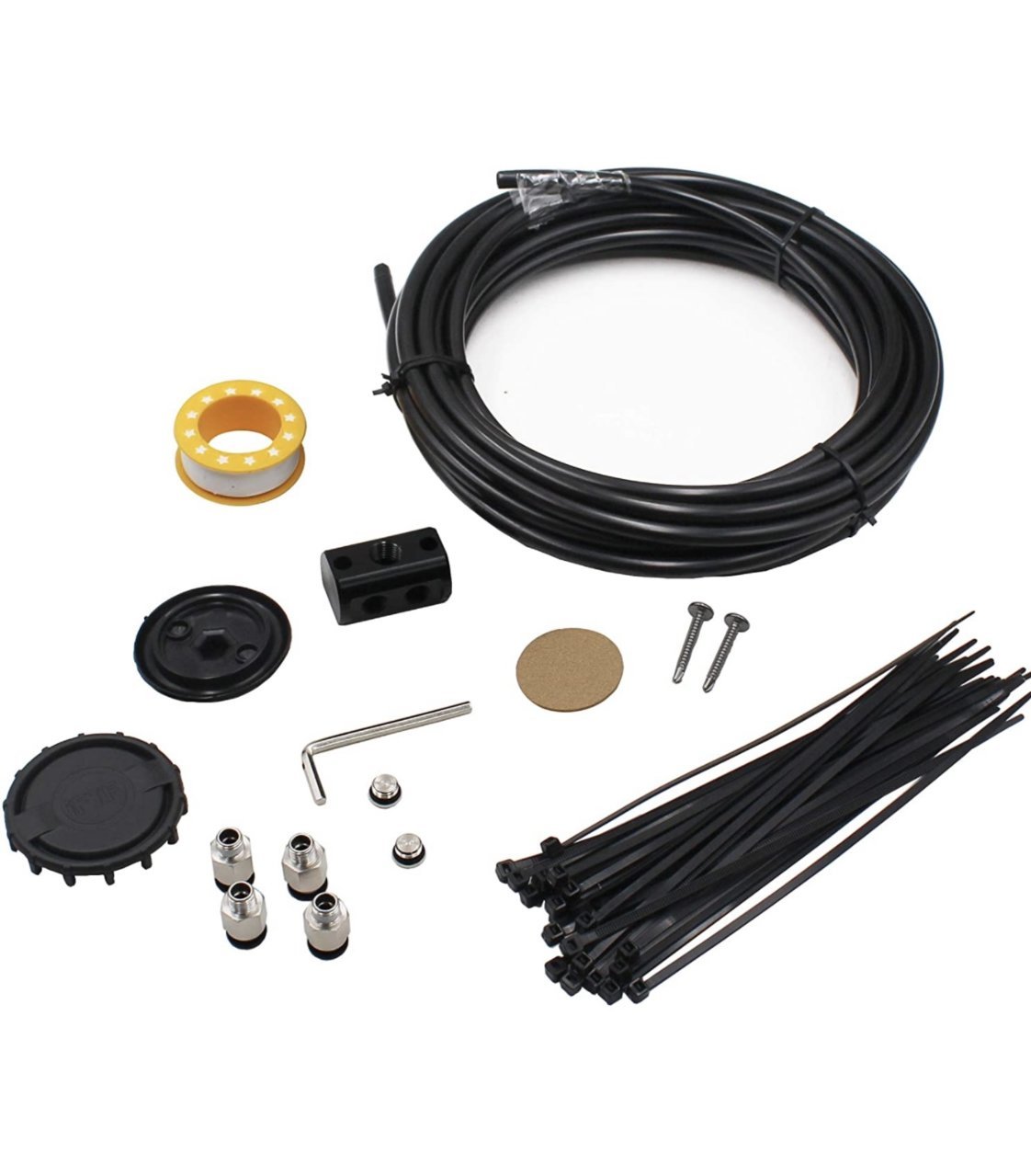

    this is exactly the same tech and design with a replaceable filter… just not ARB branded (which is one piece that is the filter cover that literally snaps on the housing)

    On Amazon they sell a knock-off ,copy of the ARB for about $37.00…. ARB diff kit runs about $78.00…. ARB ..just for the hose ,runs for $37.00…
    ARB filter is a screw on …not snap on…the fittings of the ARB..looks very high quality! Well made …you can see it and feel the quality!
    This ARB diff breather part is protecting your diff from getting water inside, release the pressure, and working with high heats!
    Maybe the knock-off might perform the same? And maybe NOT? For $78.00 Real ARB vs $37.00 knock-off ?
    I put my trust in ARB reputation! It’s my REAR END!

    they both screw on… the cover snaps on and holds the filter in place.
    Here’s a side by side… pretty much the same sourced parts just branded differently.

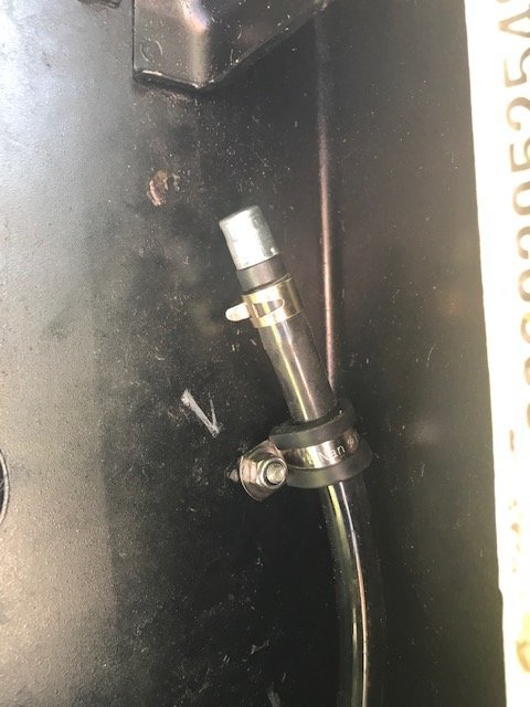

    After having the parts lying around for quite a while finally did this mod. Wasn't worried about fording deep water but read/saw to many cases of the OEM vent clogging and the rear brakes being ruined due to gear lube being forced out the axle seals. It was easy and cheap and one less thing to worry about.
    Only thing different was i used thick wall silicone tubing. Quite a but more flexible that fuel line..
    Used stainless hose clamp and attached to one of the existing exposed bolts with stainless nylock nut.

    #1 that area is supper clean and isn't exposed to water or dirt unlike the inside of the fuel filler door. I never plan on inspecting that anyway. My photo of my install was done after 9 years and didn't need to do any cleaning at all.
    #2 no holes to drill. There is easy access to that area from existing passages. And there is a handy bolt inside to clamp it to.

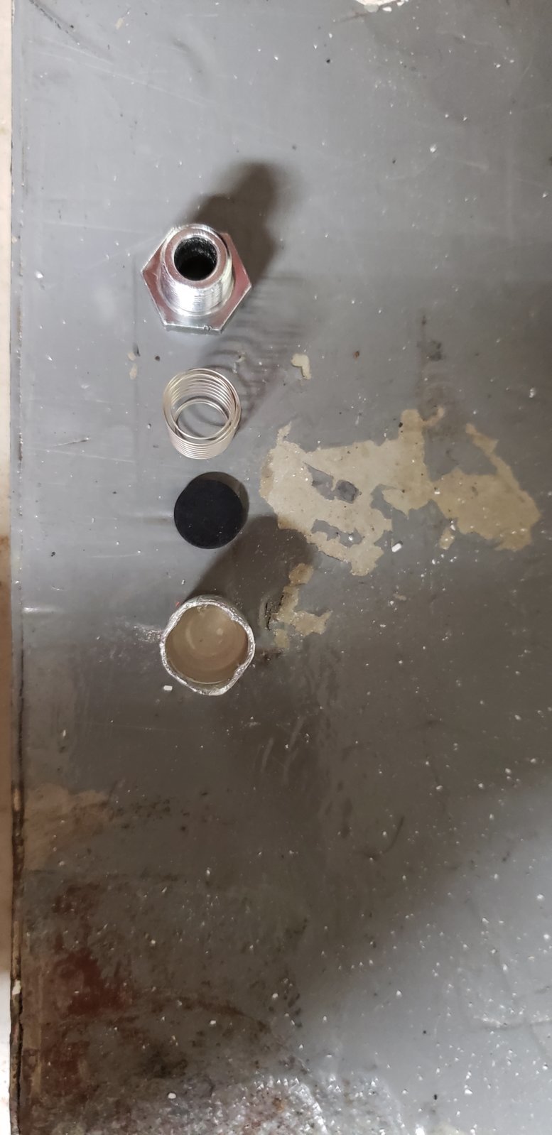

    You can also disassemble the OEM one, remove the spring and shut off, drill a few holes, and you got one for free.

    That would work but very very vulnerable if ever submerged. But would prevent the issue of pressure induced clogging.

    If you're submerged up to the top of your taillight, I think you potentially have bigger things to worry about. But granted, this creates an "open breather" that would not close if there was water ingress.
    I don't ever expect to be in that deep and this has not introduced water or other moisture in my case. Diff fluid changed a few weeks ago; I've been running this mod for 27k mi.
