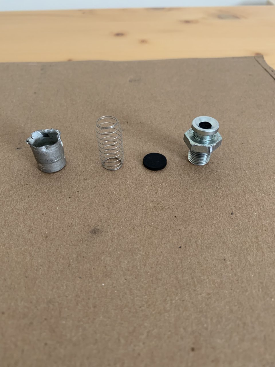

    Here is a picture of the rear diff stock OEM breather that I removed from my 2020 and disassembled after doing the rear diff breather relocate mod.
    It sure seems like OEM is a one-way breather, lets air out, but is supposed to seal up and not let shit in... Same as Smacky2020's picture, just a different angle.
    I replaced this with an OEM one-way breather up in my taillight because if water got that high, I have other problems to deal with...
    I do not and do not plan to launch boats at a boat ramp, but if I did I would think a one-way breather would be optimal. Due to the angles involved, I could see where water might reach the rear taillight if you were launching a boat on a trailer at a boat ramp...
