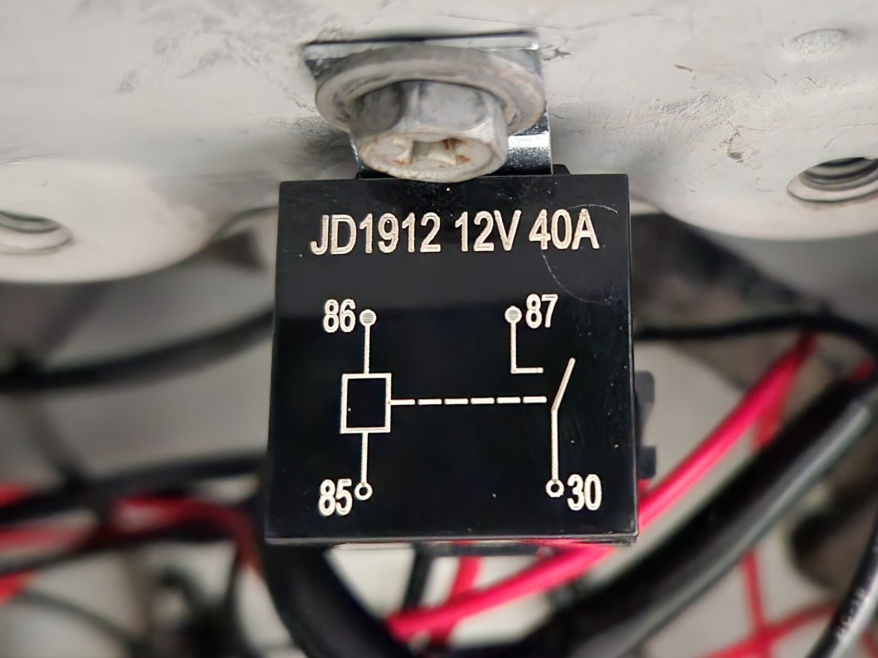

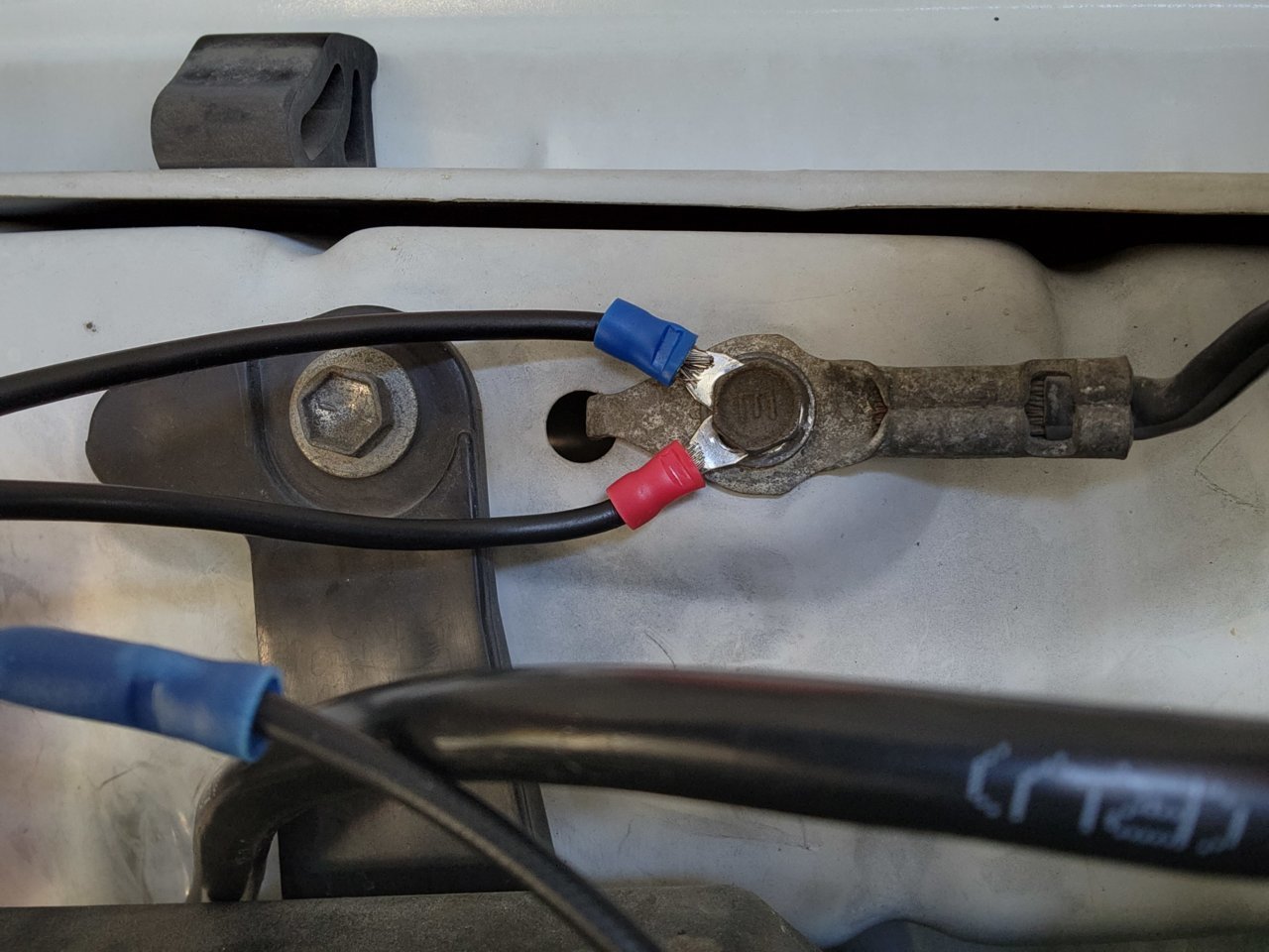

    Can you description the best you can how you wired the lights?
    Take a picture of the battery connection, the relay, and the light connection.

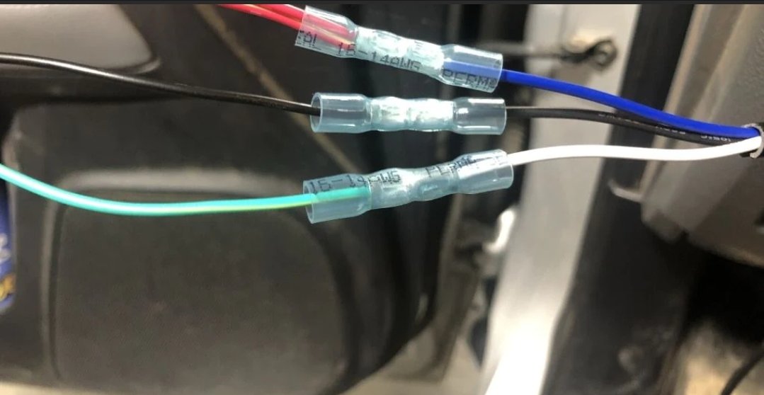

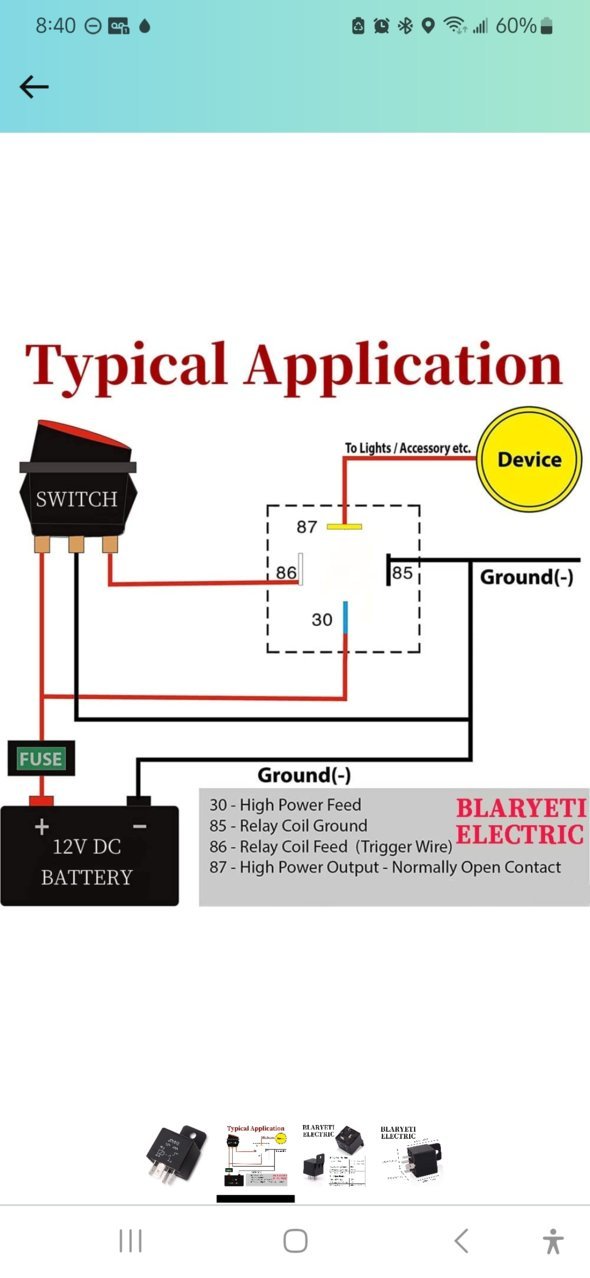

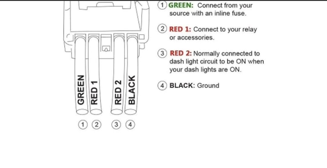

    I wires the Caliraised switch just as suggested based on the site. Screenshot_20221111_184339_Chrome.jpg Screenshot_20221111_184358_Chrome.jpg

    That helps some, but not enough.
    Unless your green wire is connected to the fuse that is blowing, it’s not the switch.

    I found the relay that came with the kit. I'll cross reference everything is going to the right place in the morning
    I'll also double check all the connections from the lights to the harness

    Be sure to trace the daisy chain of positive to negative connections completely in both circuits to verify they never cross. Don’t assume that wire color means the same polarity across different suppliers. Feel along the harnesses length to see if there are any butt joints hidden inside. I’ve come across these and if positive and negative joints aren’t staggered you can get a short.

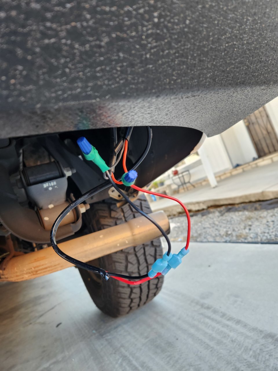

    I just double checked all the connections, nothing is reversed. Nothing is touching metal.
    Although now the front doesn't even blow or turn on, the rear lights is still blowing

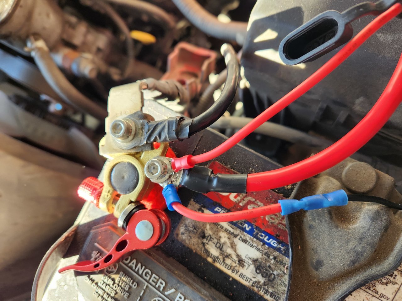

    Next to last picture. You have a hot (red) lead coming off the battery spliced into a black (normally ground) wire.
    Oh, and lose the wire nuts. They have no place in an automotive application.
    vicali, SR-71A, AJKlug1 and 2 others like this.

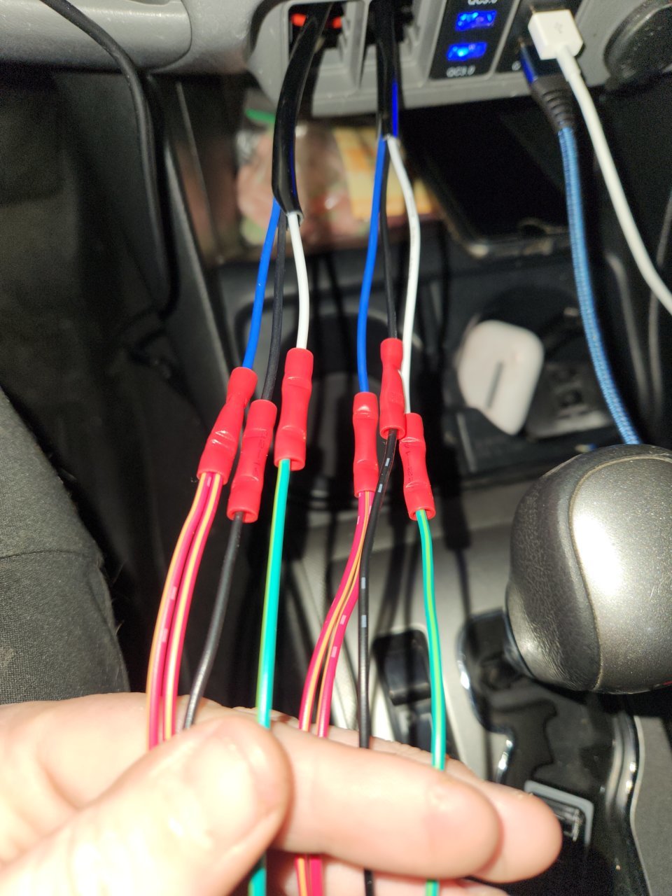

    In the picture below. Where is the black wire going?
    And why did you tie the 2 reds together?
    One red is trigger to relay.
    The other is power for the light in the switch.
    The black is only used to ground the light in the switch.

    The wire nuts are temporary till my T splices get delivered.
    The black wire spiced to the red positive is actually the inline fuse, they only had black wired one at the store.
