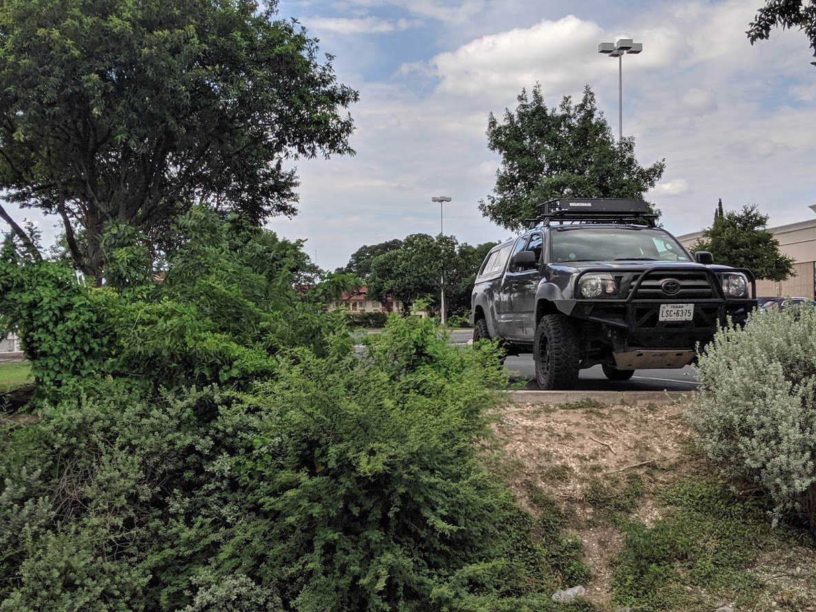

    After coming off a one and a half year deployment to East Africa I bought a '10 access cab in 5 speed manual. Came with a 2.5" bilstein lift, rims (not my favorite) and tires and a camper shell. I put $7 or 8,000 in parts alone into it and did as much labor on the truck as I could myself.
    I spent two months living out of the back of this thing, hitting the start of the transcontinental trail, Elephant Hill in Utah, and a dozens camp sites inbetween there and San Antonio. I had zero problems while using this thing as an adventure rig.
    Now that it's my daily driver I am plagued with constant repairs, the most recent being a "busted" power steering line and leaking rack. The dealer wants $1840, but it seems like I'm paying $1000+ every month to maintain this thing and wondering if it's time to draw the line.
    I love this thing, but is it time to walk away? Is there a cheaper option than $700 to replace just the power steering line?
