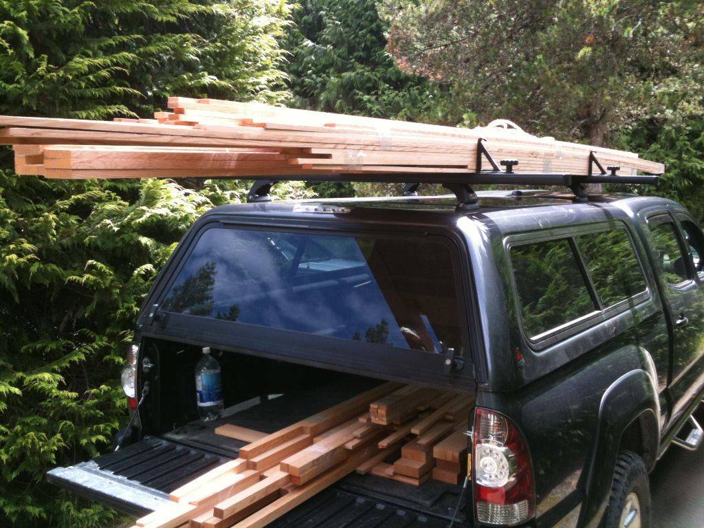

    My best " contractor " mod was buying my commercial Leer cap , the 100RCC , the roof is reinforced and the roof racks are rated for 400lbs

    This would get my vote also. Dry, lockable storage for tools and the ability to carry longer pieces of wood on the roof if needed. (and they look nice also, so you wouldn't immediately think it's a contractor's truck).

    Pics

    nice oz
    love them sliding stakes up top
    is that all oak
    i see alot of thin stock in there
    is that scrap? cant be
    or optical illusion
    whats going on in there

    Douglas Fir finishing material , up to 16' , assorted sizes , some ripped to casing dimensions

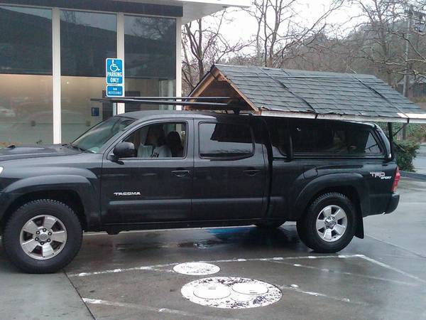

    Full on Rack it around the camper....tough

    Wouldn't it have been easier to cut that piece of crap up before hauling it to the dump ?

    Actually it's a shed I bought and dis assembled to put up in my yard, that fucker was heavy and I'm not a carpenter like you OZ.

    dude that roof mod is so effin sweet
    that thing would have been strapped to my truck for weeks
    i have a couple friends who would pay $10 a week to crash back there
    for the summer
    and they'll wash the windows in the morning too
    but seriously your setup(under the peak) is really nice
    that would be perfect setup for me
    thats about $1500 worth of gear no?

    The Rack I got from this company:
    http://search.yahoo.com/r/_ylt=A0oGdW002mtP6icA6U9XNyoA;_ylu=X3oDMTE1YXByb2NsBHNlYwNzcgRwb3MDMQRjb2xvA3NrMQR2dGlkA0FDQlkwMV8xNDE-/SIG=119e5q36i/EXP=1332497076/**http%3a//rackitinc.com/
    They are not cheap, I forget what it costs because I got the cap and rack at the same time for $2300 installed by Campaways
    Edit: You have to beef up the rear suspension for a set up like this

    Hey Racheal , how does yours work with the cap ? Is the bedrail " foot " widened so the rack uprights are outboard of the cap ?

    Well Roy, the rack's footings extend outboard of the shell for the uprights, inside of the bed there are two posts closer to the cab that bolt into the two forward bed bolts and the rear two attach to the corner pillars (which go to the frame). It's a trippy set up but in essence the rack is attached to the frame, not resting on the bed, it's actually quite stiff, more than I thought it would be. That shed roof took four guys to get it up there.

    I looked at the standard Tacoma mounting set up on the website you posted , looks pretty stout
