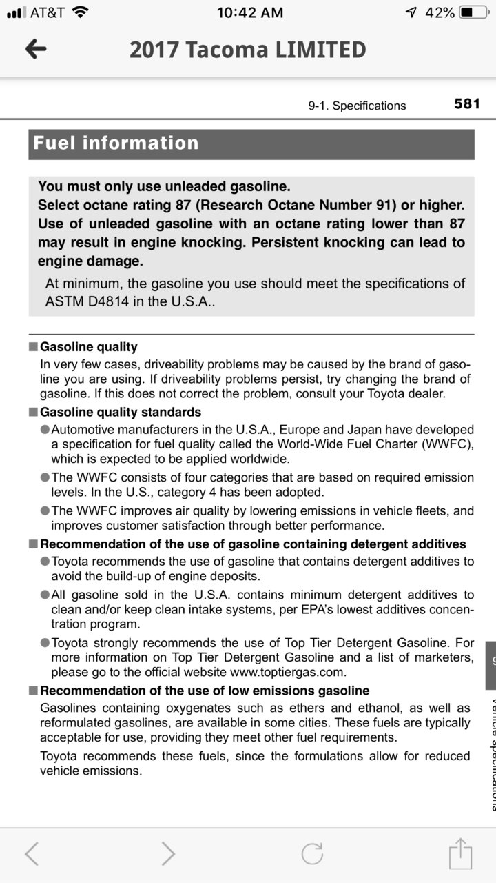

    You are correct, as indicated in the Owner’s Manual:

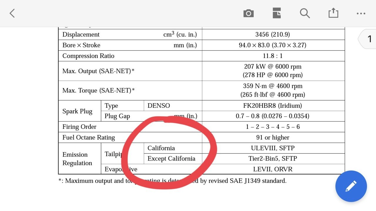

    That's a bit of a reach to claim that. The truck is sold outside of North America with a specific CA compliant version mentioned because it is different.
