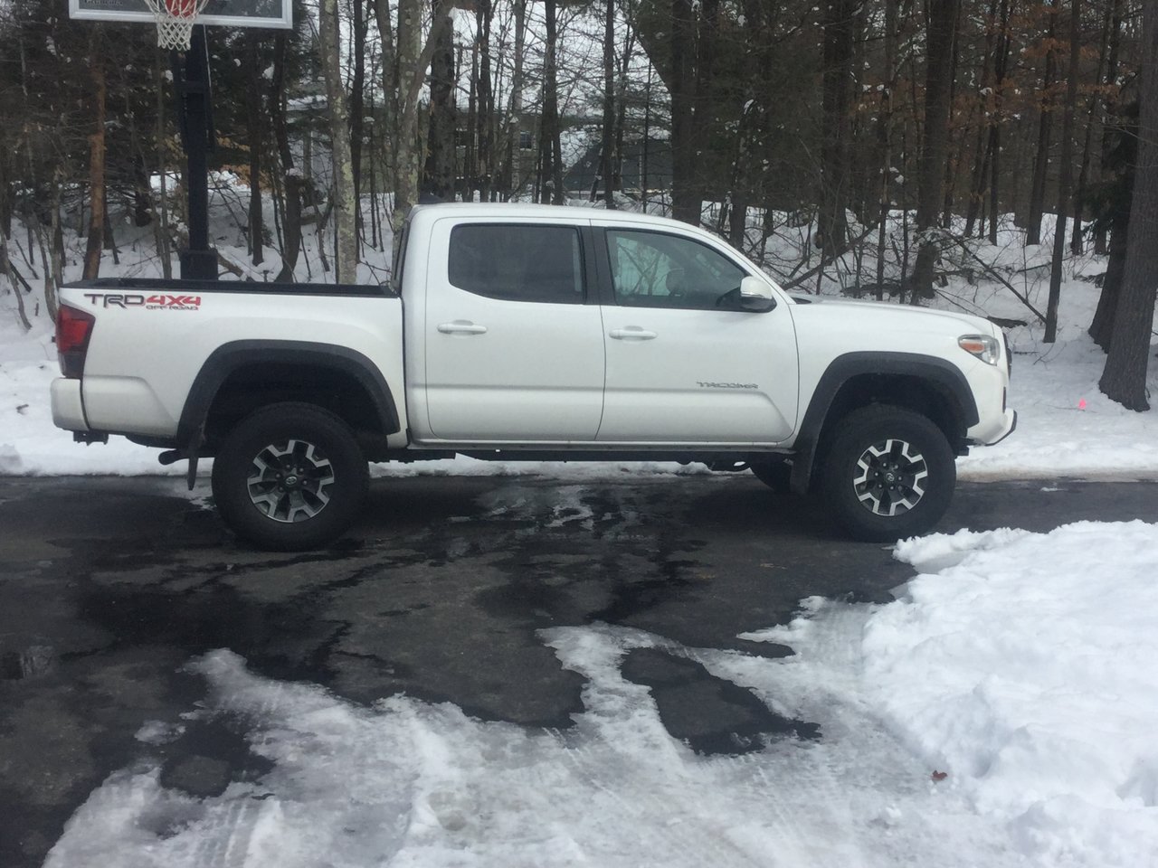

    Installed the front yesterday,went pretty smooth. If I did it again I would have cut the top controll arm bolts fwiw 19A708D0-DFBF-47BE-B6DF-DF85C5951CB5.jpg

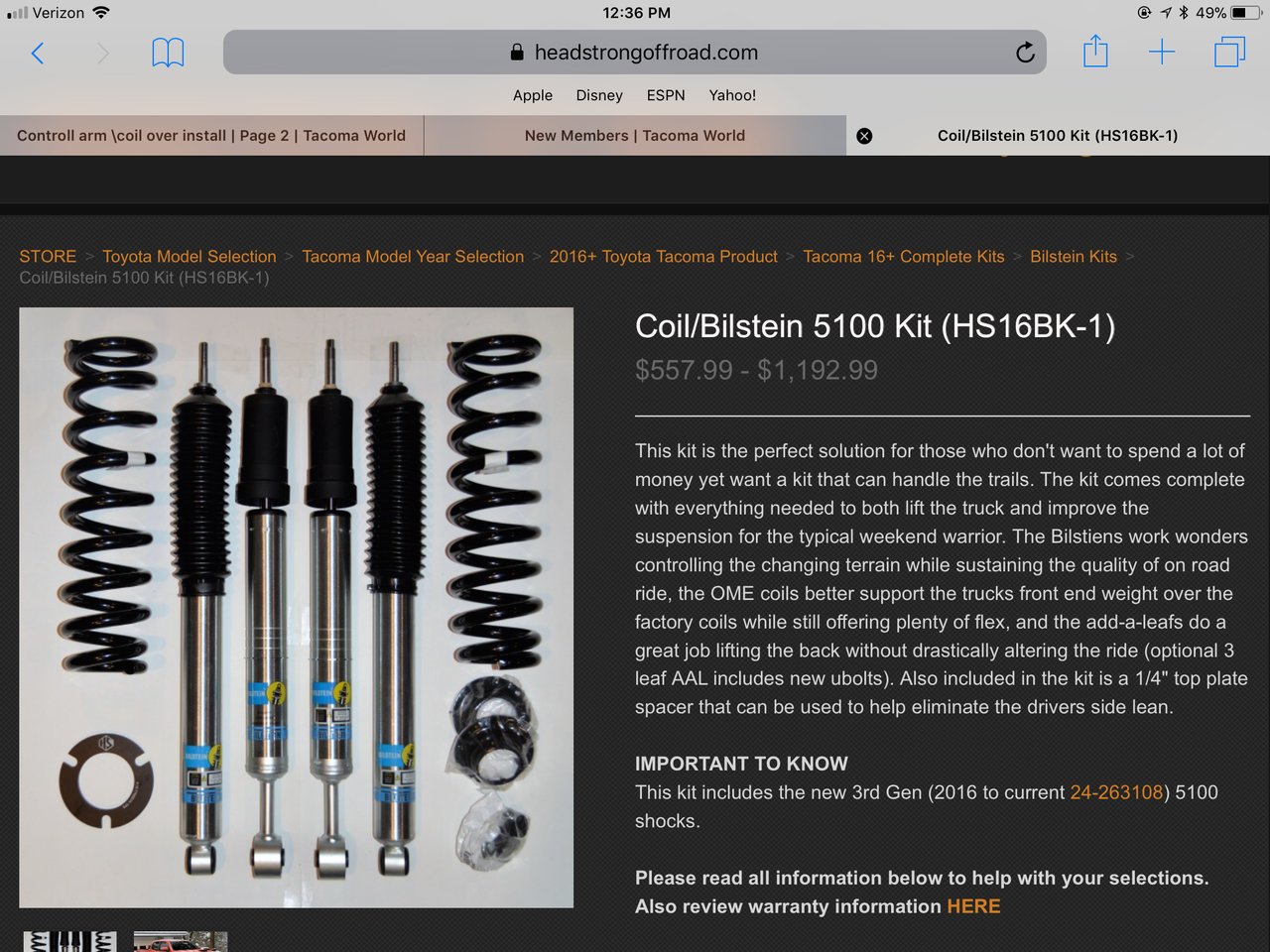

    Bilstein coil over kit from headstrong add a leaf in rear new upper control arms

    6112/5160?

    Nice! I really want to get the 8112/8100 set up. Just haven’t heard enough reviews on them.
