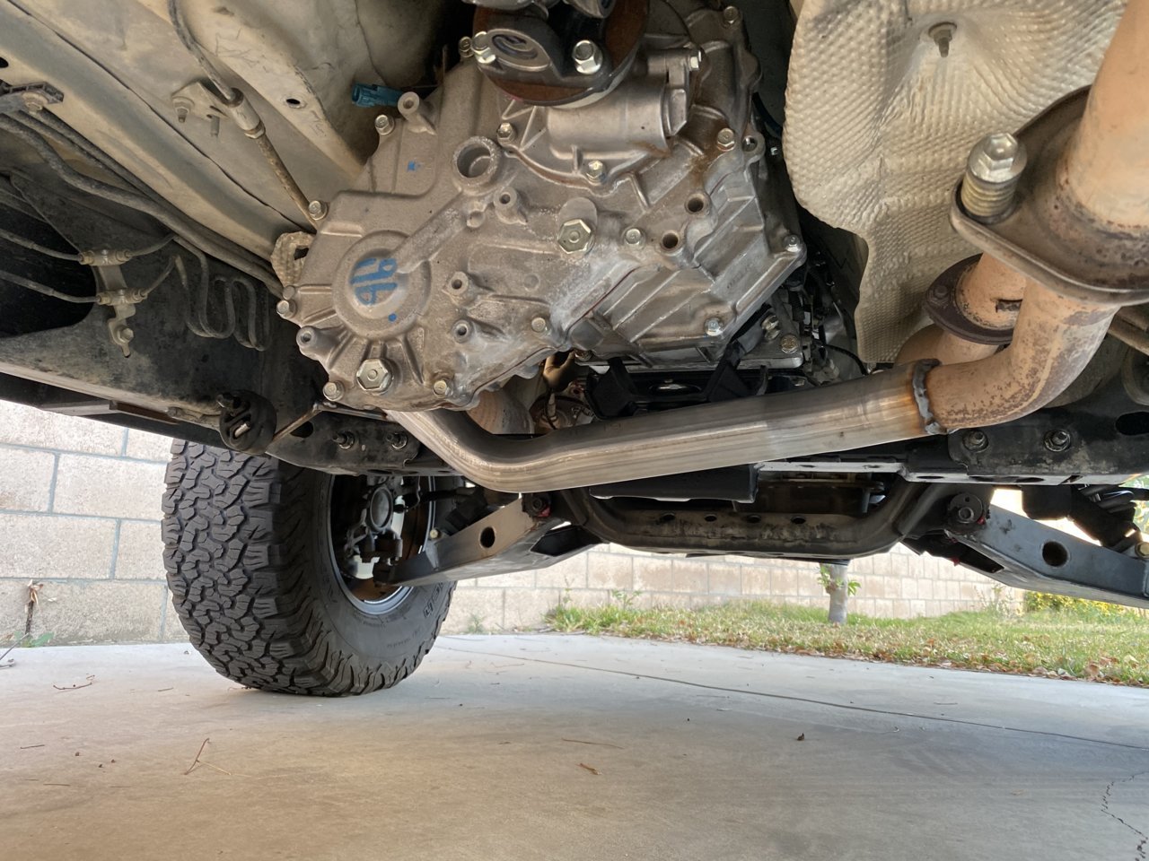

    I’m in the middle of my conversion
    I got lucky and found the inchworm spacer with rear tranny tail end and mount last year here on tw so I used my stock transmission that way and added the fj tcase about 3 weeks ago
    I’ll finish buying the rest I need for the front once this pandemic is over
    I’m doing it all myself and it is a bit of a pain but doable
    I know a couple people would rather pay to get it done or just buy a 4x4 but I’ve spent too much money on this truck already
    I’d suggest looking on eBay for a transfercase (got mine for $250 shipped to me)
    Lower mileage too
    Mines from a 2012 4runner SR5 (early model 5th gens 10-12 sr5s came with manual tcase) all 10-20 trd offroad or trail 4runners come with manual tcase so not just the fjs
