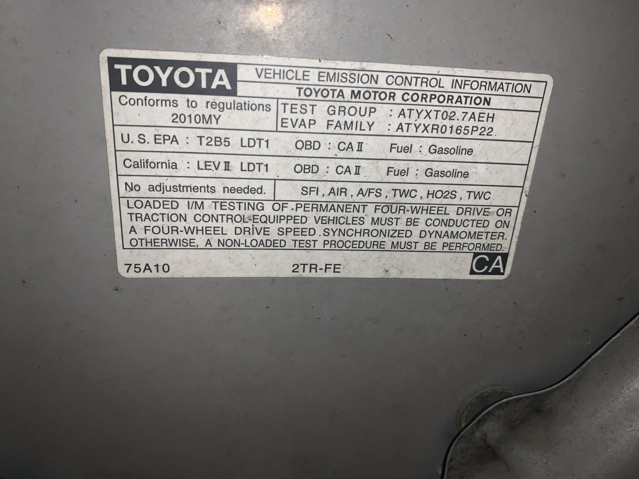

    I know about cars from the 1970s and 1980s, but OBD2 was mandated in all passenger vehicles for MY1996, with heavy-duty trucks (2500/3500) being subjected to that in 1998-1999; I once met a guy with a gas-powered 1997 F250 that was OBD1...
    Anyway, I think that California-specific emissions systems became all but obsolete in 1996, with the introduction of OBD2. This is the emissions control sticker under the hood of my 2010 Taco...
