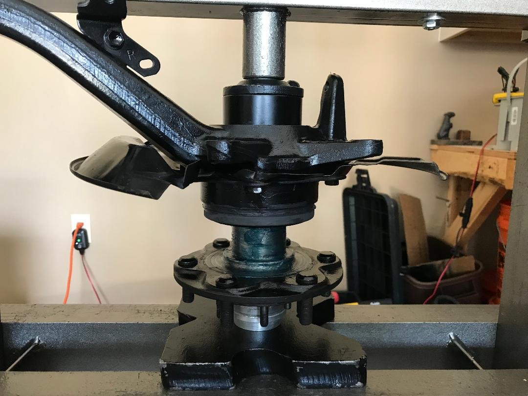

    2 years is WAY too soon IMO. There is another possibility for the early failure of your FWBs. Unfortunately, I think there are a lot of shops that are not pressing the FWBs correctly. If the bearing cone is not supported correctly while pressing the hub in, the bearing can be damaged which can definitely shorten its life. I threw in the towel and press my own FWBs now. And the bearing cone is supported correctly when pressed (below). The last shop that pressed my FWBs bearings in backwards was a full-time auto repair shop that has been operating for decades. They should have known how to do it. Lacking that, all they had to do was press the FWBs in the same orientation as they came out. Very sad work on their part.
    The sleeve under the ram is resting directly on the bearing cone which supports it as the hub is pressed in. Pressing the hub in without correctly supporting the bearing cone can damage the cage or even release all the ball bearings:

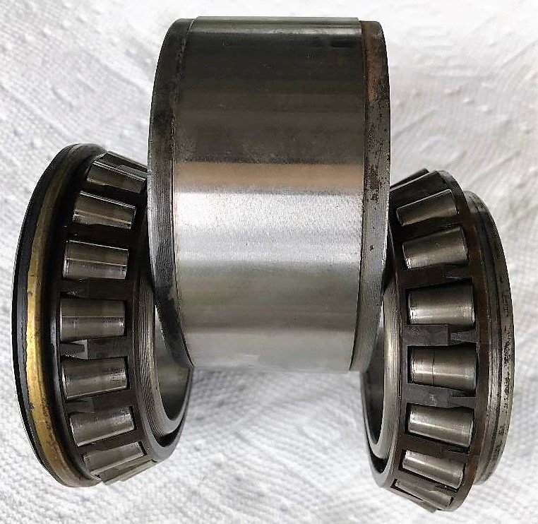

    Just for reference, below are the internals of a KOYO DU5496-5 FWB. When the bearing is pressed in backwards and the axle nut/hub nut is torqued to spec, all you are really doing is distorting the metal shield/seal towards the bearing cone underneath. At 203 ft./lbs. of torque on my hub nut, the shield was distorting inward just enough to limit the movement of the bearing cone underneath it. But no actual preload of the bearing was taking place. The only "preload" on the bearing was the residual load from pressing the bearing. And it opened up a little bit every time I hit a pothole until there was significant play due to zero preload on the bearing. I probably had 1/2" or so side-to-side play in both front tires after 2-3 years.
    Outer bearing cone with integral metal shield/seal is on the left. The inner bearing cone on the right has no integral metal shield/seal. But a separate large black seal fits onto the inner bearing cone.

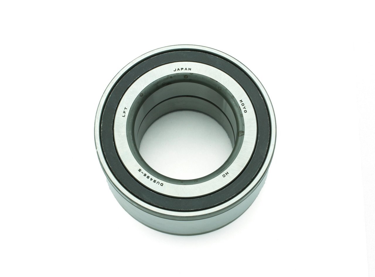

    This is the correct bearing configuration with the metal shield/seal facing toward the hub, outside of the knuckle. You should be looking at this bearing orientation when the hub is pressed into it.
    This is the inner side of the bearing with the large black seal. If you are looking at this side of the FWB when you go to press the hub in, the bearing has been pressed into the knuckle BACKWARDS! When everything is fully assembled, it is very hard to see enough detail of the bearing to identify an orientation problem. And everything will appear to have been assembled correctly right up until your front tires start getting play in them. Unfortunately, several of us already have this T shirt. So do it right the first time or just have a pro like zippsub9 do it for you: For Sale: 4x4 Manual Hubs, Spindles, Knuckles and CVs | Tacoma World.
