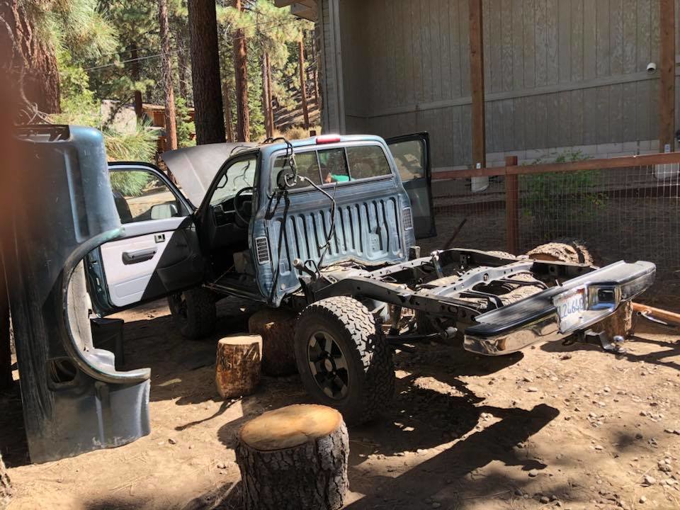

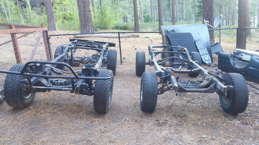

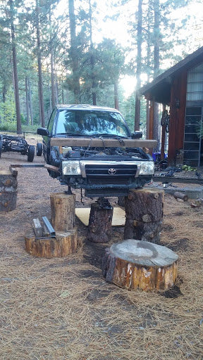

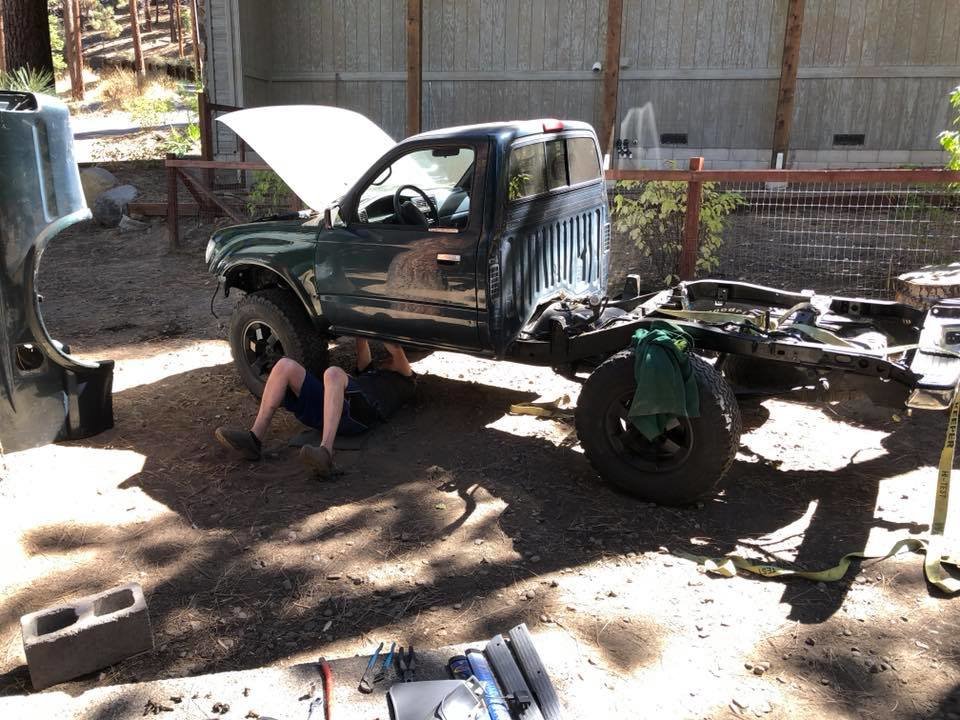

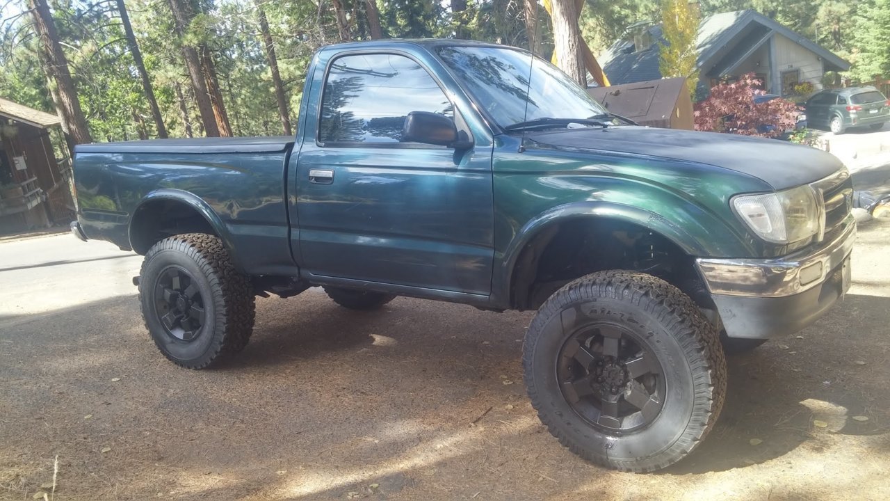

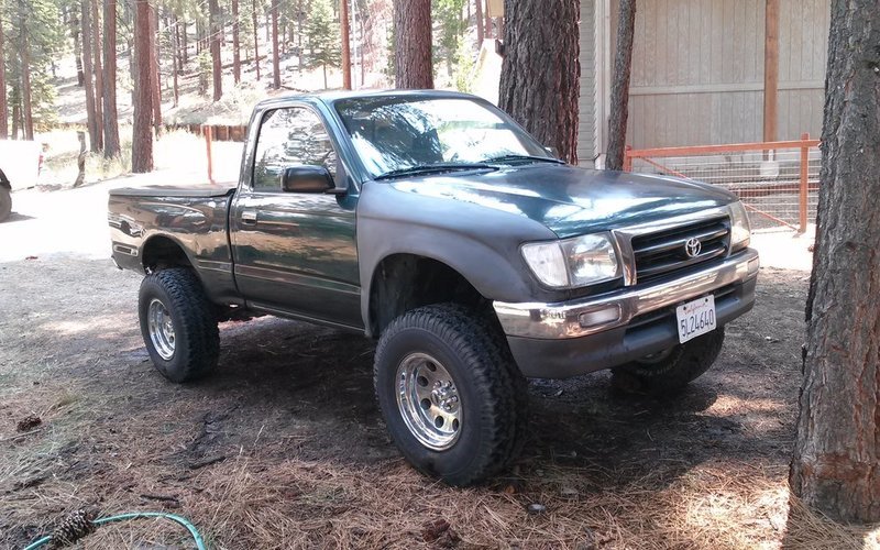

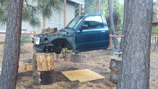

    So a small list of what you need. It took me about to do the frame swap in my driveway. find a rolled truck with a good frame to use as a parts truck. it will make your life a lot easier
    Frame- 2.7 frame if you have a 2.4 or v6 if you have v6, also match up auto or manual trans,
    Rear axle
    4x4 trans with tcase
    Rear drive shaft
    Steering rack
    Steering linkage
    Full front suspension
    Front diff
    Front cv axles
    2.7 4x4 oil pan
    Manuel hubs
    Skid plates
    Wheels
    Rear axle
    E brake rear half of cable
    Exhaust from cat back
    4x4 Shiftier bezel
    Front drive shaft
    9167955896090536251.jpg 4765481538574224584.jpg 2018-10-26.jpg 42848606_2273025582725107_8939070512101851136_n.jpg 42699650_2273026419391690_2293650370154463232_n.jpg 42796041_2273026359391696_8145972292287987712_n.jpg download_20181007_112253.jpg
