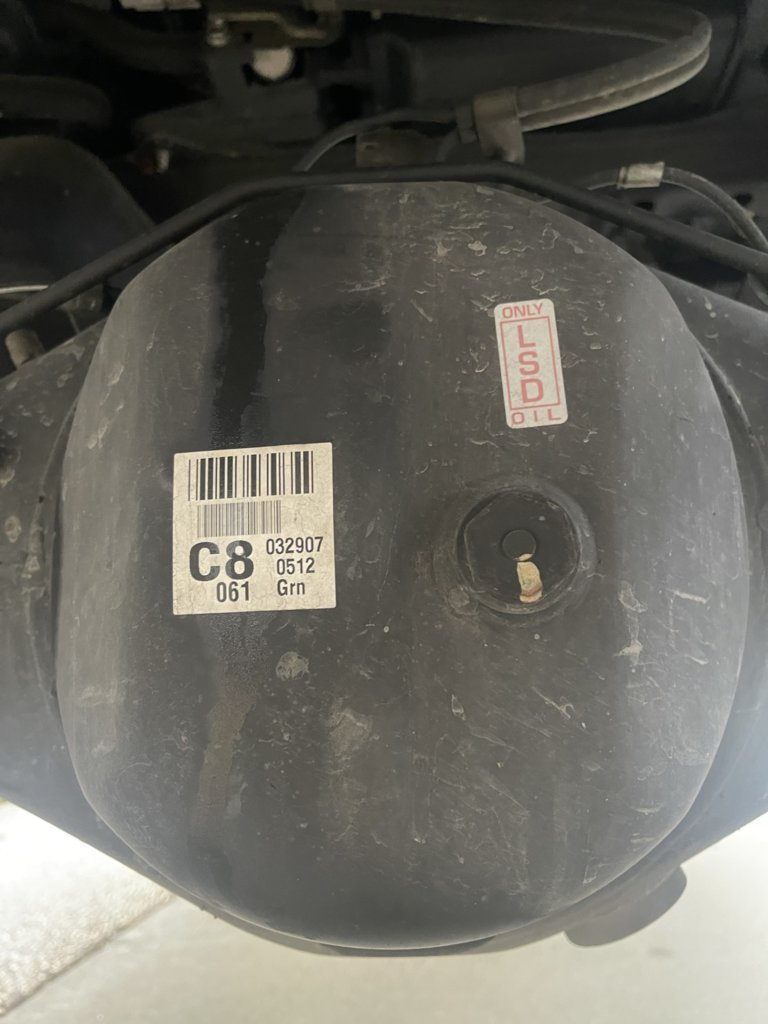

  19. Dec 25, 2024 at 8:43 AM
    #39
    Yoco07
    Yoco07 [OP] Well-Known Member
    Jan 10, 2013
    #94919
    105
    Yes, my truck is indeed equipped with an LSD, as shown in the picture. Given that it’s an LSD differential, can I assume it has an 8.4" diameter ring gear?
  20. Dec 25, 2024 at 12:02 PM
    #40
    TacoTuesday1
    TacoTuesday1 Well-Known Member
    Jun 19, 2019
    #296781
    7,792
    SD CA
    8.4 is what it’s called when it has a stronger carrier with the girdle handle looking thing. Which is what you have.
