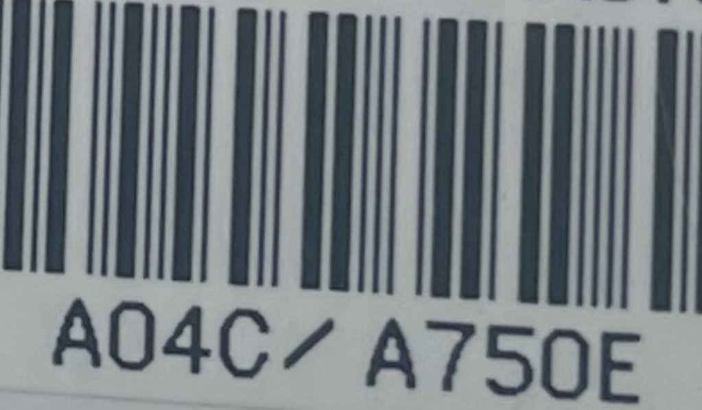

    OP, the axle code for my son’s ‘06 TRD Sport (which has the factory clutch LSD replaced with Trutrac) is code ‘A04C’. It had (still has) the vertical LSD sticker on it matching an earlier post. Again, the Trutrac is fantastic in the real world if you decide to go for it.
    You can find the axle code along the bottom row to the left of the transmission code (A750F).

    You can find this on the door jam sticker also. The code A04C stands for LSD?

    Yes the C denotres it has the lsd
