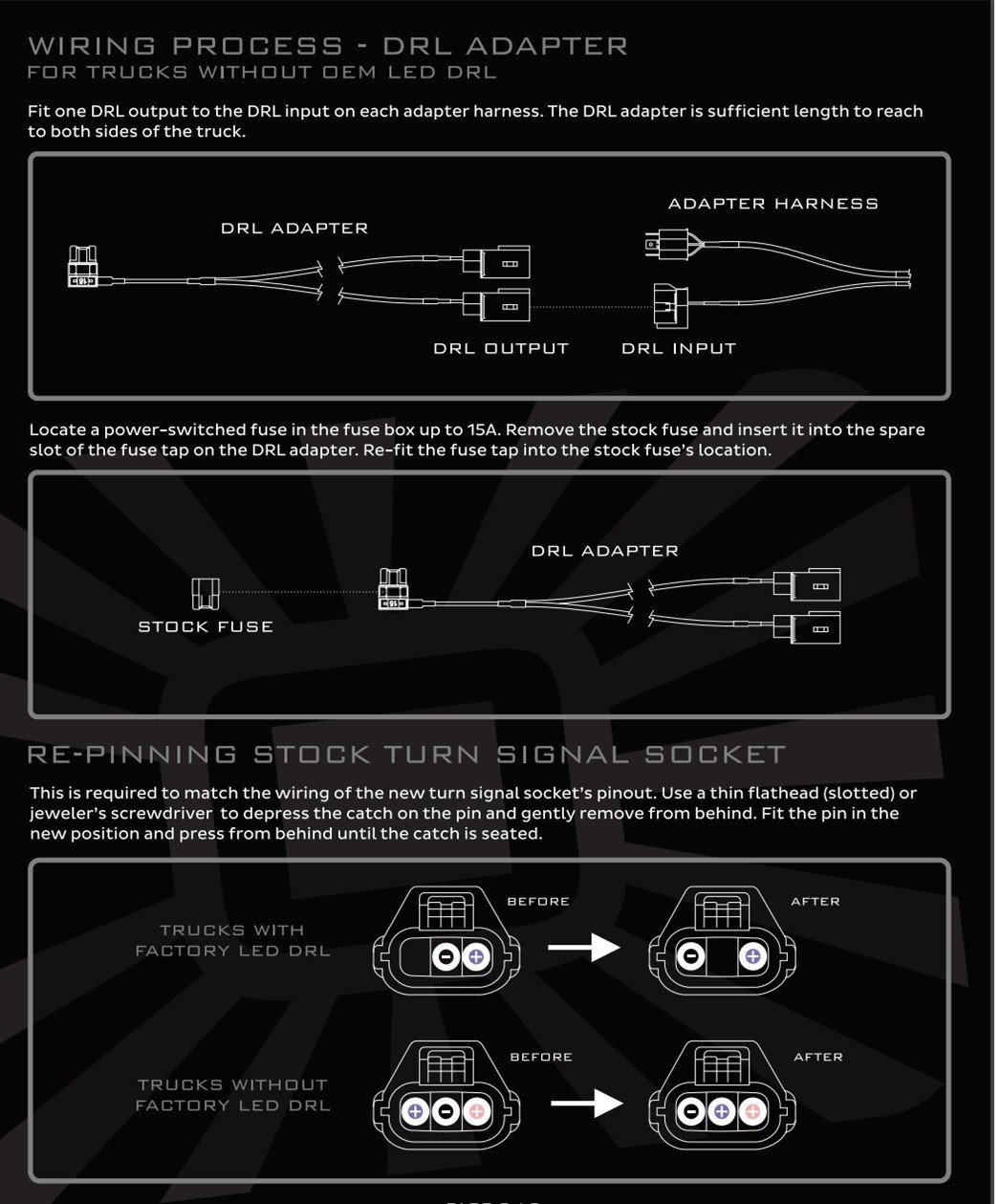

    Check this out, this is the diagram use by TRS for the Tundra, if you notice on the non-DRL version the you have to swap the connections. I wonder why nobody has come up with something of the sort for the SR/SR5
    I'm trying to find the logic in the halogen DRL where the connection is factory +/-/+ and the required for their harness to work is -/+/+ and this last version resembles the connection I have in my Tacoma.

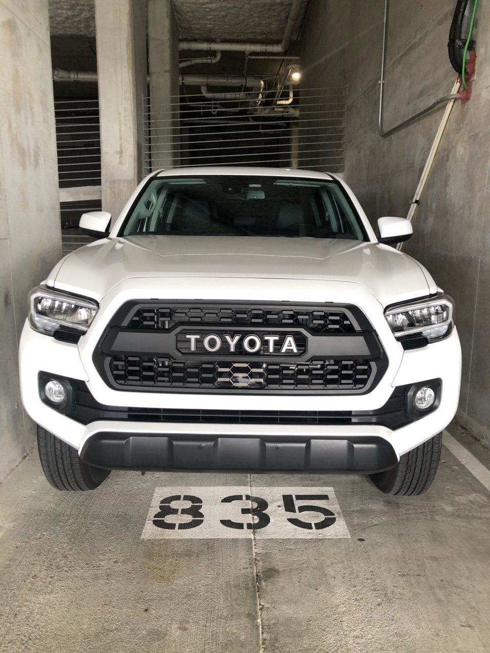

    Hi, the reason is simple I usually try to mod my Toyota's with genuine toyota parts, with that being said buying the stock 2020 led headlights was a no brainer for me. The problem is that I did not do my research and did not know that these were not P&P and to me these look way better than the Alpharex and the Morimoto's. Plus my 2020 Tacoma deserved proper 2020 LED headlights.
    Alpharex I didn't like simply because it has the lettering on the housing which looks cheesy and the Morimoto XB's had one issue for me and it is the angel eye on the four bulbs, I've had these type of aftermarket headlights and the light output and pattern is not the best, no experience with Morimoto so owners might prove me wrong.
    If you hang in there I'm trying to find a solution to this and once I get it whether its doing it myself or with someone's help we'll try to come up with a solution because it can't be impossible.
    Gotta love the look, I also installed the TRD PRO grille.

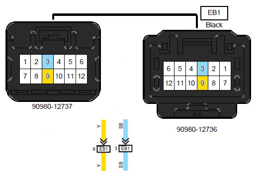

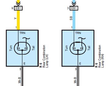

    OP, there is a solution. Instead of using the front turn/drl signal wire for the LED headlamps, tap the rear turn signals. You will still need the MESO's solution for the DRL.

    Interesting, so I would actually just use the ground wire from the factory connector, tap into the rear signals (left with left and right with right) and then run a single tap from the ignition fuse that would then convert into two cables one for each side directly into the harness that plugs into the new headlights.
    Seems pretty straight forward. I'll try this once I receive my harness
