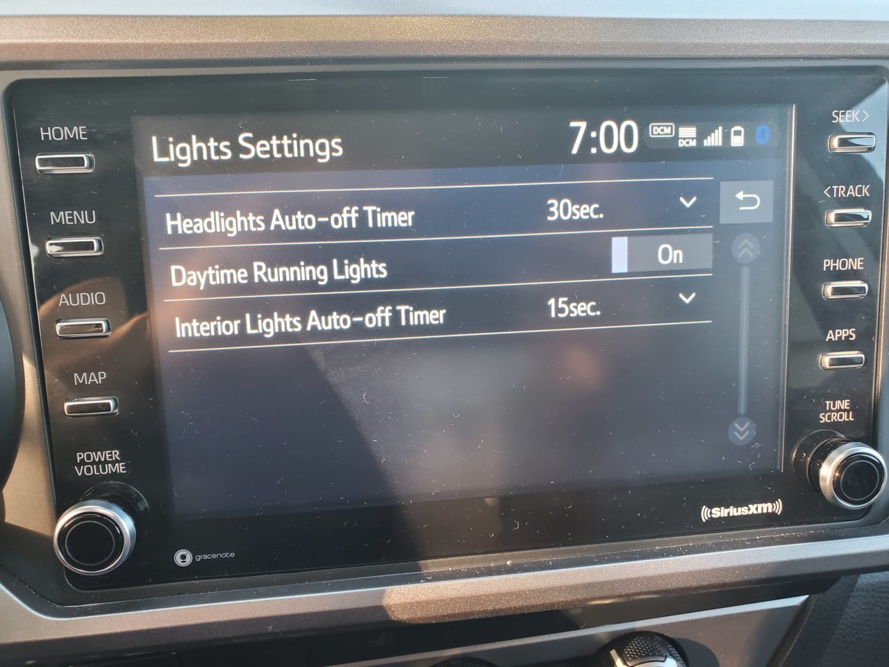

    Would you post a screen shot of that?
  6. Jul 8, 2020 at 5:04 PM
    #86
    Tacospike
    Nov 19, 2018
    #273198
    14,419
    512
    Two Trucks
    It’s in the head unit customization setting. The DRL still come one when you turn on your headlights as the dim function. They don’t completely turn off with the headlights on

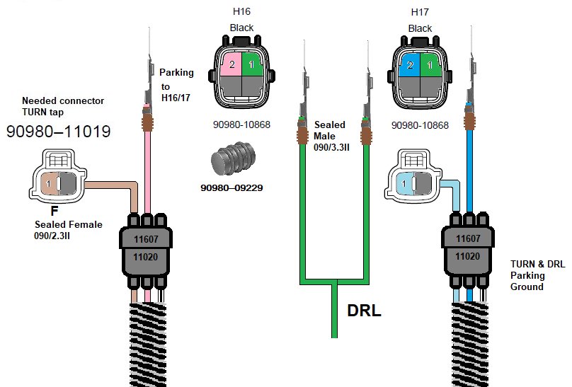

    The "difference" is the intensity of the incandescent bulb. It has 2 filaments. The TURN & DRL are the same filament (High) the other is for the Parking/Tail.(Dim)
    Selecting DRL OFF, cuts the ON feature of the HIGH filament at IGN and still gets to function as TURN.
    After headlights are selected, the incandescent bulb is lit dim by the parking/tail circuit with the LOW filament. TURN still uses high with headlight selected.
    In the other models selecting Headlamps turns off the ground to the LED DRL relay but DRL also still has the Parking/Tail illumination input to the DRL(DIM)

    So, for those with SR5, there would be NO NEED to tap the rear turn signals, since the DRL function can be disabled by the Infotainment menu. Not so for the SR. Unless, somehow, they get the same head unit and works properly. I don't have any info on what production model gets what, especially SR & SR5 and their selling region or country.

    The info on having the DRL OFF via head unit app was unknown at the time.

    If I had an SR or SR5, and money for the LED headlamps, I'd just snip all connectors and crimp the MX150 connector and terminals. Then I'd assemble the opposite harness, one going to the original headlamps, since I'd have all the required connectors. I don't think I'd replace the LED with another set if they get damaged by a shopping cart at the mall.:D
