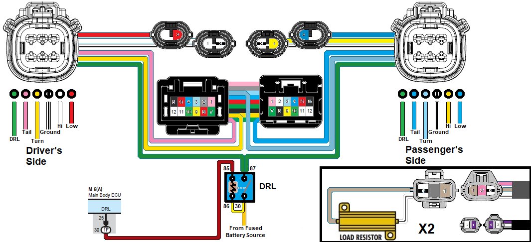

    I own a 2020 SR and I’m hoping you completed that harness! Please lmk if you have found a solution!

    Hood Struts, My version Fogs always ON, Map & Overhead Light Mod,
    DRL wire (red) can be the only one from cab to engine bay.
    Sliding Roof fuse may be used if relay left inside cab.
    No delays to switch ON for DRL's or Turn signals. Light stalk keeps function.

    Same here, please let us know!
