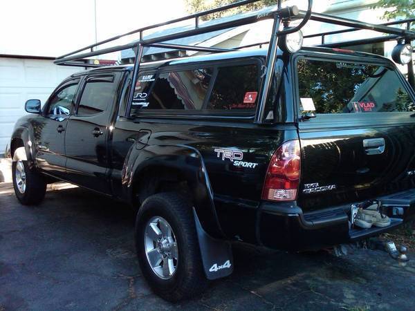

    HID's? Really, how much brighter do you need, I got 2X130 watts in my KC's and jesus, they are plenty bright. I can see clearly behind me even with the tinted windows rolled up. To each his own but it seems a little unnecessary to me
    Mine are mounted at the top of my rack
