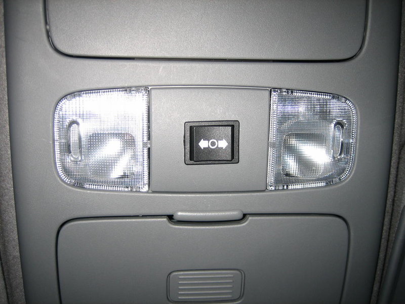

    I completed this mod last weekend and couldn't be happier with it. It was reasonably inexpensive, easy to do and best of all it accomplished my objective of actually being able to use the sliding rear window I could never reach while I was driving. Here is a picture of where I decided to mount my switch. Hope I'm doing this right, I've never posted a picture. Thanks to EngineerIt for a great idea!!!

    No, didn't figure out the latch removal...yet. I do want to mention however, that if anyone else is considering this mod they should use the non-momentary switch that Firgelli Automations offers. I got the momentary switch as I did not realize they sell 2 different switches. The reason I say this is because it takes 8 seconds for the window to fully open/close and your finger needs to stay on the momentary switch for that length of time. The actuator has built in limit switches so it automatically shuts off when fully open and when fully closed and if you wanted to stop it anywhere along the way you can just move the button to the middle position. The non-momentary switch (part# MAN-RS) is definitely the way to go.

    Hey great idea on the non-momentary switch (part# MAN-RS). I wasn't really sure how that would play into my original install, but I believe you are correct. I know 8 seconds seems like a long time while you are holding down that switch. I think I will buy one and change mine. I have had zero issues with this set-up since I have installed it; I hope everybody else that does this mod has the same results.

    I think the "sustaining" switch would just make your mod an even better idea than it already is. I love this thing and I would never have thought it up myself. I can't believe just how difficult it was to reach back there. I've only owned regular cab pickups until now and without power that window is pretty useless. One morning before the mod I thought I had it all figured out, I opened the window as I was getting into the truck to drive to work. I pulled out of the driveway and got out on the road and up to about 40 mph everything was good. Then a minute or two later I look up at the rearview mirror and there is a river of condensation from the roof of the truck pouring in and forming a puddle on the back floor. By the time I dislocated my shoulder to reach back there and close it all of the condensation had already entered the cab and that was the end of my bright idea. So thanks again, I think this is one of the best mods on "the list".

    Pulling an older post here, but I had a question. You said you moved the FA switch to the blanks by the radio, but what modifications did you make so that it would fit? I am attempting to do the same thing but want as few cuts/permanent mods as possible.
    The switch itself is just a bit wider than the blank opening. I assume that you trimmed the sides of the blank opening, but did you also trim the sides of the switch so that it fit all the way in? Any pics?

    Yes I moved the switch to one of the blanks below the radio. If I remember correctly I trimmed a little off the switch and from the blank opening. I will send you a picture as soon as I get back home on 11th of November.

    Just got this done this weekend. I still need to trim some more to get the switch mounted right (switch blanks under the radio). I didn't take pics as it looks exactly like the OPs, except for switch location. A few notes that I took (some new, some not):
    o it is noisier then I thought, even though the OP warned on it. My two boys laugh when I open or close it as it sounds like a cheap robot toy....
    o I got a chunk of 1/8 alum from Home Depot to make the mounting plate, was $10 and only used a small piece, but it worked well.
    o I painted everything flat black except for the bottom of the mounting brackets. Didn't think the epoxy would hold the painted bracket too well.
    o for the mounting bracket that is screwed/bolted to the mounting plate, be careful with the head size, as I had to remove the front screw since it wouldn't allow the actuator to come down fully level.
    o as stated it uses very little current. I used some left-over garage door sensor wire that I had laying around. It's a thin single strand wire, double wire, so it was stiffer than multi-strand and made it easier to route through the panels and floor channels.
    Thanks to the OP for this.
