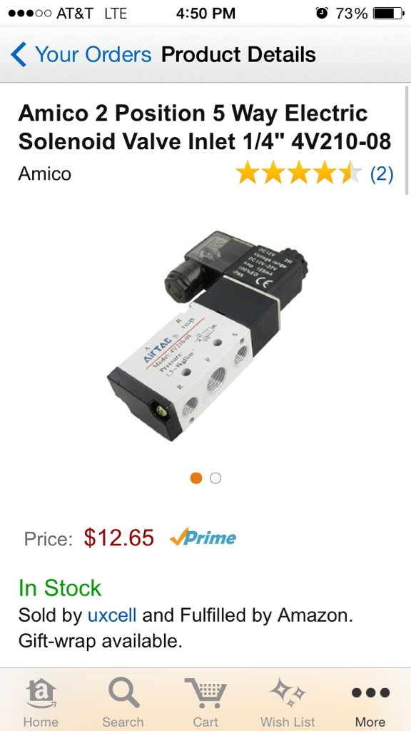

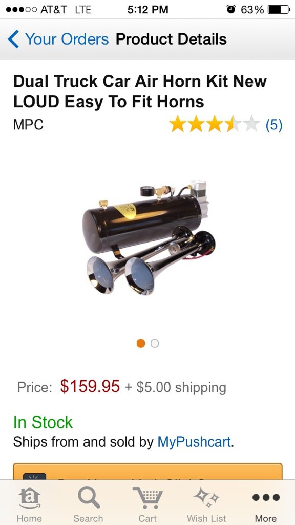

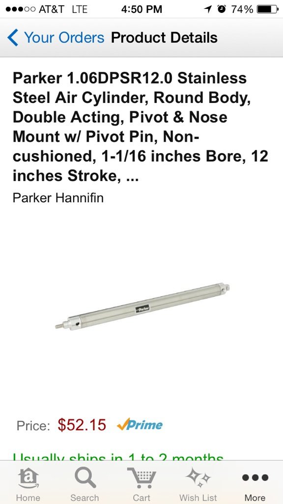

    I am going to try this mod as well, just bought the following:
    heqaru8e_953c222f49f9b5e387b7c650209ec8826529cebf.jpgenesavu3_f92c99878a98134a6cbcac1b8f131a09eed2e320.jpg
    I'll post Picts and a write up when I'm done.

    2013 Tacoma Double Cab 4x4
    what are you planning on using for a compressed air source?
    that seems to be the track you're taking here, yes?

    Wanted this since I was a kid anyway! I plan to use the compressed air source for air mattresses, cleaning/detailing the interior... Who knows what else. (Honking at prostitutes)

    I wonder if a paintball gun CO2 canister would work, and if so, for how long?
    I know guys that use CO2 to power their ARB air lockers.

    Good thought.

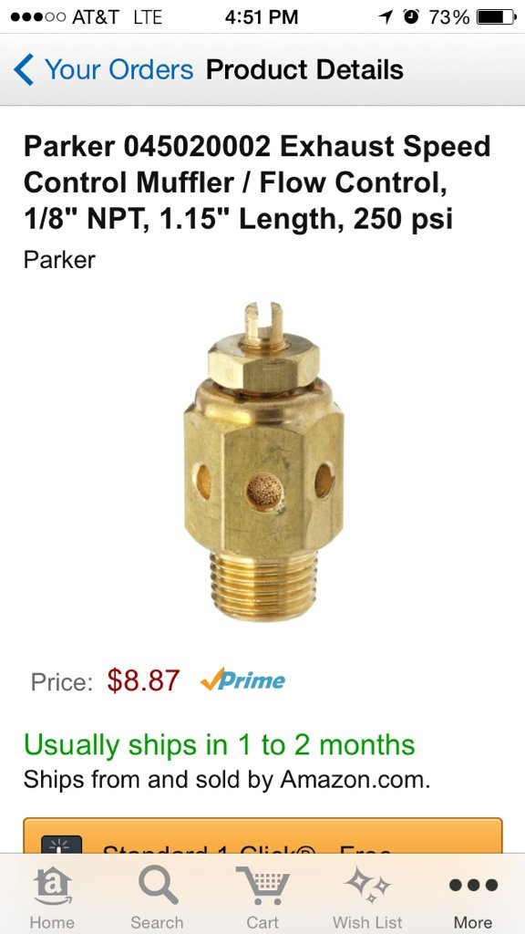

    If a compressor is used just for the rear window, IMHO it's a waste of equipment. YMMV. ;)
    I aslo would think the window would quickly slam open and closed using air.... unless adjusted (if capable) at both valves for slower release pressure.

    I got these to adjust the speed and prevent a slam shut.
    Several other components as well. There are dampened cylinders, but I went with the muffler. You guys can expect to see a full write up by the weekend.

    ... On second thought, might be a while. I just noticed that it doesn't ship very fast!! One or two months?!?!
