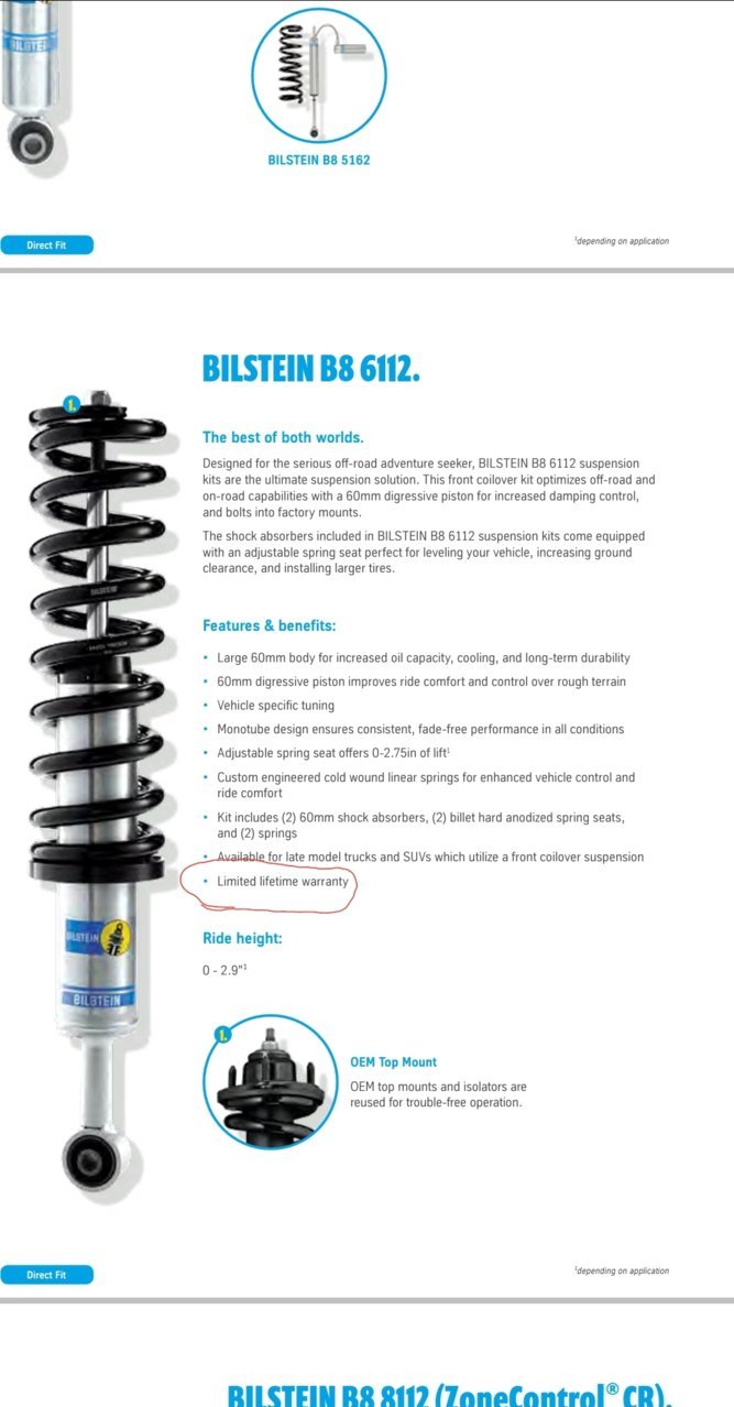

    Not true. I have the 2020 bilstein catalog and warranty paper with mine to prove it in writing. The warranty will be voided only if the are modified with any other coil that is not supposed to be put on it.

    5160's do not have a lifetime warranty but the 6112's do.
    71tattooguy likes this.

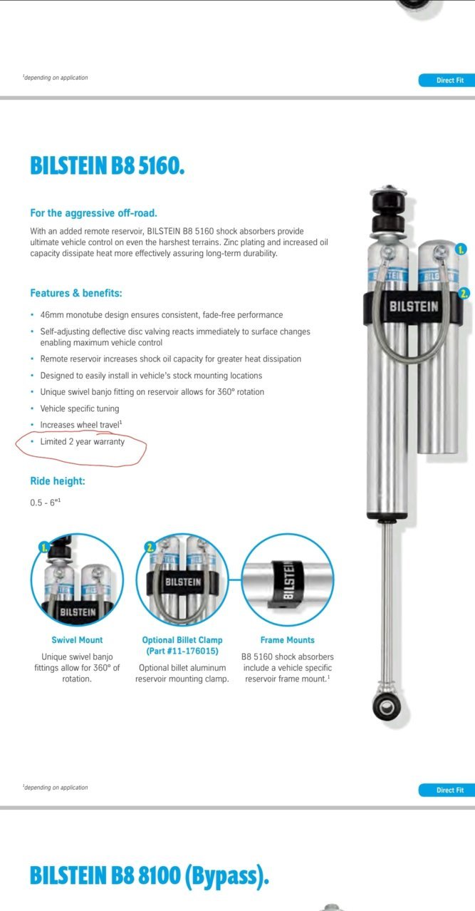

    Maybe it's just the 5160s then? When they leaked i contacted headstrong and they said it was a limited 90 day from bilstein. I was just happy to get them replaced. Obviously an inconvenience since I had to go get the new shock, remove and replace then go back to drop off the old shock.

    Actually the 5160's have a 2 year warranty.

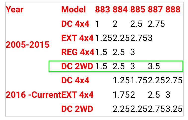

    awesome explanation and thanks so much! but you missed the 884's tho ! :) jk those are the ones i'm interested in tho. pic below from Headstrong and some other sources this is what I can expect (2.5") from my double cab 2WD right? I guess the 4WD's just weigh more ?

    Yes the 4wd's do weight more in the front with the front differentials, cv axles and etc. So you would be getting about 2.5 inches after it fully settles in about 2 weeks without any armor or other weight.
