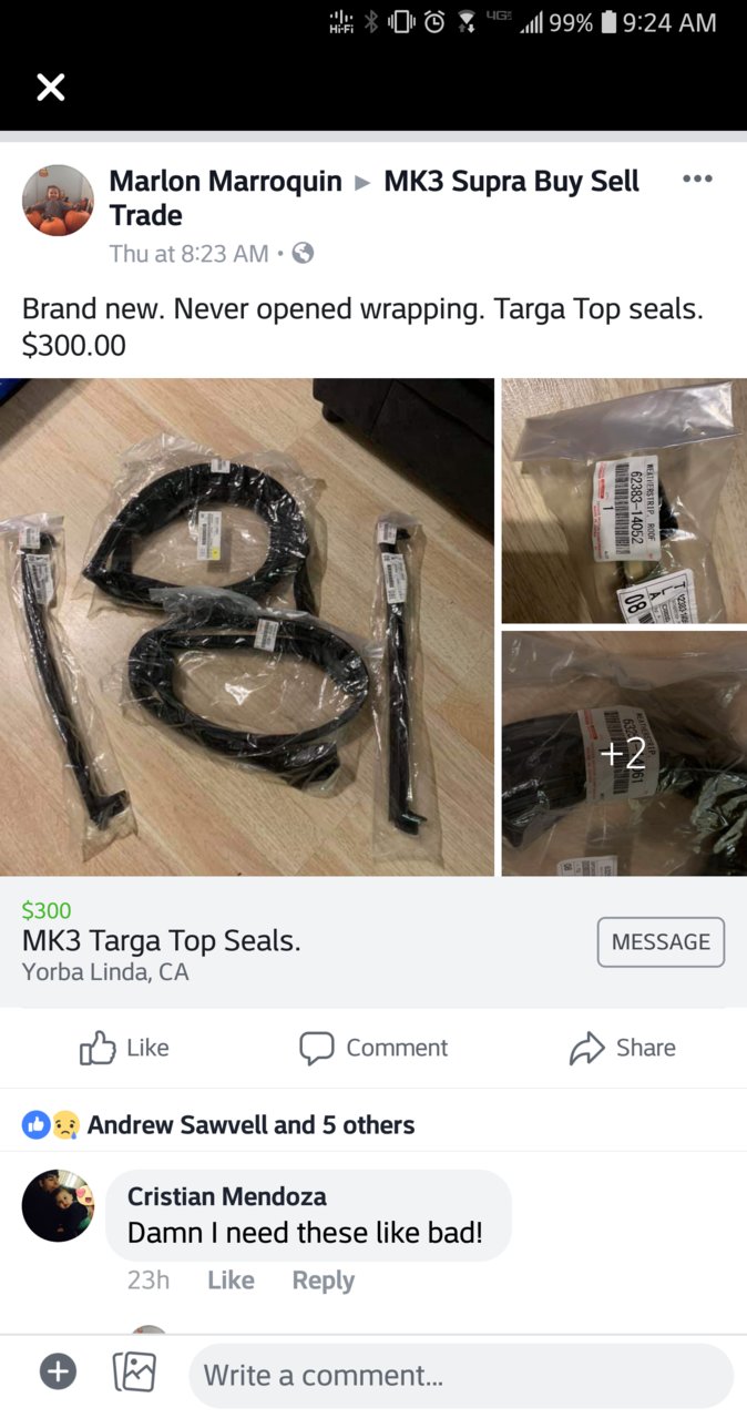

    Someone on one of the Facebook groups was selling a set of brand new in the bag targa seals. Not cheap but they may be discontinued from Toyota.

    Saw that ha. I think since it's cold the seals just shrunk a bit because it was fine until about November really. And it's not a bad leak just drips down into the drip rail thing
