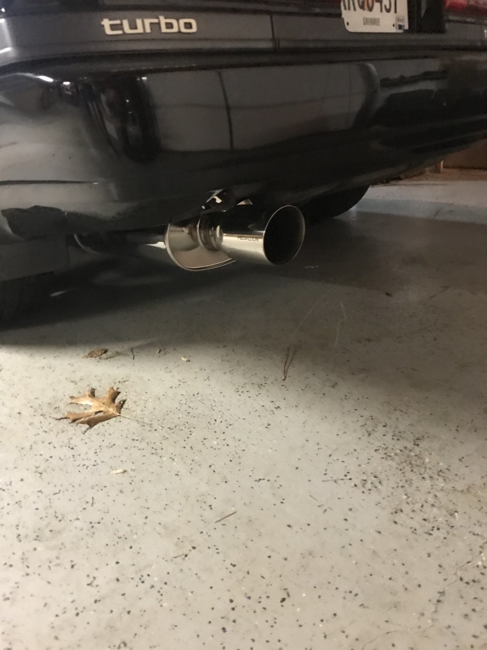

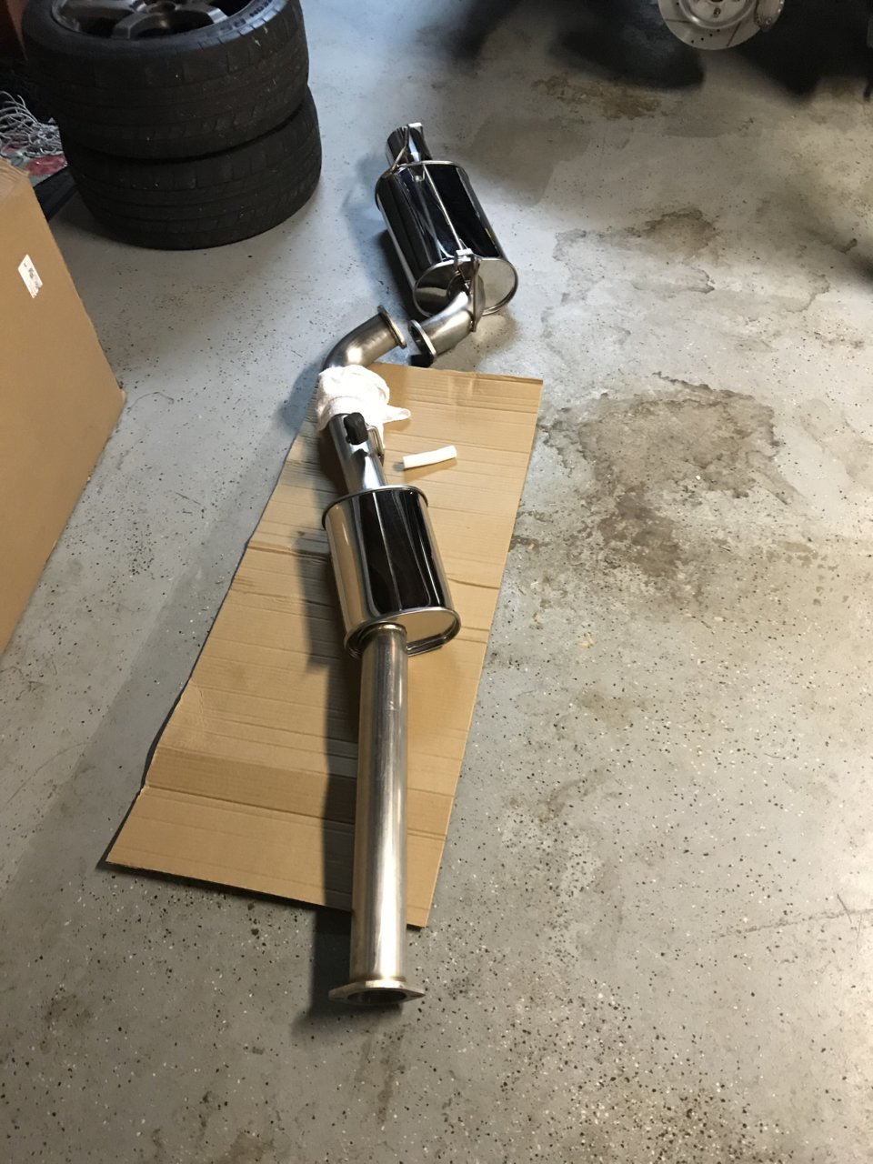

    But here's some pics of the exhaust, no sound clip but it's nice and quiet still, drones a little around 2k rpm in 5th so I just go faster or downshift and it's fine. Only complaint is that now there's no cat it produces a nice odor (not surprising obviously) but sitting in traffic kinda sucks unless there is wind and parking the garage leaves the house smelling for a little. I'll be looking into a high flowing cat sometime next year.
