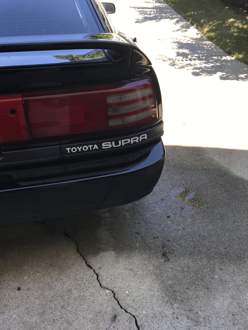

    Changed my oil today! Holy fuck is it a bigger PITA than the truck. May actually go to my buddies next time and use his lift. Would probably take just as long. Ah well not for another 3.5k miles
    Also finished up painting my “emblem”
    Hope to be getting some interior pieces the next few weeks as well as the AC fixed in 2 weeks as I have an off day coming up

    I always end up spilling oil everywhere trying to snake the filter out.
    What kind of paint did you use? I was thinking of just getting a white touch up paint pen with the brush when I do mine. Yours came out great!

    I actually couldn’t get the filter out it was too tight. So I’m going to buy a cheap tool just this once to get it out. I just used the “scratch” paint pen that Autozone sells. Figured it was easier to mess with.
    Also it seems that the car is idling super high now that the oil has been changed. Anywhere from 2.5-3k RPMs. Idk why it’s acting so damn weird now. I’m pretty sure I didn’t hit any vacuum tubes or anything. Any ideas would be super helpful :pray:

    Are you sure you didn't bump any of the vacuum lines near the power steering pump when trying to get the filter out? There's an idle up valve there for the power steering. Also, check your throttle linkage above the valve covers. There are some plastic bushing that can get worn or linkage could get gunked up and stick. I had a bushing on my linkage fail and when I started the car up, I pushed the accelerator and it went straight to the floor and wouldn't retract. Scared the crap outta me as it bounced off the rev limiter as soon as I turned it on.
