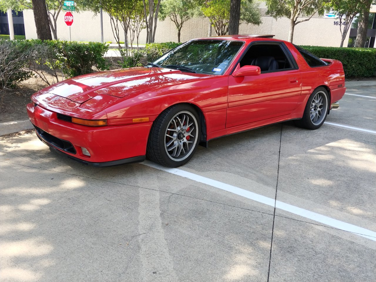

    What are your guys opinion on rim sizes? I don’t want it to be slammed, I’d rather get 17s but on the forums a lot of people have 18s.
    Also what are the other specs that’d I’d be looking for

    Do you want a staggered or square setup? I have 18's but sometimes wish I had 17's because tires are cheaper. They might provide a little bit of a softer ride with the taller sidewall, too. My current setup is 245/40/18 on 18×8.5 +45 in the front and 275/35/18 on 18×9.5 +40 in the rear. I've dropped mine about 2" in front and 1.25" in the back and I think the fitment is pretty good. No rolled or pulled fenders, but i do rub in the front plastic wheel wells when I hit big bumps. I've got a normal alignment, no crazy camber or anything. I like the look of staggered, but you can't do normal tire rotations. I think the widest rim you'd want to run is 9" all around and you might have to roll the front fenders if you went with a 255 or wider

    I'd go 17s, definitely no bigger than 18s.

    Id run 18s as they look awesome. But 17s might be cool. Could always do the 17'' up front and 18s out back. Not too common to do that though.

    That does look really damn good. One big thing is I don't want to have to roll the fenders, rather keep those how they are. Probably won't drop it as I like the ride height. So maybe do the setup you have (different rims as I don't like directly copying people).
    Yeah the only options I'm looking at are 17 or 18.

    If you like the look of your current wheels, you might be able to find some stock wheels off of an MK4 Turbo. Those are 17×8 in the front and 17×9.5 in the rear.
