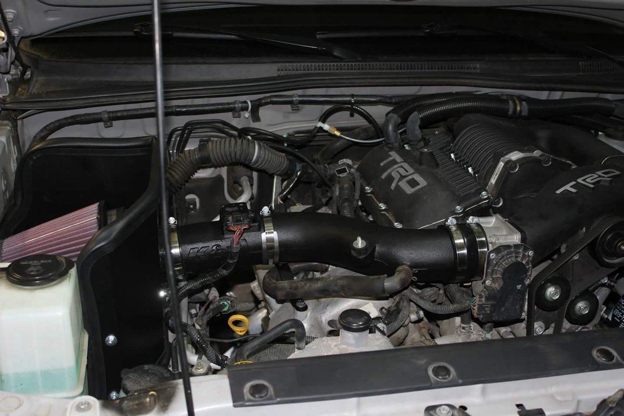

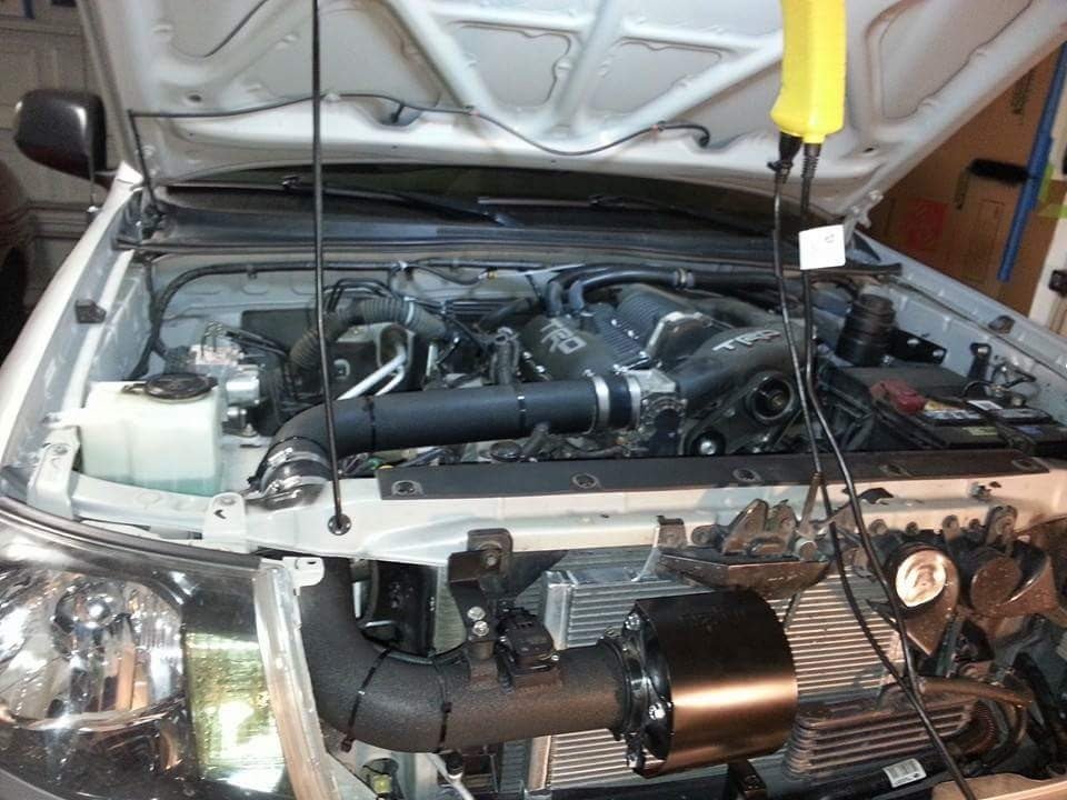

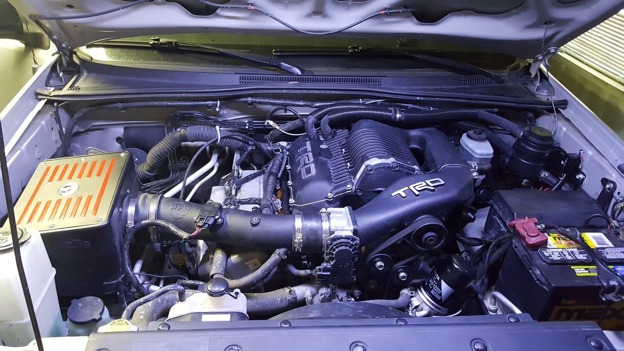

  11. Sep 4, 2017 at 8:47 AM
    #31
    inwood customs
    inwood customs Roaming potato
    Sep 11, 2016
    #197024
    4,712
    Dave
    2006 v6 potato bugTuRD
    K&n, flowmaster, plastidip, chipped, hids, daves
    Ur right... im newb.

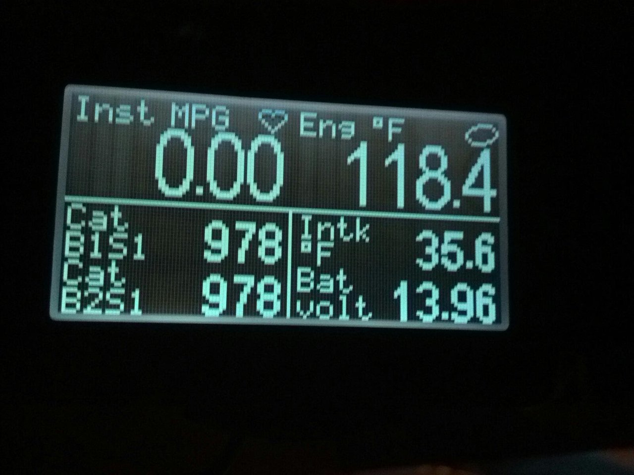

    Not a single clue about intakes or blower or this "adapting"FB_IMG_1464314496513.jpg FB_IMG_1464314518795.jpg 20160608_184458.jpg

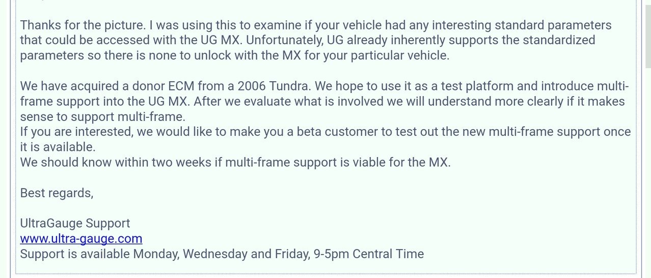

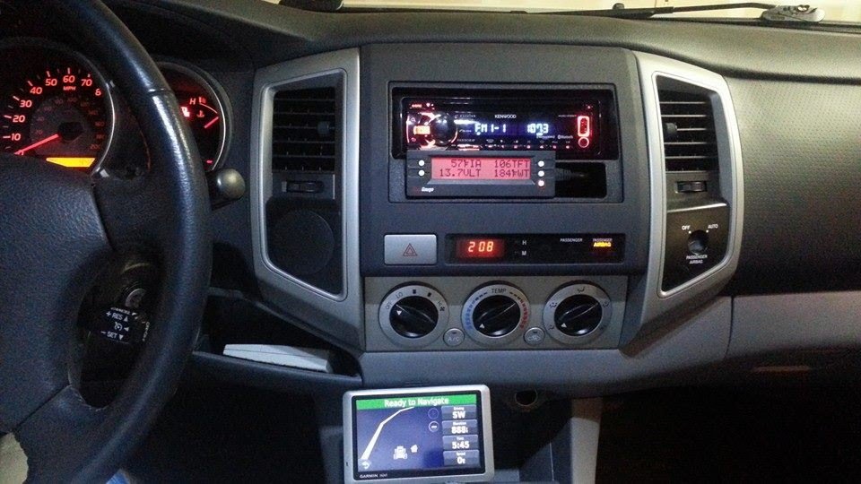

  12. Sep 4, 2017 at 8:50 AM
    #32
    inwood customs
    Sep 11, 2016
    #197024
    4,712
    Dave
    No idea how to check this complicated iat either.
    Pls show us the way
    10173628_759420720749818_494130701_n.jpg 735517_530654556959770_1142966319_o.jpg
