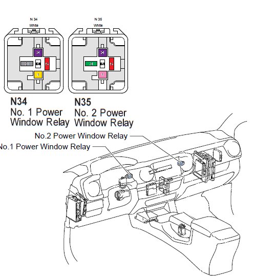

    If you remove the head unit, there's a relay on the passenger side that supplies the proper pink wire:

    That might be a little easier to get to. I just tap in to it like I would at the switch right?

    Correct

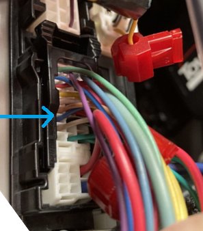

    Would you happen to know were the wire for the horn is located and what wire it is I need to tap in to?

    #26 @ 1F

    Driver side kick panel right?

    Nope, straight back from the cubby panel of the driver's side.

    OP, I have a question. I couldn't find the full install information of the Cool dog gadget. So, my question is: Is the vehicle going to be ON for the system to work?

    Yes, I will turn it on when I get out of the truck and it will be armed. Here is the installation pdf
    If you have any other cool ideas I should do with it let me know. I still have a window down wire free.

    I found an issue. If the vehicle is OFF, there's no juice to the sliding window relays, so providing a ground to the sliding window switch would do nothing.:(
