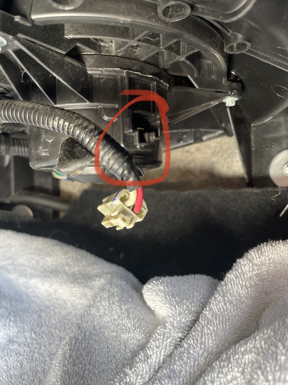

    unplugged this shit and water came out haha

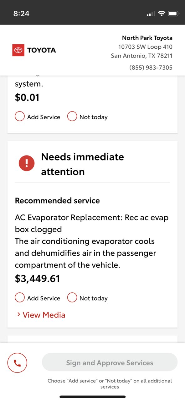

    Update: Diagnosis below.. haven’t heard if extended warranty covers but this price seems ridiculous.5E70199F-AA5C-4F48-BBBE-CDC168C560CD.jpg

    Tech tried to flush but didn’t clear. Extended warranty covers the blower motor but not replacing the evap box(most of the cost).. they offered to try to flush the system again for $90 so going to try that and new blower motor :fingerscrossed:
