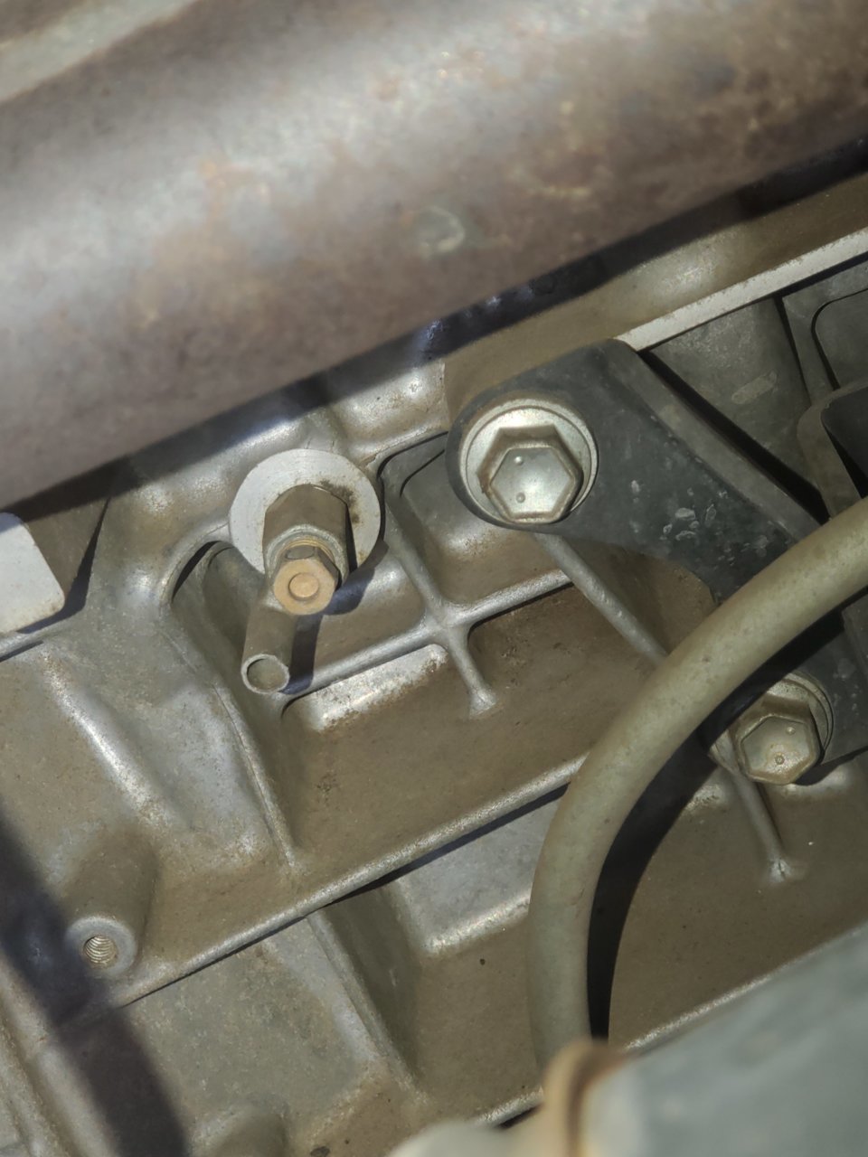

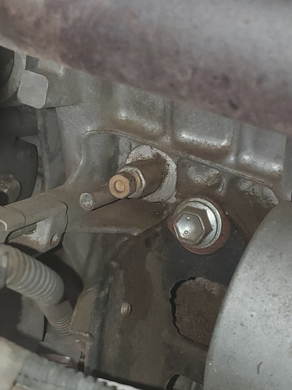

    A 22mm or a 13/16" socket fits the radiators plastic drain petcock, I wouldn't use a socket to give it a final tighten. On each side of the engine is a petcock to drain the block, you only need to loosen the petcocks vs removing them completely. You will not need to remove anything from the inner fenderwells. You do not need to remove the tires. A swivel on the socket and a loooong extension makes it easy to do.
    Passenger side (I had to turn the phone to get it in there for the picture)
    Driver's side (phone turned again, a few inches in front of the starter as you can see the starter on the right side of the picture).

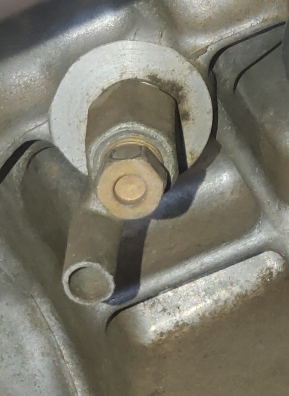

    For clarification, this is the block coolant drain
    You'll be loosening it with a 10mm, not the larger one behind it.
