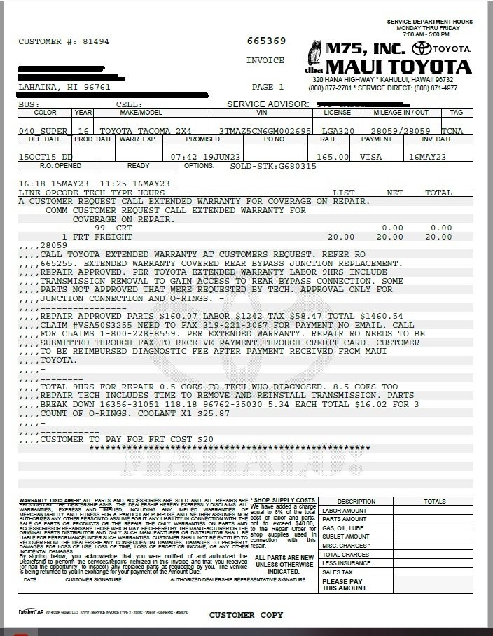

    Tacoma.jpg mine goes in the shop next week. i am surprised to see they remove the transmission to get at it, i thought they removed the top part of the motor. see write up. first time i used the extended warranty that expires in Oct.

    The shop the OP is using pulls the transmission.

    no, replacement is plastic as far as i know. they said the leak occurs at the O rings where it mates to the heads. when i found mine that's where all the pink buildup was.

    Repair complete, truck got trapped at dealer over memorial day weekend, sucked, since i took it in on the tuesday before.
    they also did the 3rd brake light recall.
    i urge anyone with a 16-18 that has not had this issue already addressed to crawl under the passenger side behind the front wheel and shine a flashlight up behind the motor and check. look for pink corrosion
    it was only that someone here brought up this issue about a month ago that got my off my ass and to check mine.

    WOW! Thank goodness for the extended warranty. 9 hours of labor on your 3.5 2WD. I wonder how much more labor on a 3.5 4WD?
