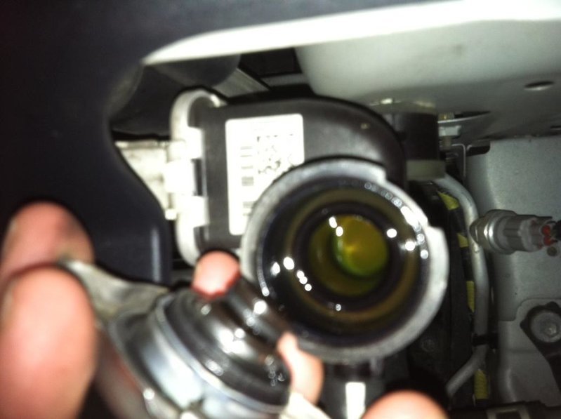

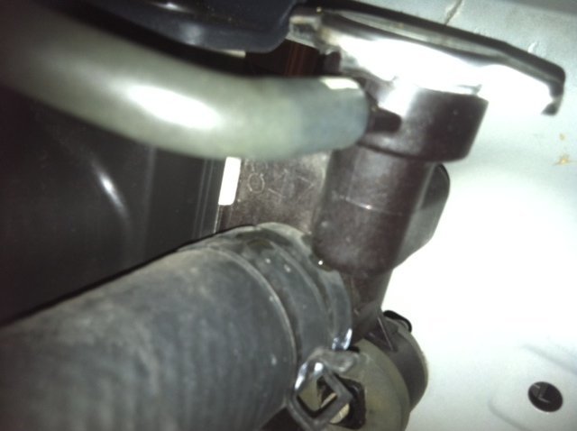

    I bought a 05' DC TRD a couple of weeks ago. Just recently noticed the Coolant level was around "LOW" so I bought some coolant (Prestone-was in a rush) and filled it up yesterday. Drove it about 4 miles today and its already below "LOW" again.....????
    The strange thing is there are no visible leaks that I can see. There is a hose plug seen below where it may be leaking but not that much.
    Will fill back up in AM to try and make it home Nashville (about 145 miles)
    Any ideas or suggestions feel free. Will take back to dealer to try and get this worked out on Friday.

    Interesting. How are your temps?

    Temps were fine, no overheating... thus far..
    Just pulled the radiator cap... Looks like there is fluid in the radiator about 1inch from cap.
    See below...
    You think maybe the fluid was recently flushed and now I'm having to add extra now that it's circulating through engine?
    Thanks guys keep up the ideas.

    Picture of Level of Coolant as of this morning... looks like it went down a little bit more.
    Picture of Radiator cap/w/ coolant under, maybe from taking cap off.
    Picture 3 of oil check.... does that look like chocolate milk?? Can't guage how clean it's suppose to be. It looks fairly clean on the dipstick.
    Help on options:
    A: Take back to dealer in Nashville where i bought and say WTF? (problem is that I have to drive it to get there 145 miles)
    B: Take to dealer here and see what they say....
    Thanks guys, this is frustrating since the reason I got this Taco is b/c my radiator blew on my 98 4Runner w/ 225,000 miles on it a few weeks ago.
