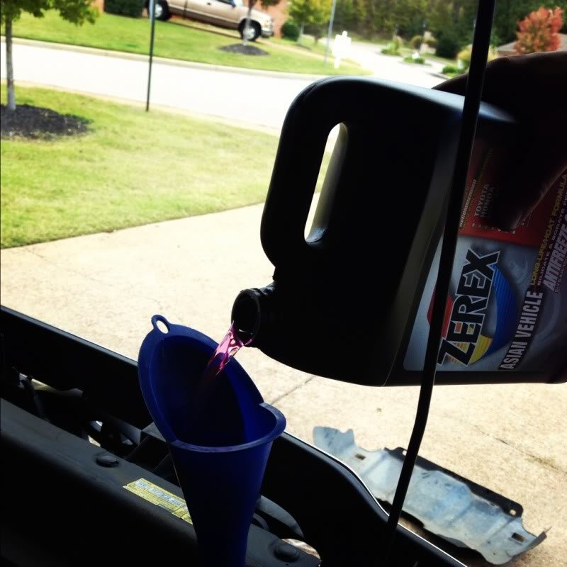

    I just performed this service yesterday. It was really pretty easy once I figured out where the engine block coolant drains were.
    Here is a link to the factory service manual page, over on the North Carolina Toyota Tacoma Off-Road Association forum: I followed the service manual instructions to a "t" and didn't have any trouble.
    The FSM states that the total coolant capacity is 10.3 US quarts. Utillizing all three drains, I was only able to drain about 8 quarts (including reservoir).
    Neither engine block coolant drain is visible from the top. To make things easier, I went ahead and removed both skid plates (I couldn't get at the radiator drain petcock without removing the front skidplate, and I took the other one off to make it easier to try to look up and see where the engine drains were). Even with the FSM showing the locations of the drains, they're still not easy to find.
    The driver's side drain is directly under the front left cylinder exhaust outlet, and the passenger side drain is directly under the rear right cylinder exhaust outlet.
    I used some 5/16" clear tubing (available at hardware stores) to run down from the drains to my pan.
    On other posts here, I saw that some guys removed the plastic wheel well cover to get at the driver's side drain. I didn't find this to be necessary. I was able to reach down from the top (the only other way to access the drain) and pop the drain hose on. Then, I used an 8" extension (10mm socket) to open the drain petcock.
    Careful, the petcock and valve are brass, and it's easy to bend, break, or round off the bolt head.
    On the passenger side, it's pretty easy to reach up from underneath the truck and pop the hose on.
    Both drain valve bolts can be reached from the topside (with a suitably long extension).

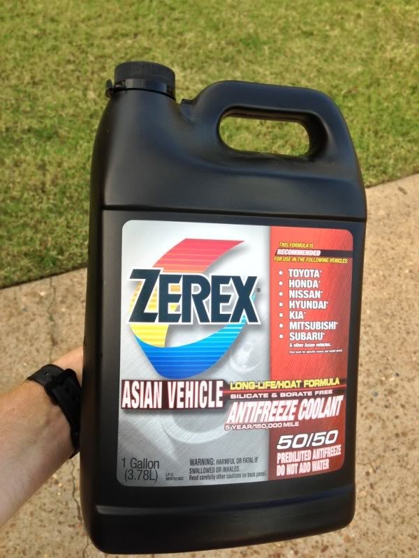

    As it says in the FSM, you will need a "non-silicate, non-amine, non-nitrate, and non-borate" coolant with long-life "hybrid organic acid" (HOAT) technology.
    Other than the factory Toyota "super long-life" coolant (pink), which is $18.50 (wholesale price) per gallon (50/50 pre-mixed), and unavailable in concentrate form, the only coolant I found locally that met this spec was the Zerex Asian Vehicle coolant. It is pink, like the Toyota SLLC stuff. I found it at NAPA for $13.49/gal. (pre-mixed). It's also not available in concentrate. Incidentally, I've heard that Valvoline/Ashland (the mfr. of Zerex Asian) is actually Toyota's coolant supplier.
    1B42DF7C-AC71-4ABE-9E81-95F26A93B660-164_4d39c145eb064112e16dda61f9aa4d54bf0b7f30.jpg
    As I understand it, the Japanese in general are averse to coolants that contain silicate especially - their philosophy is that it is hard on water pumps.
    B0DAE467-4A4D-4D65-8804-2130D7E3B450-164_d7c162e1527c53fba27832e94a6a20a11bd53b62.jpg
